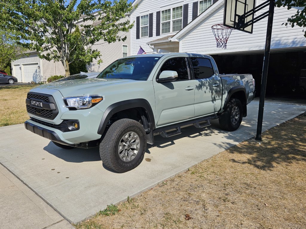

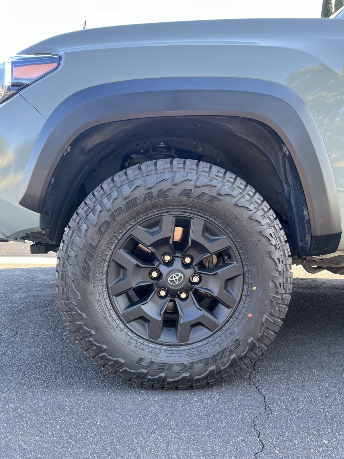

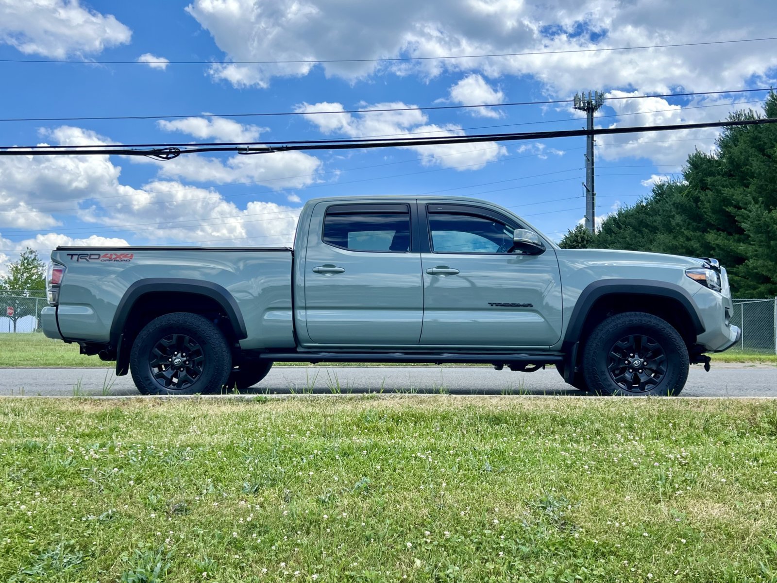

    Thanks...they have held up perfectly. No sign of any wear after two winters and plenty of car washes. Glad I did it

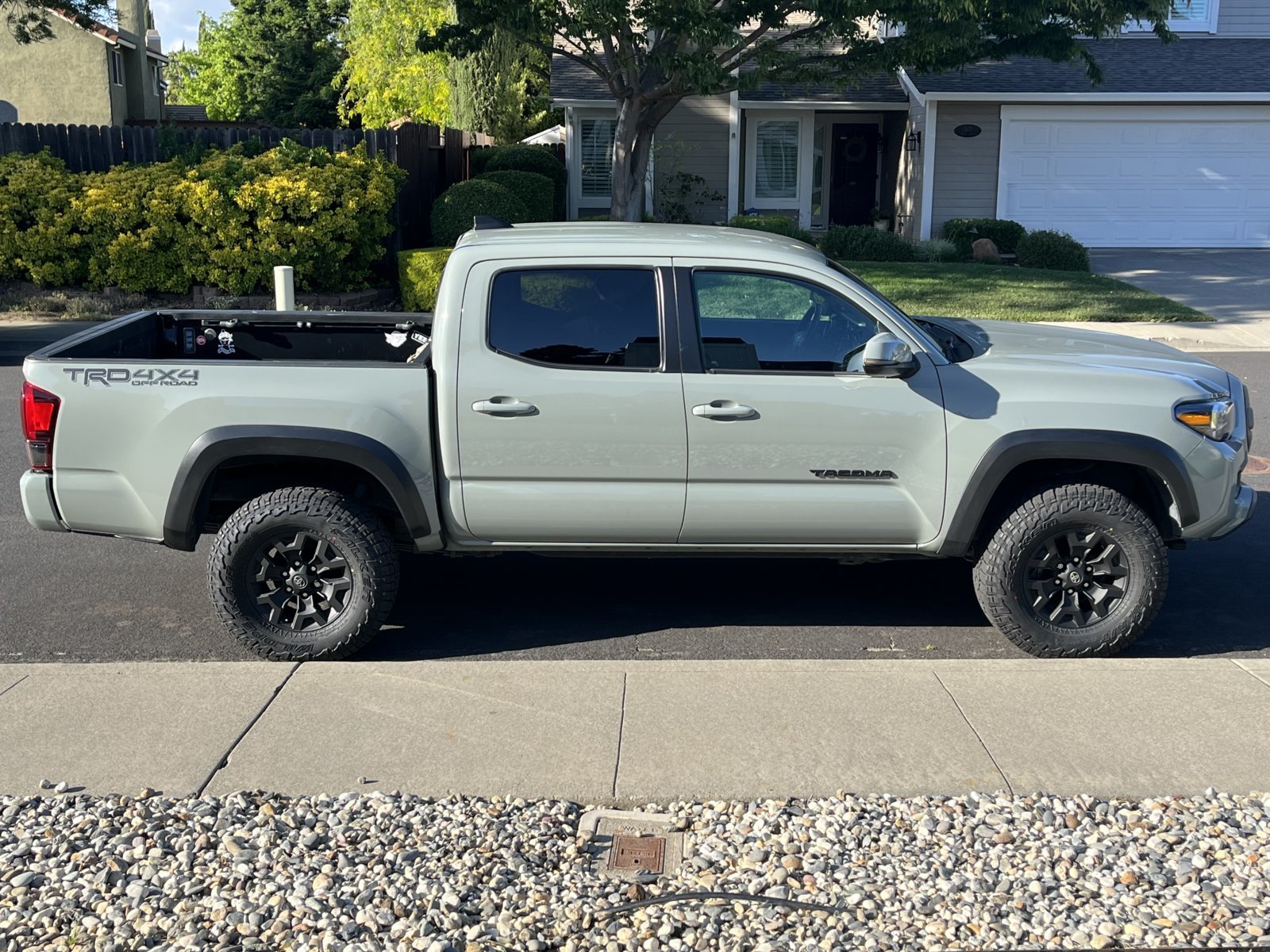

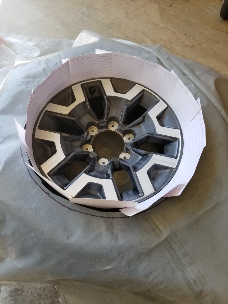

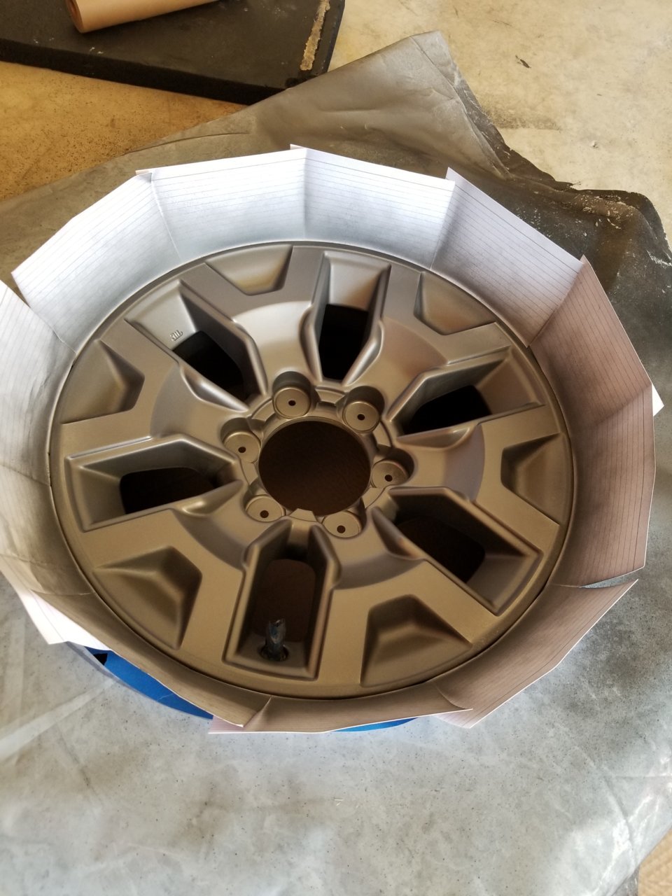

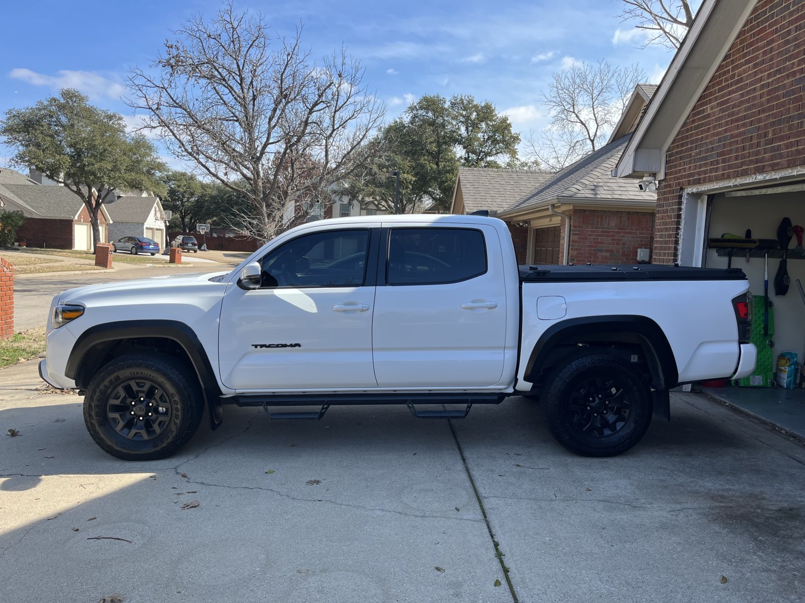

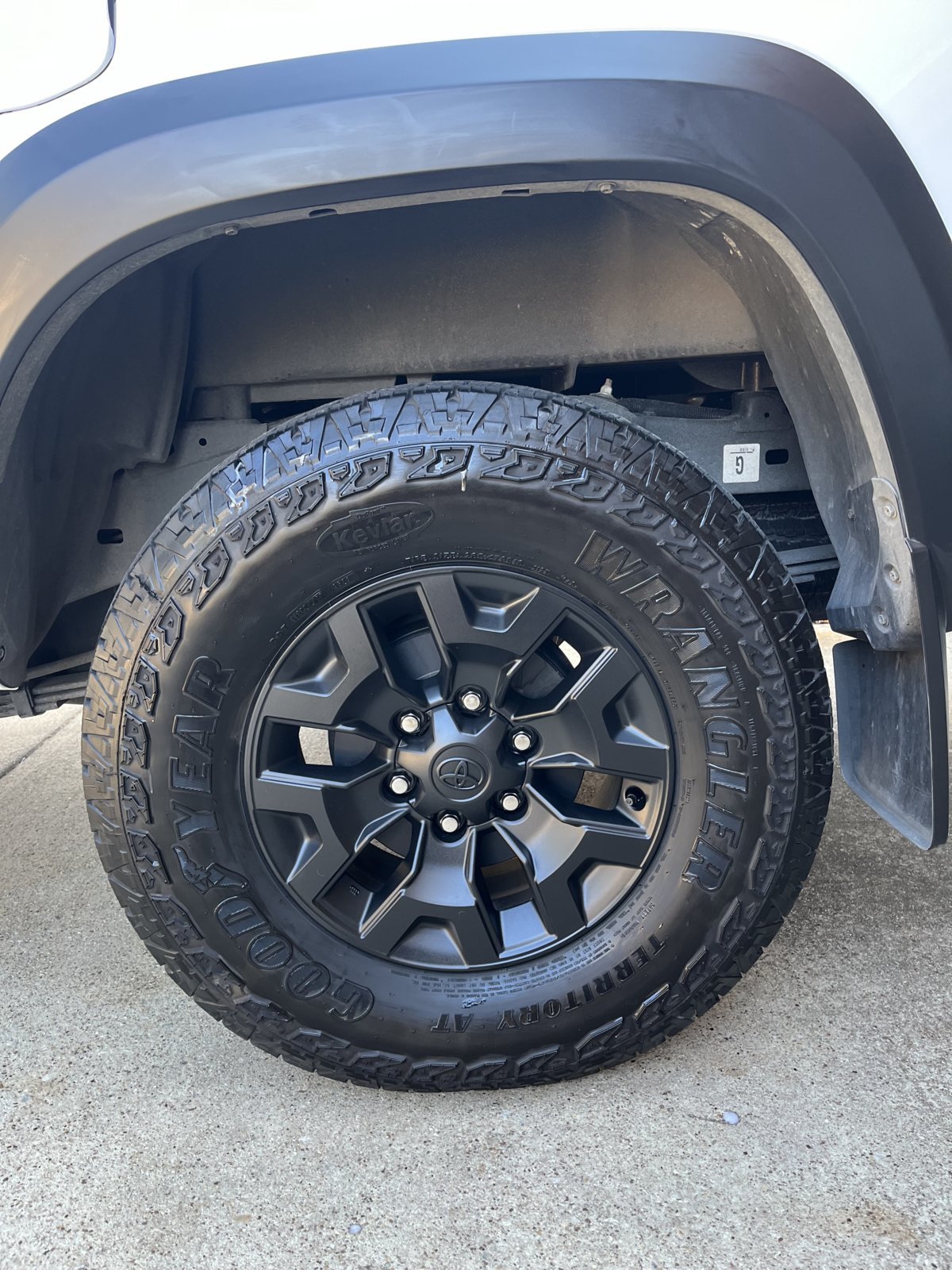

    Did mine yesterday. Took all 4 wheels off and cleaned them very thoroughly. Then I scuffed them up and wiped them down with rubbing alcohol. Final prep step was to wipe them all down with a tack cloth and put index cards in. I ended up doing like 7 coats. The first 3 were light, and 20 minutes apart. The last 4 were medium to heavy and 45 minutes apart. Probably could’ve gotten away with only 2 heavy coats, but I messed up on the last one and had some splotchy spots, so I decided to do 2 more heavy coats. I used rustoleum 2x in satin canyon black. No clear coat here for the same reasoning as OP- hopefully makes it easier to touch up and maintain. Not perfect by any means, but from 6 feet away they look sharp. I used 2 cans of spray paint, 4 scotch pads, a tack cloth, and some wheel cleaner totaling around $42. Sure beats $1000 for new wheels. Hopefully the intense prep will pay off and they last for a while.

    Looks great. You'll be happy every time you walk past them. Much better than bi-tone

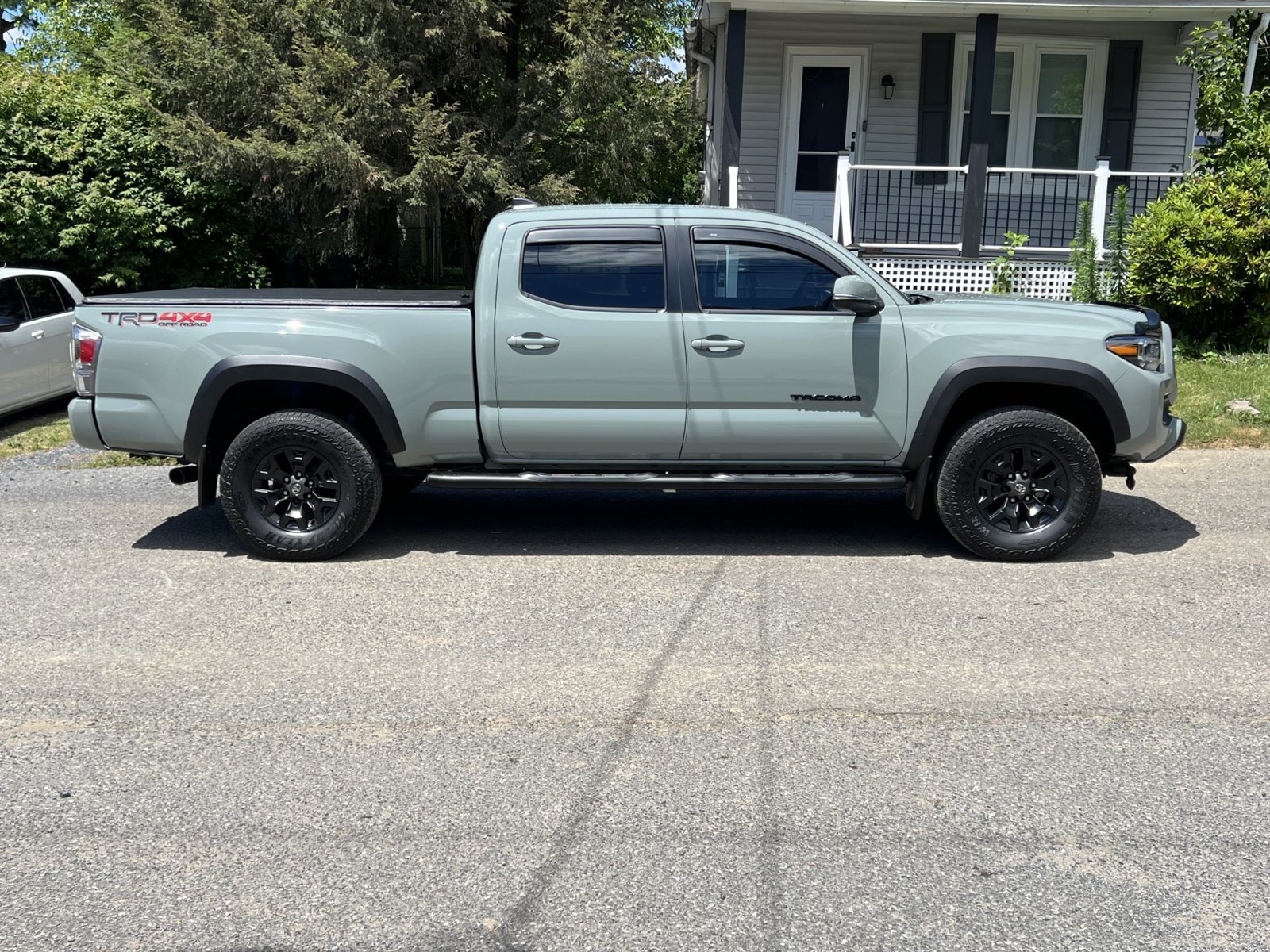

    GGFerrier
    GGFerrier Member
    Feb 20, 2016
    #178843
    5
    Geoff
    2022 Yoda color TRD OR DCSB

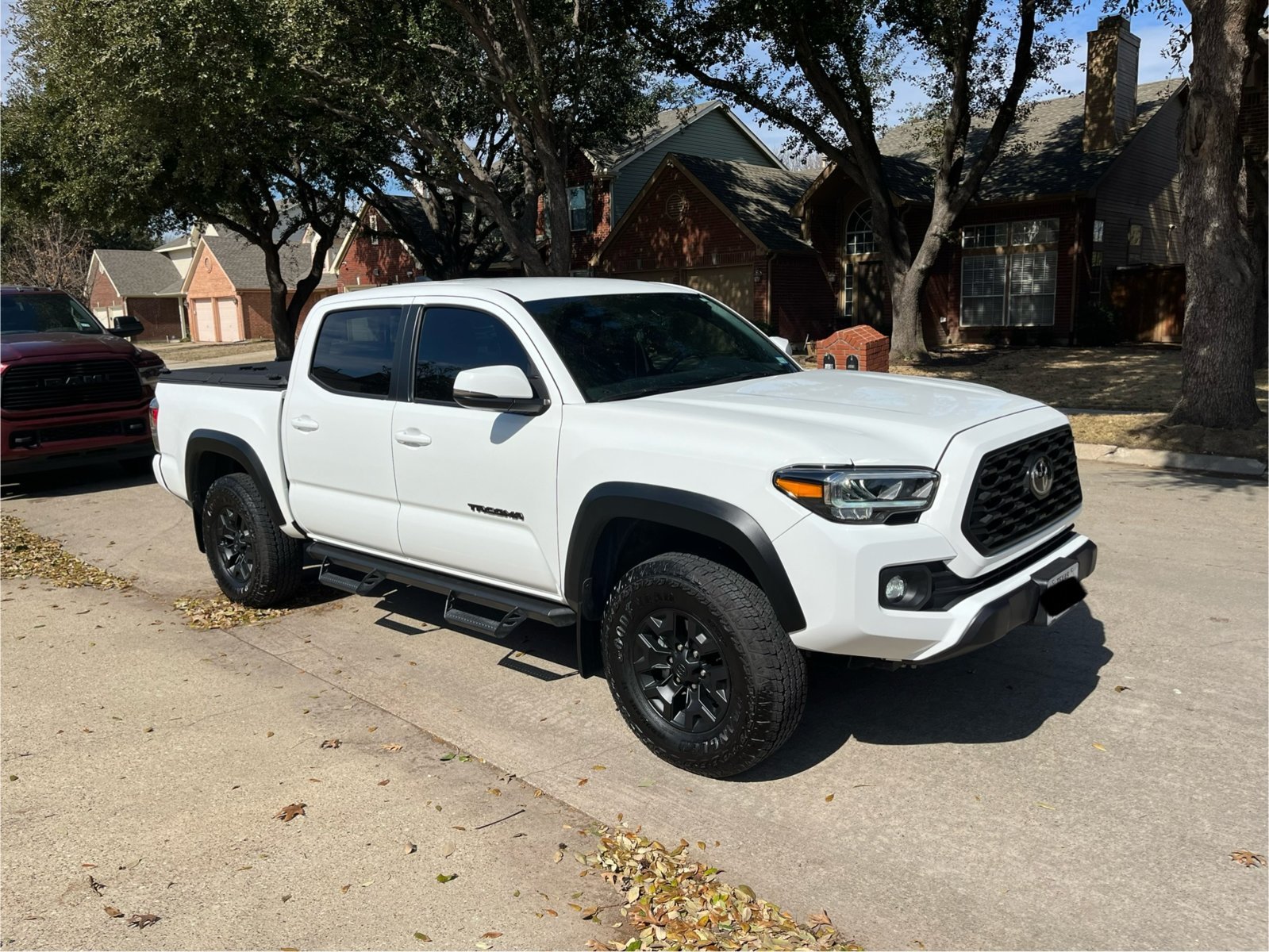

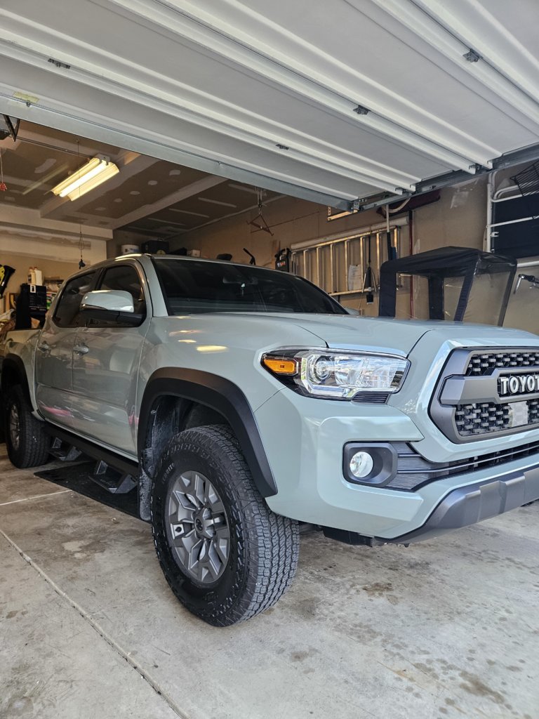

    You all motivated me and now I’ve motivated my son. Here’s mine go in flat black with lunar rock little Toyota logos.

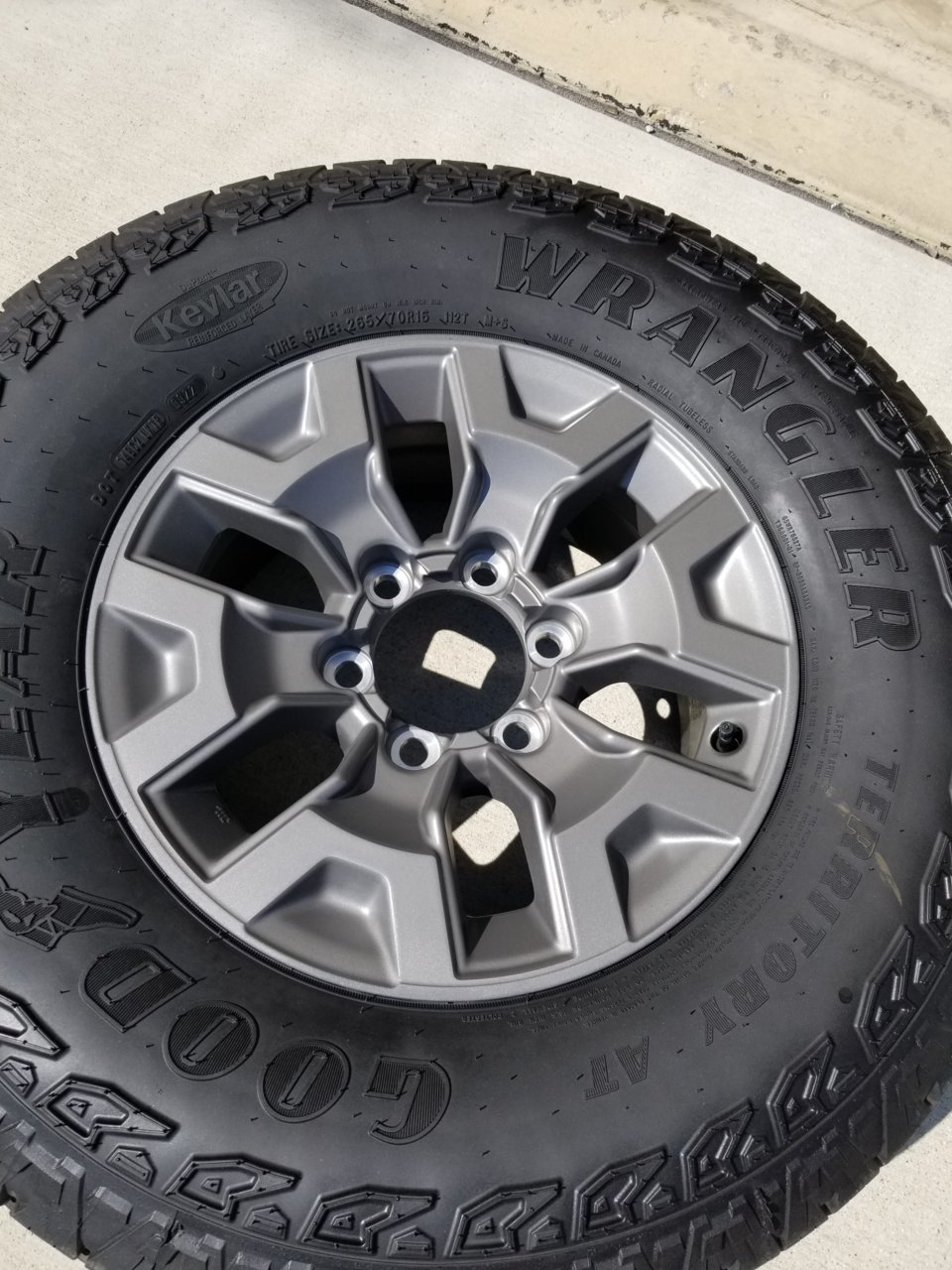

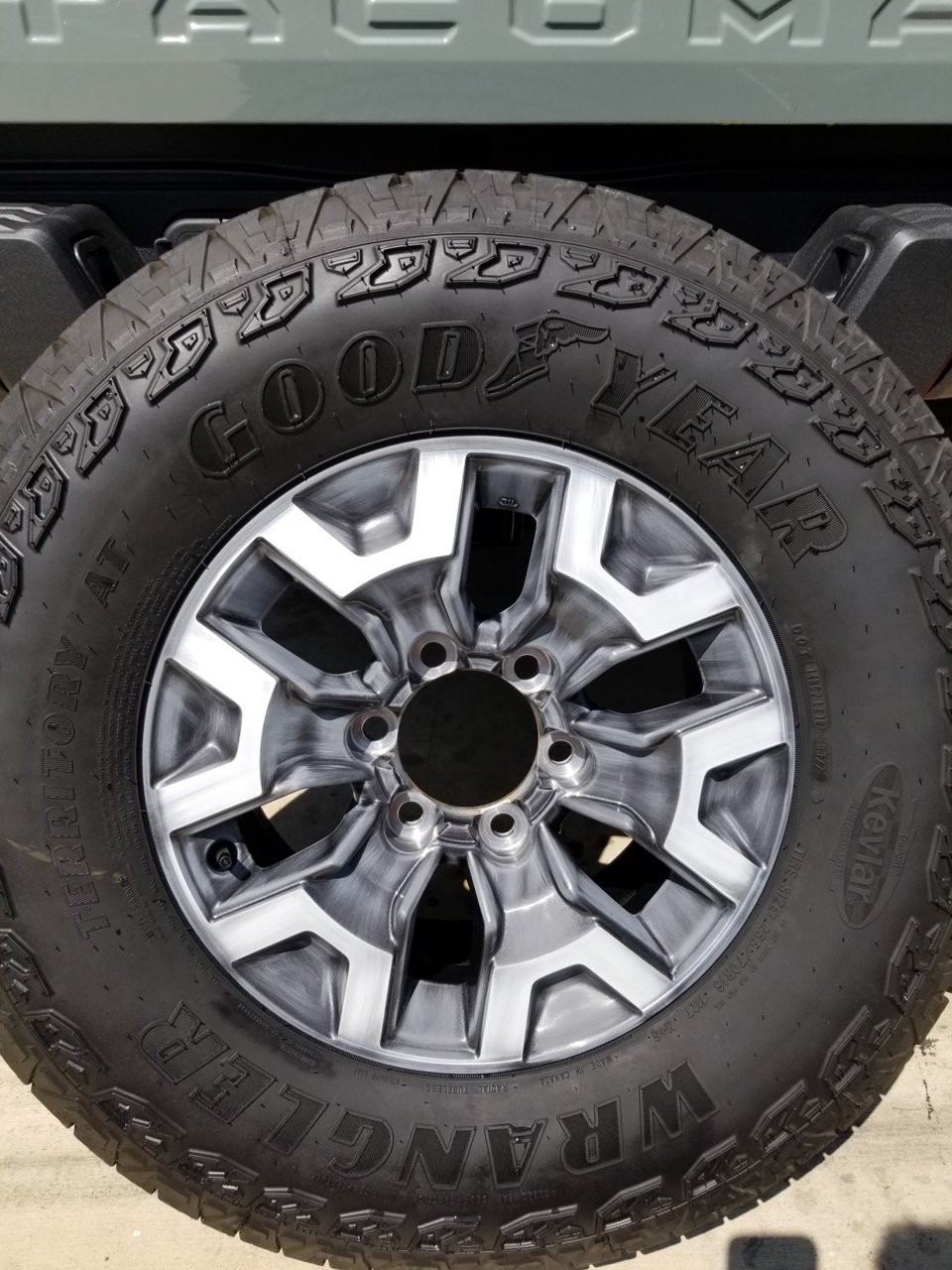

    Do you have any more pics of these on your truck? I have a set of OR wheels I've been toying with finishing in silver, but you have the only non-black/charcoal or gold/bronze set I have seen in months of looking!

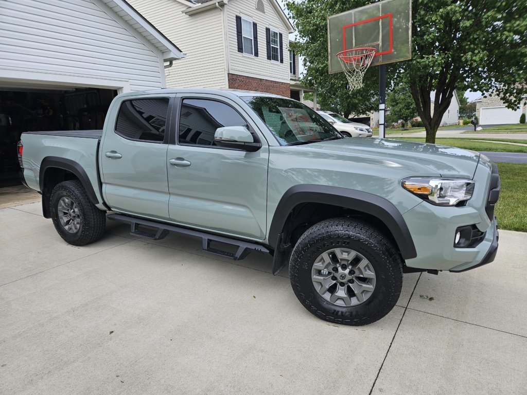

    Hansamzac
    Hansamzac Well-Known Member
    Jul 4, 2022
    #400646
    216
    Central Ohio
    2022 Tacoma TRD OR Lunar Rock
    BakFlip M4 tonneau, debadged, LED interior lights, LED bed light, Rhino mud flaps, window tint, blacked out chrome bumper, Clazzios

    moon22
    moon22 :-|
    Dec 23, 2022
    #413879
    946
    SW Mitten, for the moment..
    '12 TRD OR ACLB 6MT
    FJ AWD Swap & 3G Pro Suspension
    That looks great, thank you so much! Amazing how much styling went in to those wheels just to have it mostly covered in dark charcoal, looks completely different. Now, does it look too modern for a 2G is the question..
