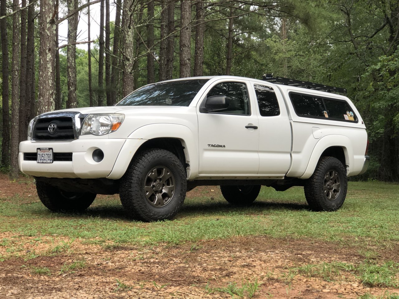

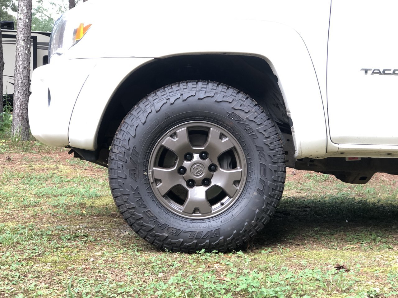

    Thanks for the very detailed walk-through. I followed this when painting my wheels. Took about 4 days worth of work as I took my time, and also fought the Georgia humidity lol. Really happy with how they turned out!

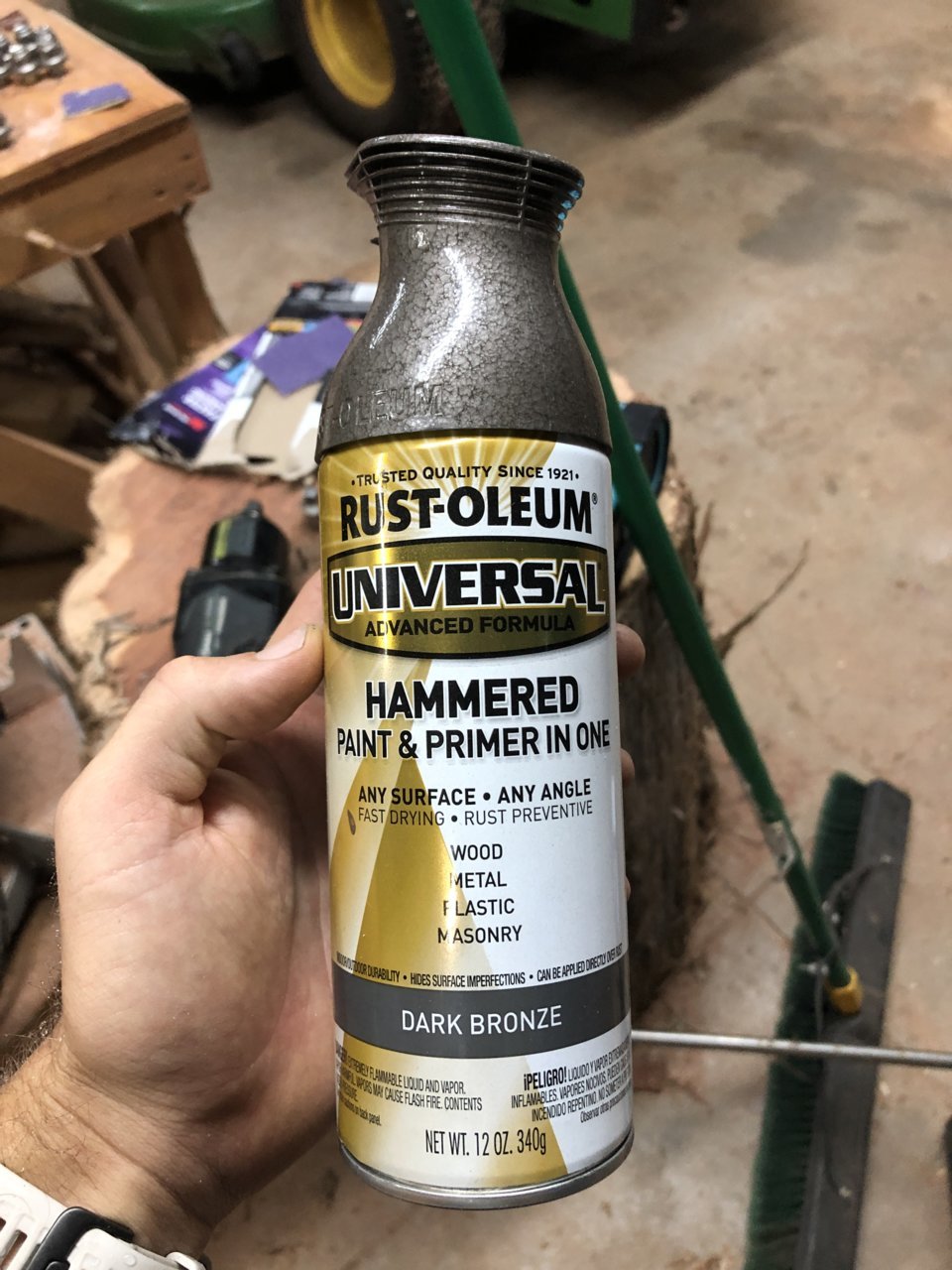

    I used Rustoleum primer & paint dark bronze.

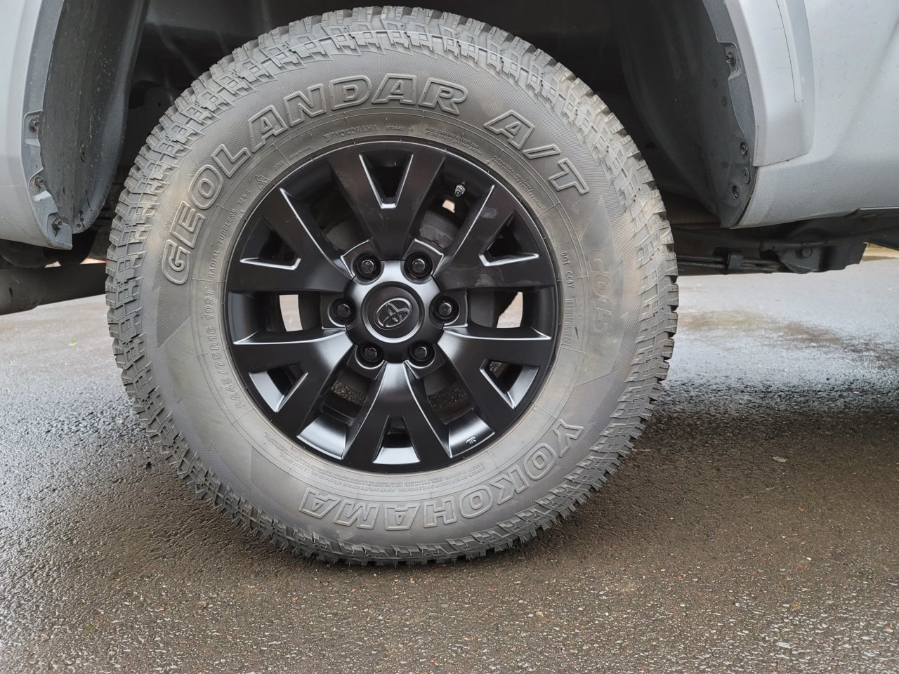

    thank you for the thread! I was able to successfully paint my wheels and I think really improve the look of my truck
    PS "skuffs" you see on the wheel are just dirt from me putting it back on

    Looks great! Is that satin black?
    sallad4x4[QUOTED] likes this.

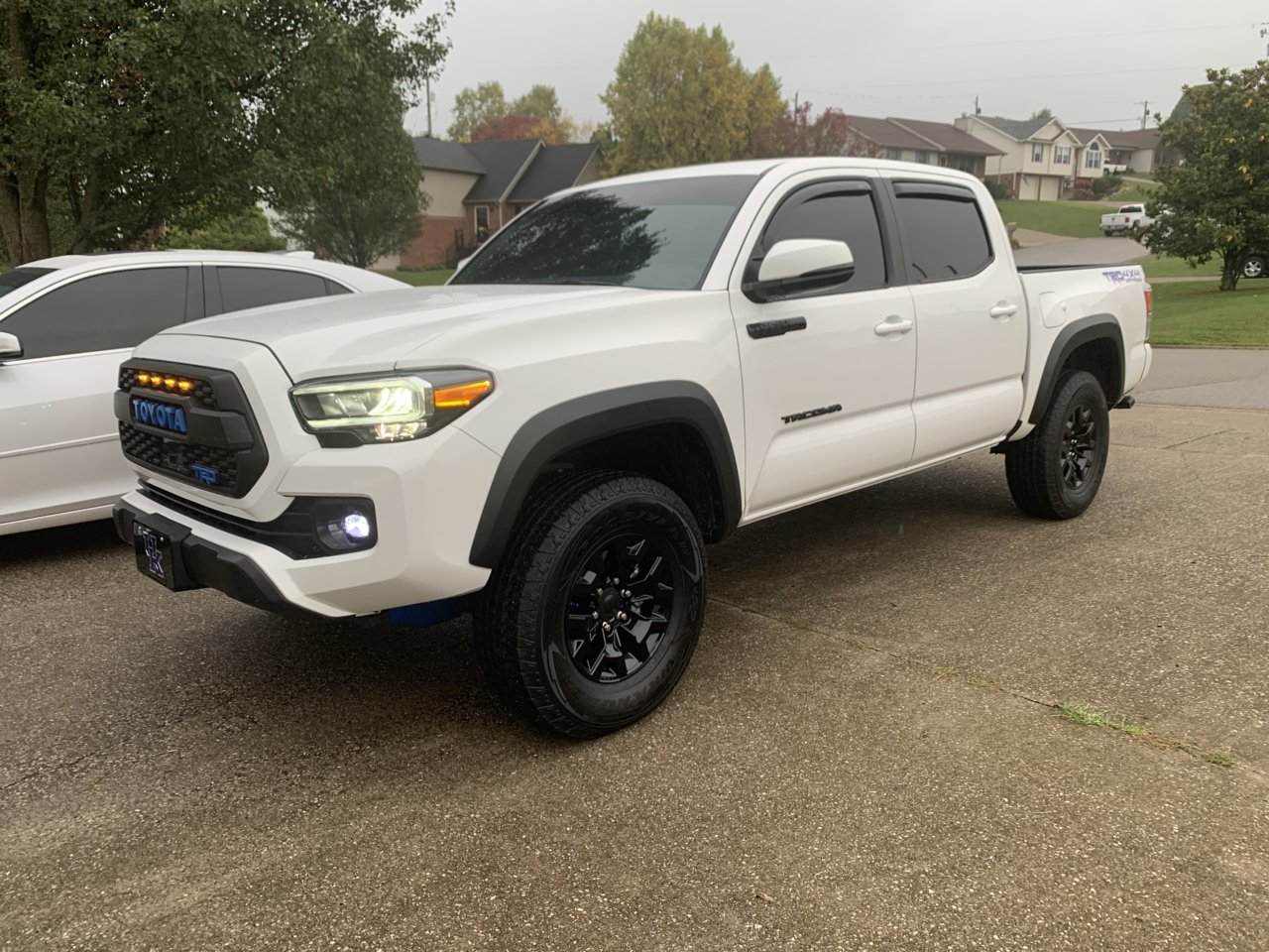

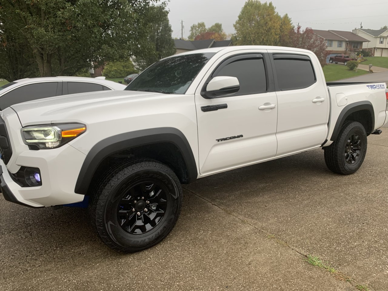

    Got around to painting my wheels this weekend. Really happy with the way they turned out. Basically got new wheels for $25. These will definitely do until I can afford some true aftermarket wheels

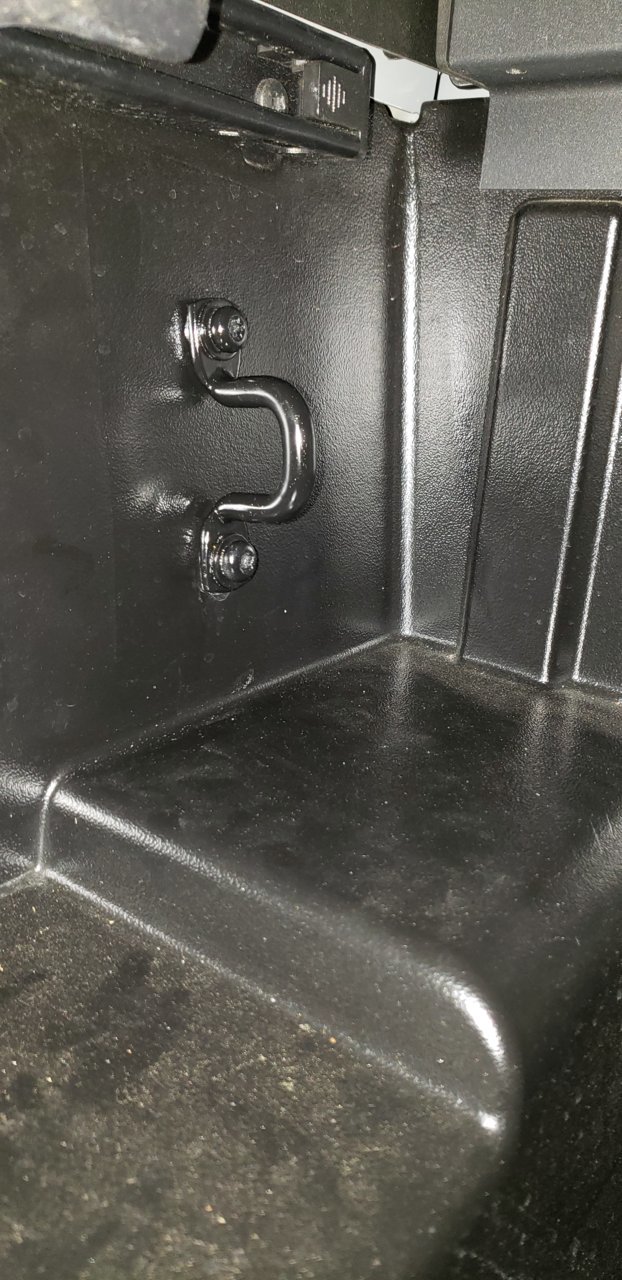

    When I did bed tie downs earlier this year, I did 3 coats of rustoleum enamel and that took a week before the paint way hard enough to install and even longer to truly harden. If you did 6 coats, it may simply take longer to fully cure. There are typically specific instructions too on recoating where if you don't hit it within an hour or two, you have to wait the full week before recoat so that everything cures appropriately.

    yup, satin black. i like it because it is a bit more subtle
