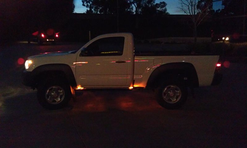

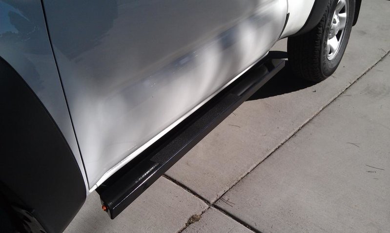

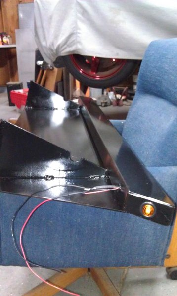

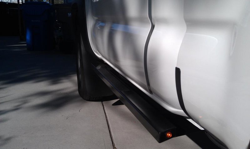

    Thought I would share pics of my project truck (2012 std. cab 4x4). The first mod was installing a leveling kit (2-3/4"). Second mod was making step sliders which I just finished/installed yesterday. I used 1/8" plate steel and 1-1/2 x 3" rectangular tubing. I was going to powder coat, but chose Rustoleum prime/paint instead as I can touch up wear/scratches easily. I angled the tube ends as shown, and installed pop-in 1" round LED amber marker lights to back light the truck. Those little LED's are much brighter than I thought! They actually light the ground under the truck. I cut 3M non-skid strips for the areas which I step on. I used a rather large rectangular frame hole for the rear mounting point (backed up the bolt on the inside of the frame with a 3x3x 1/4" plate so it wouldn't move). The front mounts were a different story; The area had no factory frame holes and was in a very bad area to drill (cross member area). I welded two 1/2" x 1" bolts as the front mounts. I installed a Curt Mfg. trailer lighting harness/tail light converter as I do tow, but tapped off the trailer plug for the running light wires which I ran down each frame rail to the front of the steps (wiring encased in convoluted plastic tubing like the factory harness uses). I orignally was going to take power from the fuse block, so I put the electrical connects off the front of the steps. If I were to do it again, I'd terminate the wiring at the rear.
