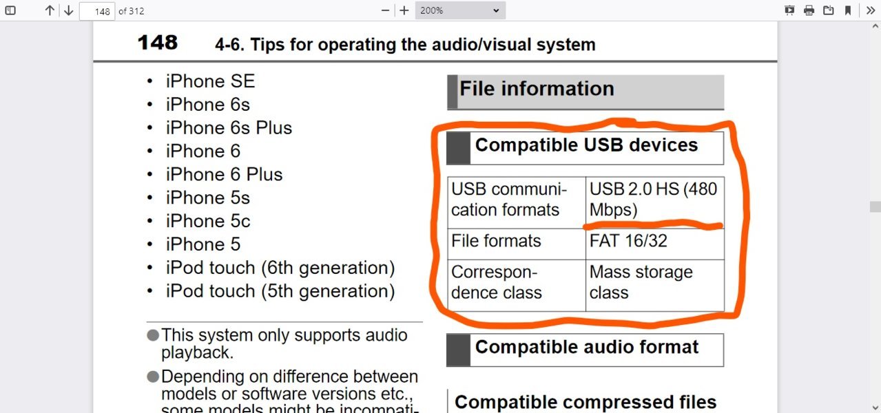

    If you go and get another usb drive, maybe get one that is usb 2.0 to see if that makes a difference; I've been using a 32GB mini memory drive for over a year with no problems.
