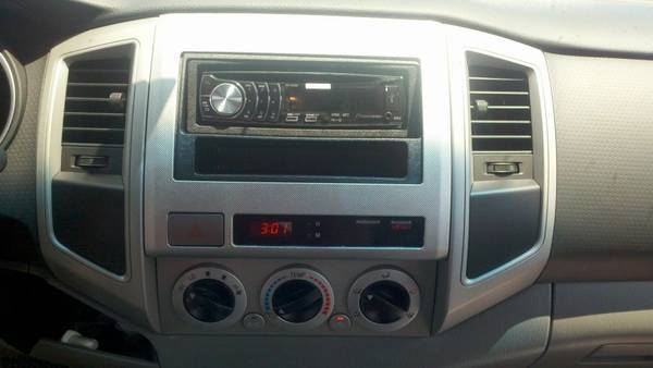

    Tow package, XM Satellite radio, K & N Air filter, & Channel Vent Visors
    This is my single. The slot underneath will hold cds.
    Crutchfield gives several things FREE with a stereo purchase. And they have good prices.

    That is a good picture. Does it look ok with the climate control panel being textured and the radio panel being just "flat silver"?

    Radio panel matches & is textured.
