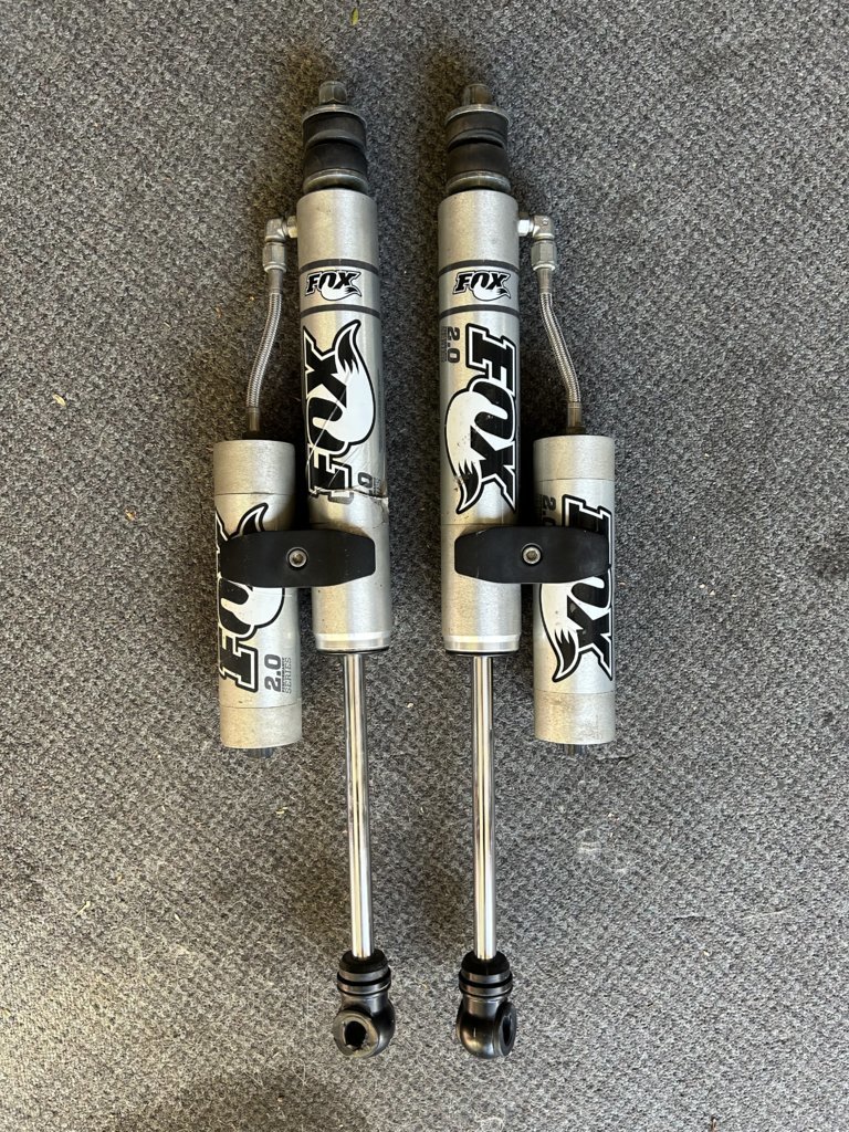

    Also picked up a free pair of Fox 9” stroke 2.0’s for 2005+ Tacomas and 4Runners — gonna make them work for my 3rd gen once I get the cash to put some longer coil springs in the rear.
    They’ll probably be 1/4” too long, but I can space the bump down and I should gain a few inches of droop, to wherever the springs become loose.

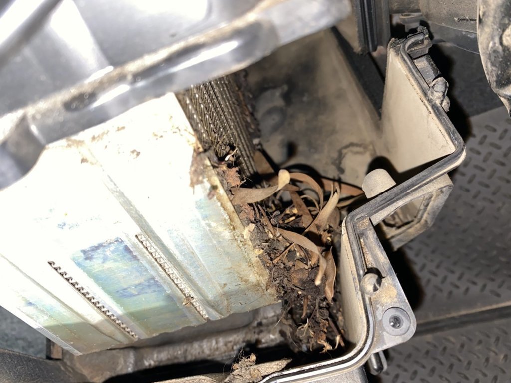

    Cleaned out the AC box with a vacuum and wipes…. Honestly pretty gross but nothing unexpected for 28 years of mountains and dirt without a filter!
    Also found a whole ass rag caught in the evaporator… don’t know when or how but it had been there a long time !IMG_5135.jpg IMG_5322.jpg

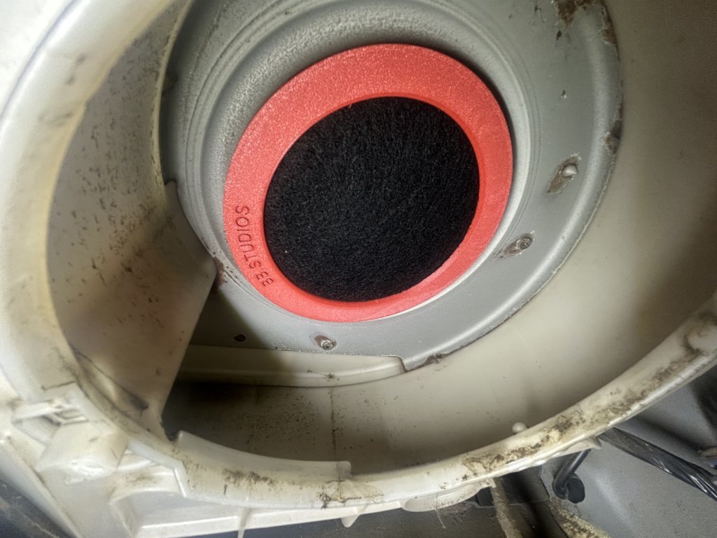

    Installed BBStudios Trail cabin air filter.
    Pricey but I wanted something nice. It fit perfect and very snug, no more anything getting in the ac system…
    I got it off of YotaNation, who seems to be the seller. Product is great, but the service I received wasn’t the best…
    Order and card was charged same day and got a generated tracking number… little over two weeks went by and I had not gotten any confirmation of a shipment from the courier despite no lead times mentioned on the site… I emailed support and got a prompt response of “sorry! We’ll get this out right away!”… another two weeks and I had no shipping confirmation still… I called my CC and said I’d like to despite charges (along with emailing YotaNation I’d be calling my CC) and then the next day tracking finally updated and it was on its way!
    Delivered 3 day later.

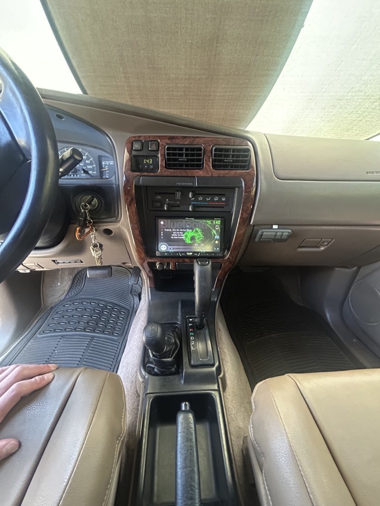

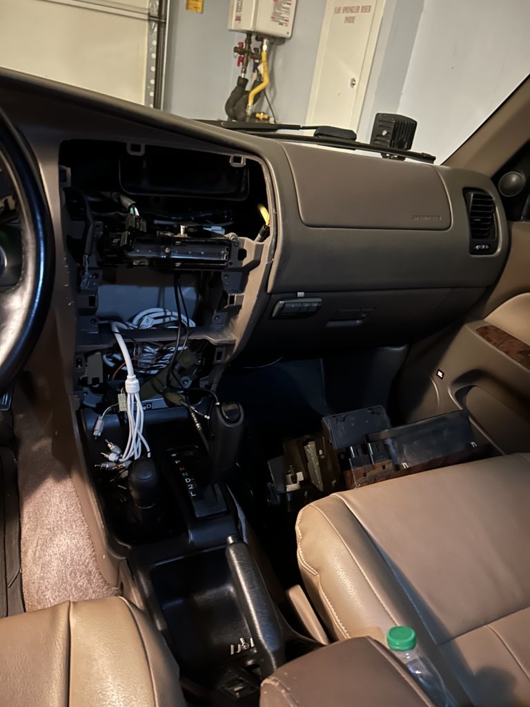

    Swapped in the old radio from my Tacoma (upgraded that to an android unit) as the kenwood that was in the 4Runner had a few issues.
    The orange / backlight circuit was shorted and would cause the whole car’s parking light/interior dash light circuit to blow the fuse. Only 3 out of the 6 RCA outputs worked so I’d been jumping sounds with splitters. CD player would swallow disks.
    No volume knob which is kinda a pain, but it fully works, and has a cool tilt-able feature that makes it nice for the low mounted slot in the 4Runner.
