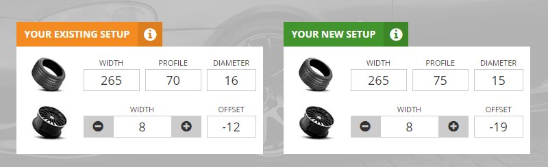

    This might help

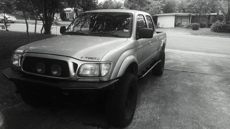

    thanks for the replies. picture of truck looks pretty dead even to me any other angles more straight on so can se more it actually sticking out.
    As long as all the threads are tucked under the flare should work perfect if the tire "bulge" is sticking past the flares thats fine.

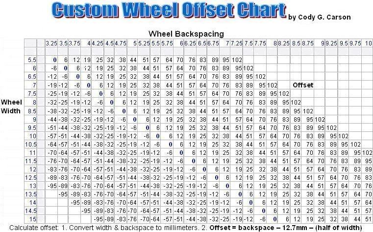

    the chart looks good but i have a hard time understanding what it is telling me.
    I assume its saying that with a 8" wide rim it will have the same "stance" weather you have 0mm offset (4.5" BS) -12mm offset (4.0"BS) or -19mm offset (3.75"BS)? if not how do i read that chart? what is it supposed to be telling/showing me.

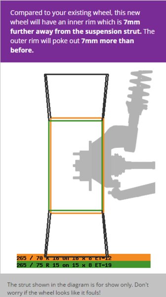

    Ignore the tire size but to compare the two wheels look at this-
    Diameter doesn't matter. Both wheels are the same width. The change in 7mm of offset pushes the wheel out an additional 7mm.
    16"x8" with 4.0" of backspacing = -12mm offset
    15"x8" with 3.75" of backspacing = -19mm offset
    That's a difference of .25" (7mm) where the 15x8 -19mm offset (3.75" back spacing) wheel sticks out a little more than the 16x8 -12mm offset (4.0" back spacing)
    edit: that Amazon link showing 16"x8" 0mm offset and 4.0" back spacing is a typo. It's either 4.5" backspacing with 0mm offset OR -12mm offset to achieve 4.0" back spacing

    that answered all questions thank you very much.
    thanks to everyone else for chiming in also

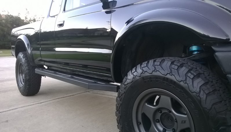

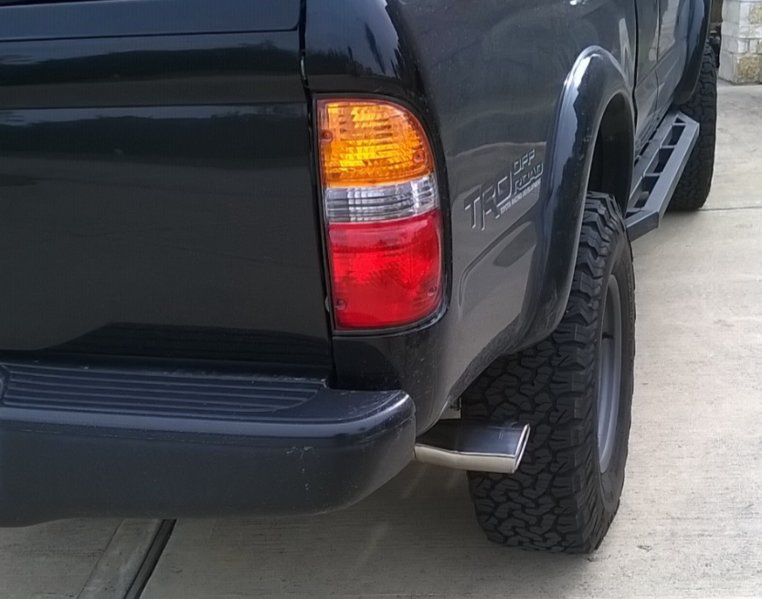

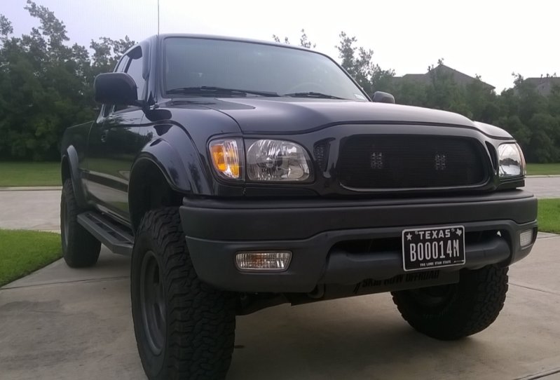

    Not sure this helps, but my set up is right to the fender. SCS wheel, 265/75/16, 4.5 BS 3.5 BS is past the fender by a good bit. Best pics down the sides I can find.
    SCSPerformance likes this.
