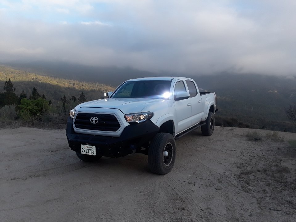

    Spindles are a 4inch lift.
    I had a set on my truck, with icons preloaded 650lb springs. It rode like crap until I added a giant front bumper to it. Only problem with comparison is, all this is on a 3rd gen.
