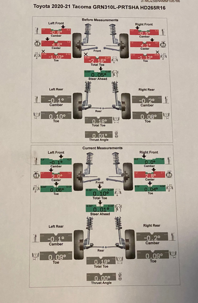

    Looking for some help/advice.
    About 6 weeks ago I installed new front suspension on my truck: King 2.5 Extended travel coilovers, @TOTAL CHAOS Upper Control Arms, Stock Length Expedition Series Lower Control Arms plus Gusseted Spindles. Truck had 3k miles when everything was installed.
    After my alignment, the steering felt stiff to turn away from center. Essentially you have to manually bring the wheel back after turning - it won't center itself.
    I realize that the uniballs in the UCAs and LCAs will take time to break in, but its been ~1700 miles since everything was installed and it doesn't seem to be getting any better.
    Any thoughts or suggestions?
  2. Jun 10, 2021 at 6:29 PM
    su.b.rat
    su.b.rat broken truck
    Jul 30, 2016
    #193316
    9,874
    my front end is fully reinforced with all similar stuff. my steering is as you describe, but it does self-center when moving, but not at all like stock. and I'm on 265/70-17 E range. i really like it like this myself. your alignment is fine. what tires and pressures do you run?
