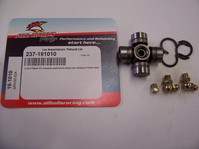

    Soooooo I dug around the inter webs and found a ATV u joint that fits it. If you need it let me know and I will dig it up
    Cost about $40 and it’s greasable

    part number for the ATV joint?

    @knottyrope
    This is what I came up with
    Full disclaimer, Toyota told me I needed a shaft when they were doing the frame on my 07 $600 Canadian, can get it rebuilt at few places for $150, buy new aftermarket for about the same.
    My 07 is a budget build that you should check out, link in my signature (shameless plug) I wanted to rebuild myself did a bunch of research and was told that this all balls kit fit, ordered it, ready to rebuild and Toyota dealer said it was good and did not need one.

    So you didn't install the All Balls u joint? It would be nice to know if this works or not. I was under the impression that the shaft was not rebuildable.

    No as the dealer said it was ok and did not need replacing at time of frame change. BUT I have a used one coming that needs a rebuild and I have the all balls kit, so I will be giving this a try :)
