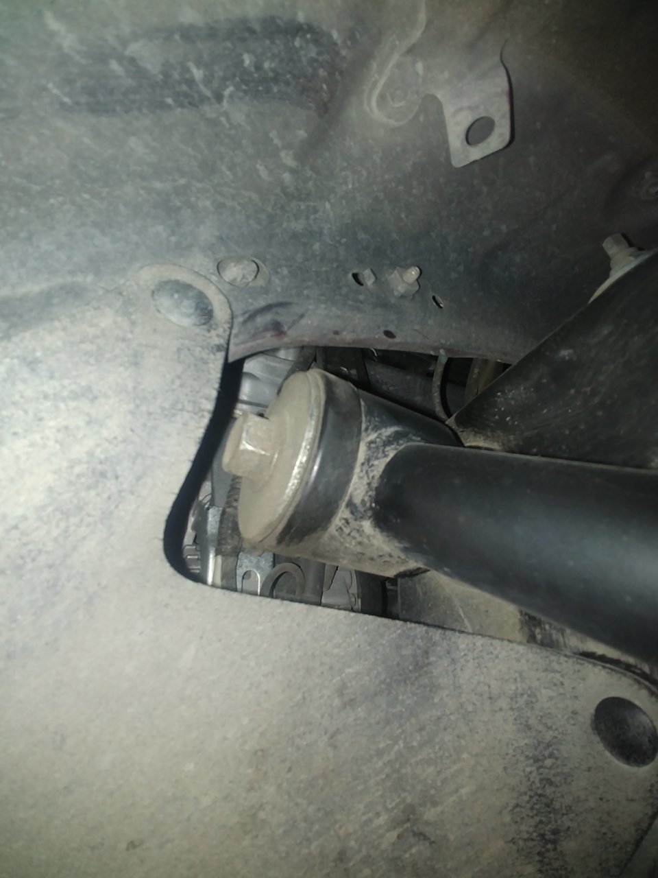

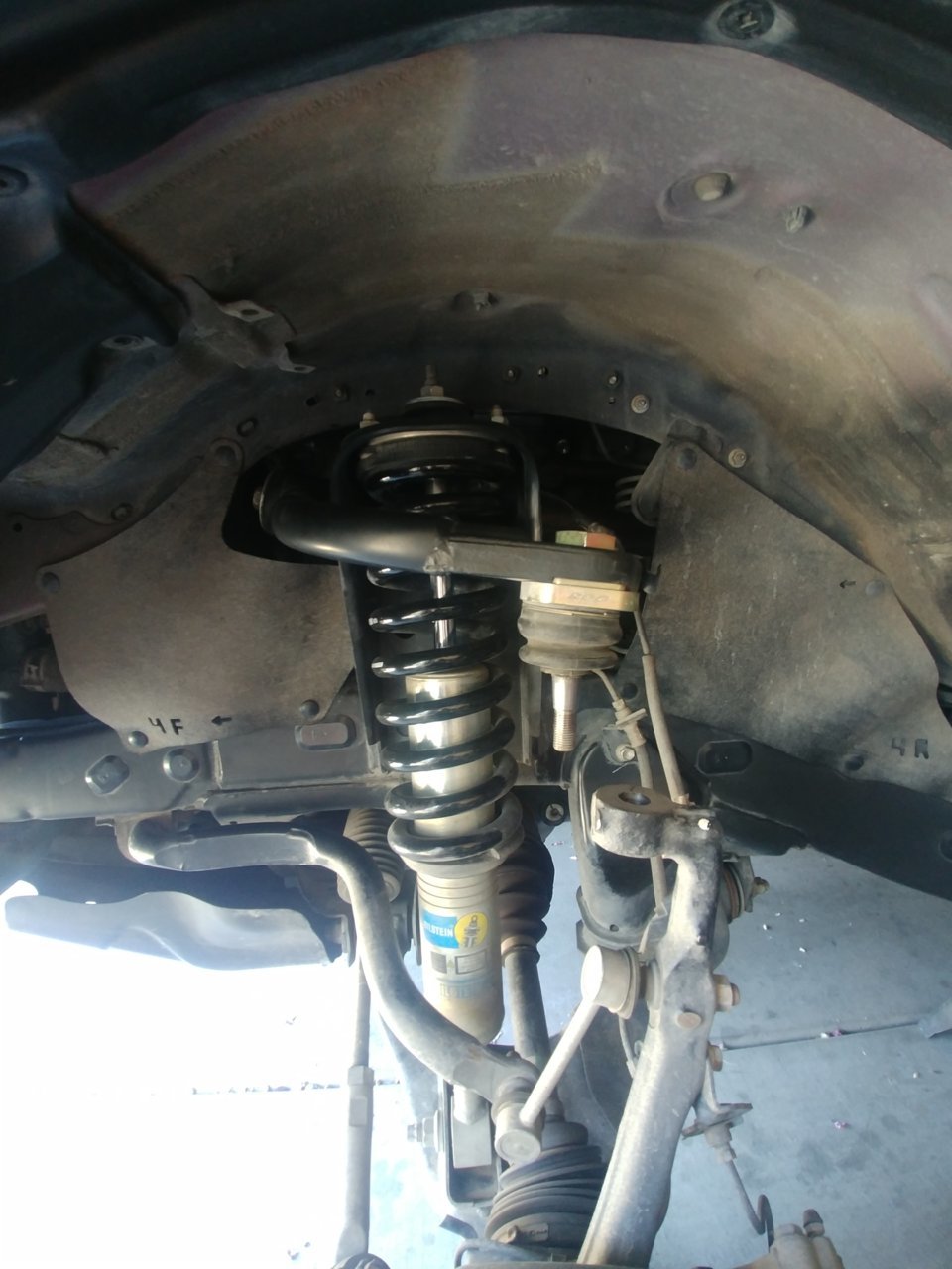

    I've noticed a popping noise from the front end lately. Thought it was a ball joint, but after removing ball joint, seems like my uca is very stiff. I would think it should drop freely. These LR UCA have no grease zerks. Replace bushings or replace UCA's? In picture UCA is up, I have apply quite a bit of pressure pull it down.

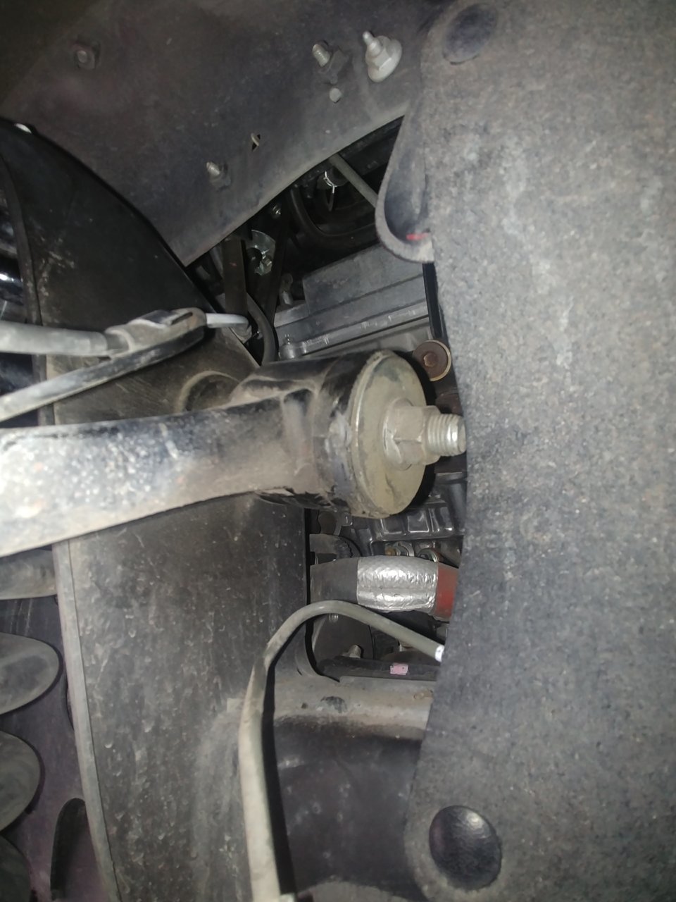

    Take a pic of the mounting bushing on the Uca. The first gen spc Uca had problems binding and breaking at the weld. I had a set do it

    Welds look good. No cracks.

    I don't see any rubbing.

    Those are not the first gen UCAs. They had washers on both sides. You should be good there

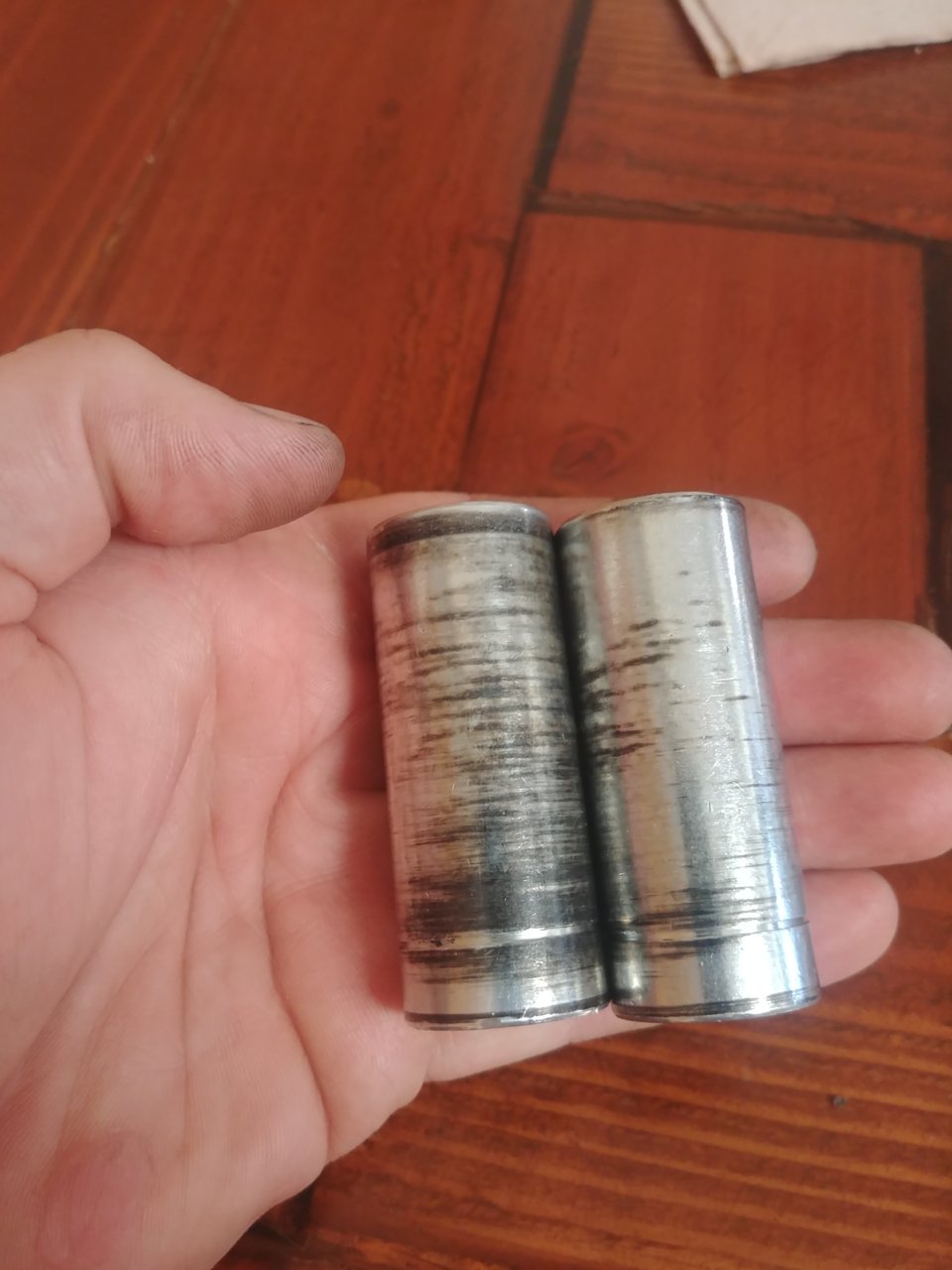

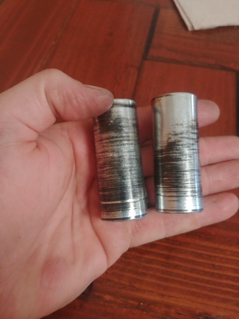

    Just finished replacing UCA bushings and happy to report popping/binding noise is gone. While driving forward/reverse and shaking truck side to side, front end is no longer popping. I did notice the center steel pivot sleeves did have quite a bit of burnt rubber/grease that I was unable to wash away. (Photo). I'm guessing that is where they were binding up. Thanks @HeadStrong Off-Road for shipping those out so quickly.20180527_145719.jpg 20180527_145711.jpg

    yeah the older style free floating bushings get clamped pretty good so it smushes the bushings out into the sleeve. Ill grease mine every other year. My old swaybar bushings make more noise though so im not worried.
