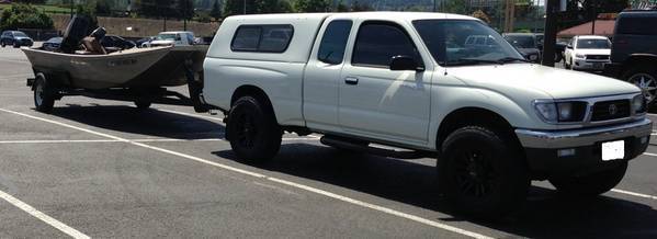

    I bought a boat a few years back because I was in the right place at the right time and it was the right price. The problem is that I didn't have a way to tow it until about a year ago. I'd just borrow family/friend's vehicles to get it down to the water and then pay to moor it. Rates started going up every year until finally it was financially unfeasible to do that, so the boat's been sitting by the driveway for the last 2 years.
    At my work we had a contractor whose contract was expiring and he decided to move his family back to Australia. Well low and behold, another right place at the right time moment. He couldn't exactly drive his Taco there and it was cost prohibitive to ship it, so score another one for me! He kept it in immaculate condition and it only had 124K miles on it. Knowing he hadn't had the timing belt/water pump done, I negotiated him down to $6500.
    It's a 1997 v6 3.4L 4x4 LX - plenty of power to pull my little boat and haul whatever else I need. It's not the most economical vehicle to drive, but as a second/fun ride, it's perfect.
    The first thing I did was have all of the maintenance done on it. I'm not a "car guy", so most everything that needed done was way beyond me. A friend hooked me up with a certified Toyo tech that works on stuff on his own time for cheaper rates. He went through everything and I'm now confident that with basic maintenance, it'll last for many more years.
    I've had my Taco a year now. The previous owner kept it mostly stock, so it was time to make it "mine", and learn more about my truck.

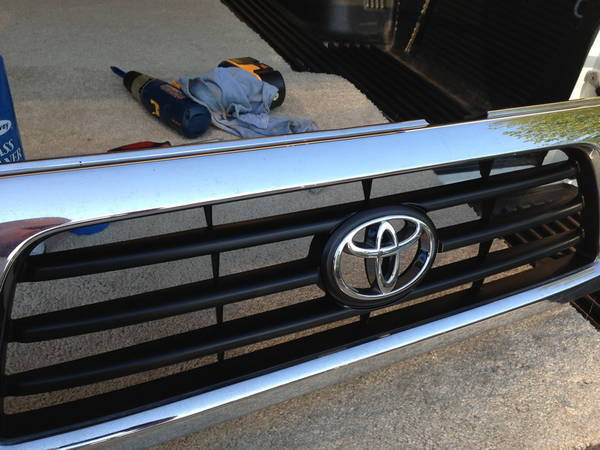

    • Repainted the faded grill flat black - $5

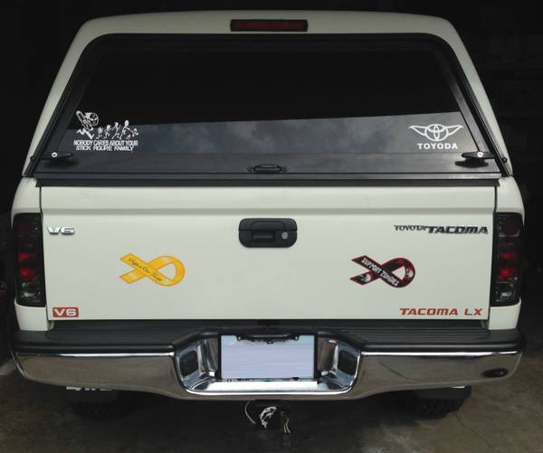

    Rear End
    • Repainted the canopy rear trim flat black - $5
    Spyder smoke tail lights - $85
    Replaced the flakey Toyo tail light conversion box so trailer lights work again - $25
    • Discovered the canopy brake light never worked - the wires were clipped and taped off behind the tail light for some reason. Fixed - $2
    Pop & Lock locking tailgate handle - $50
    • Stickers and extra badges on the back end just because - $30

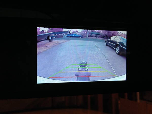

    License plate frame backup camera
    Clip on rearview mirror with backup LCD display

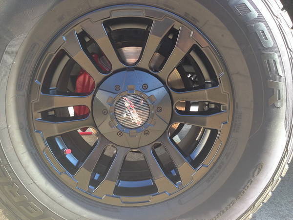

    Tires/Wheels

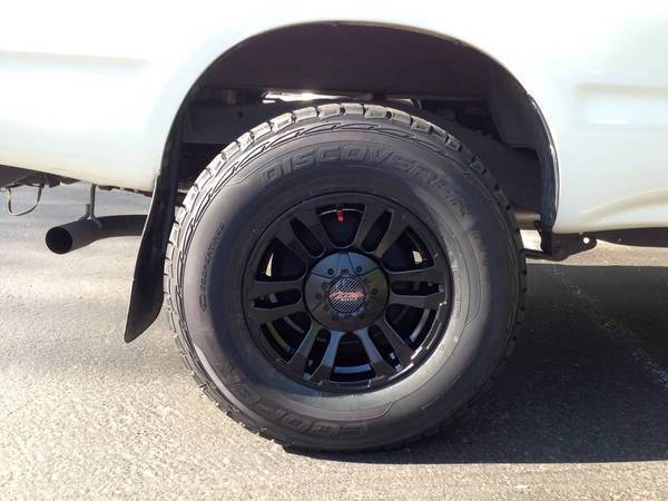

    • 16" TKO wheels by MB Wheels through America's Tire (red accent logo and valve stem covers!) - $600
    265/75R16 Cooper Discoverer ATP Tires through America's Tire - $500
    • Pinch weld mod to alleviate rubbing from the bigger tires - $0 (Can of undercoat spray $5)

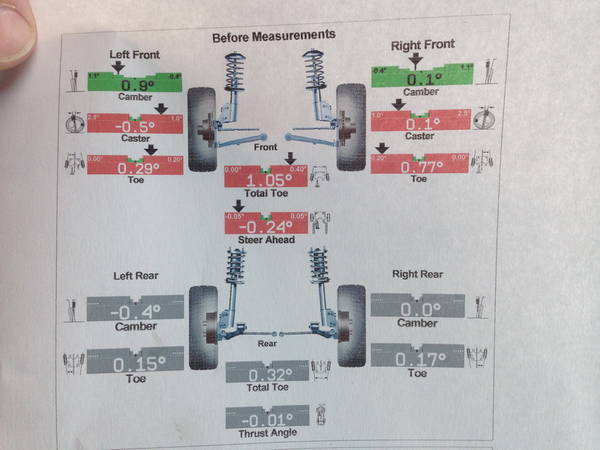

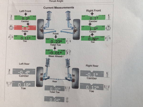

    • Firestone Lifetime alignment ($170) revealed the back end was bent. $300 at a frame shop to fix.

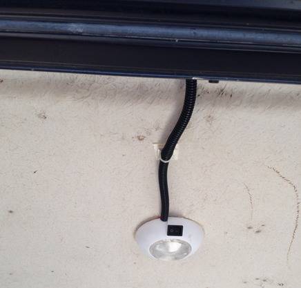

    • Added 12v inside canopy light with quick disconnect - $25

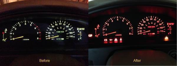

    • Instrument cluster LED mod - $50

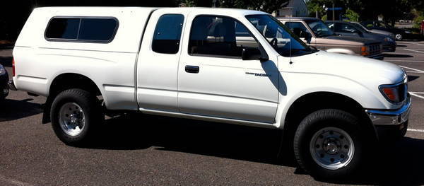

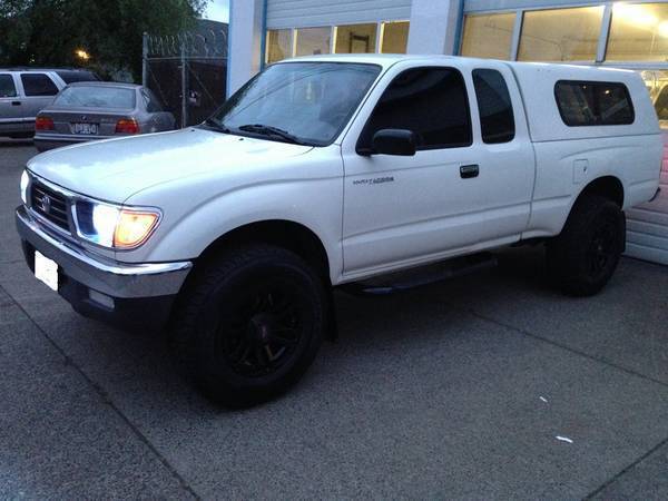

    Current look (better picture forthcoming):

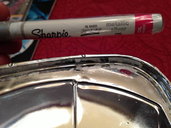

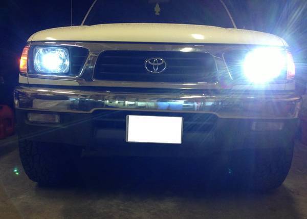

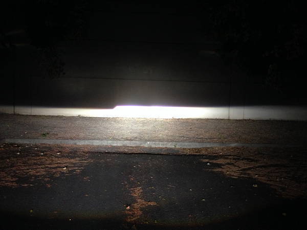

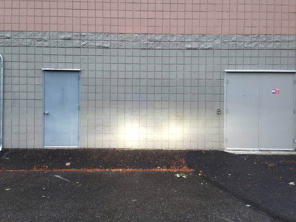

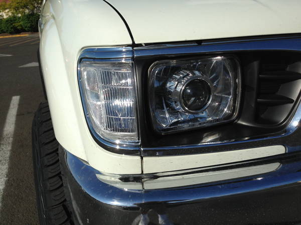

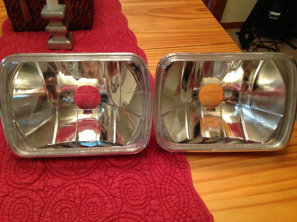

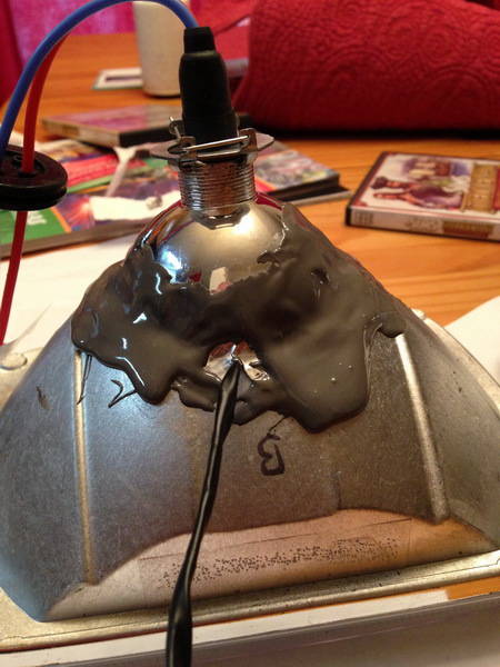

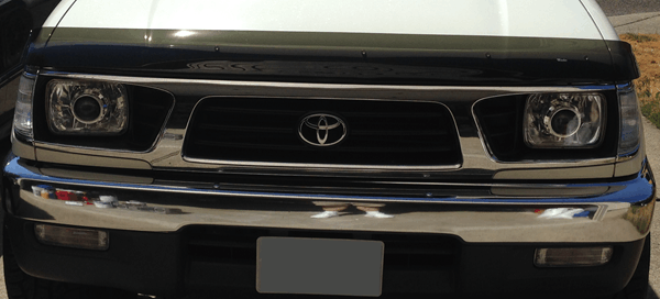

    I used these Pilot 7x6 housings.
    And the Miromoto H1 6000K kit from TRS plus their butyl sealing glue. Use the H4/9003 wiring harness.
    eBay one of these for $5: H4 HID Bi-xenon Error Warning Canceller Leakage Module and plug it into the unused factory harness on the passenger side when done. That will create a load and allow your high beam console indicator to work again. Mine arrived yesterday. Plugged it in and voila'.
    You also need some JB Weld.
    Other than that, all you need are your oven, Dremel tool with cutoff wheels and cutting bit, and safety glasses. And do the cutting/grinding in the garage or outside. Really messy fine plastic particles are created.
    Note that the projector appears to be sagging a bit. It was. I managed to catch and correct that before the JB Weld set all the way. Use a little bit of metal tape (high heat for water heater use) to secure the projector to the housings. JB weld right over the top of it. Allow it to set up for 30 minutes or so, then go test fit them in your truck. See if your cutoff lines are even in the ballpark. One of mine wasn't, that's how I discovered how severe it had sagged. You should be able to gently move the projector close to where it needs to be. Carefully take them back out and set them so they won't move any further and let cure another couple hours. Then before re-sealing, wipe down all inside pieces (including the lens and inside of the cover) with the alcohol wipes to remove all fingerprints and particles.
    JB Weld is more runny than I expected. A little bit got inside the housing where I didn't have it sealed all the way. You can only see it if you look for it though. Also got some on the wiring when I was test fitting, and apparently a drop on the bumper. Oops. So just be mindful and careful.

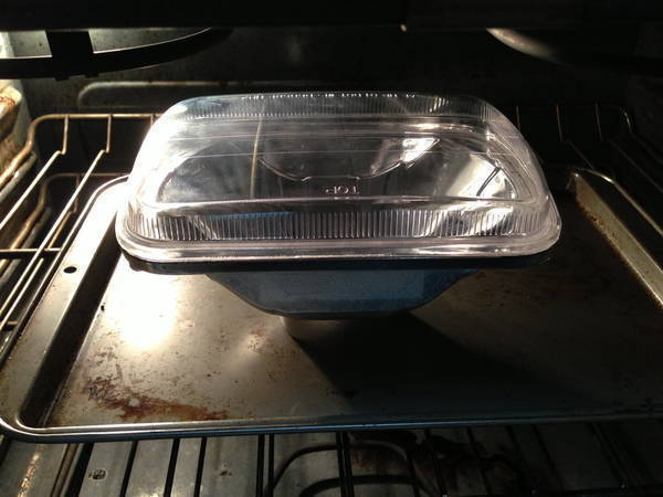

    Pilot housings before:
    Heating in the oven:
    Gently prying the two halves apart
    After prying the covers off, remove the existing glue while it's still warm and pliable. I worked on it when it was cooler, should have reheated it. When I removed the glue, some of the chrome was pulled off. I touched it up with a sharpie just to be sure black didn't show through. If I had blacked out the headlights, this wouldn't be an issue.
    I got impatient here and was in the "zone" of cutting, so I neglected to take any more in-process pictures as intended. Oops.
    Also note in this picture that one of the retaining clip holders is bent a little. I should have corrected that with a pair of pliers so it's seated all the way. I'll do that at some point when I feel like pulling the front end apart again.

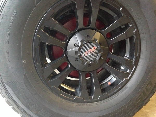

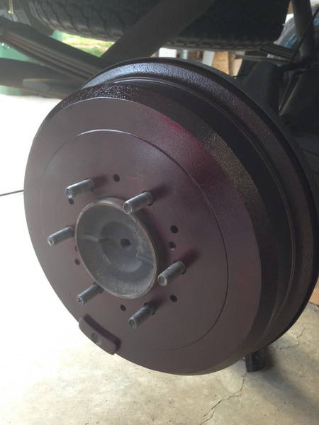

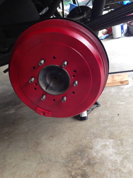

    Removed, cleaned with a wire wheel, and painted my brake drums. I found a metallic red that matches my wheel logos and valve stem caps. It looks cool...on the rattle can lid.
    Things learned:
    1. My tires are really heavy. Much more than I was expecting.
    2. The paint color I chose barely shows up on the drum dark base color. Should have gone with a better color or maybe a lighter primer first. Fail. :(
    3. I was shorted a security lug nut on the rear passenger side when I got my new wheels/tires. Couldn't tell because the center cap was covering it. 5/6 lugs is Not Right, so I'll be going back to them today.

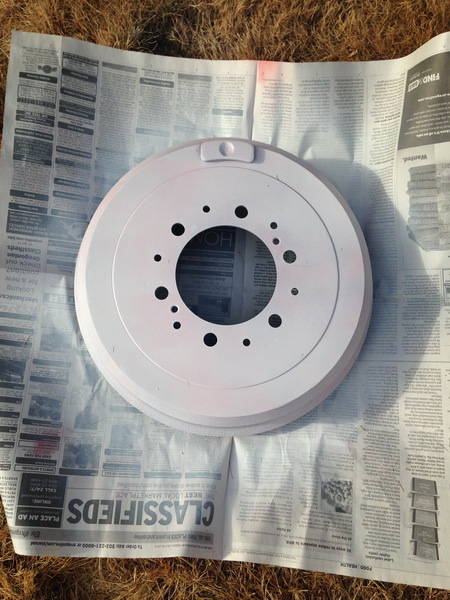

    Primer. Fixing...
    Same color red. Fixing...
    Fixed.

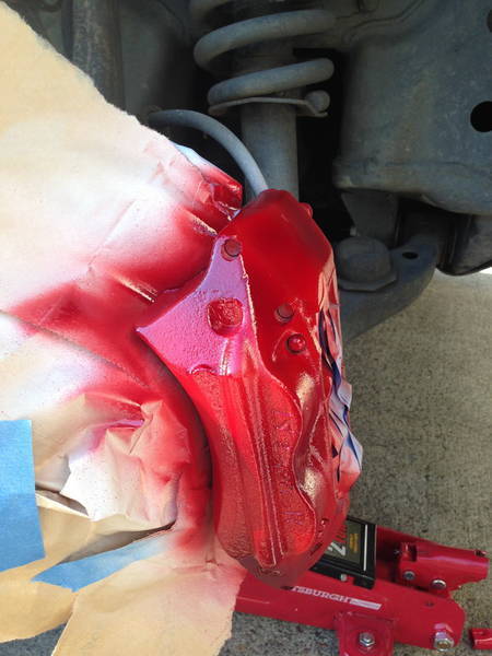

    Painted my brake calipers:

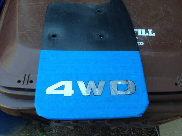

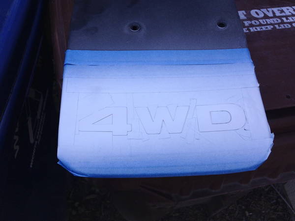

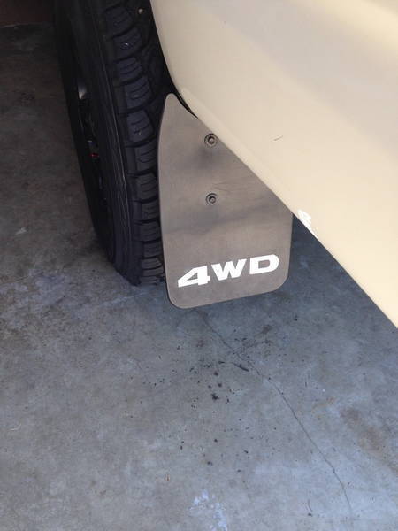

    Repainted the 4WD logos on my mudflaps today. Went with just white primer and latex clear coat that I had on hand.
    Should have masked off the rest of the flap to account for overspray. Had to hit it with a green Scotch pad to get (most of) it off.

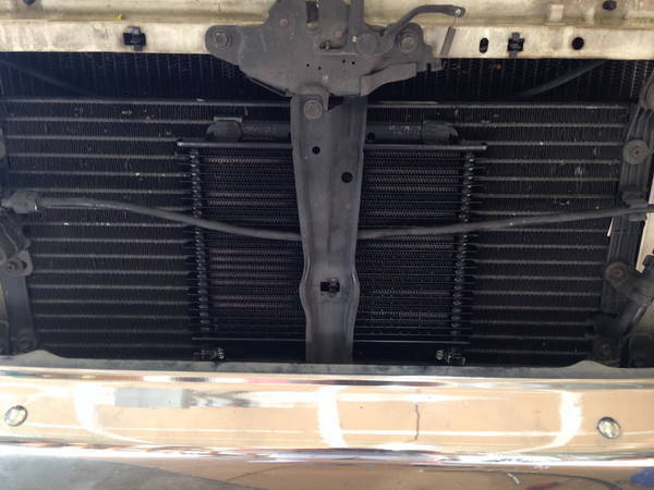

    Added an extra Transmission Cooler today!
    Used as the primary resource. The included manual kinda sucked. Buying the suggested extra 4' of hose ahead of time saved me an in-progress trip to the store.
    Only about 1-1.5 cups of oil came out when I swapped the lines. The dipstick still looks like it's full, so I think I'm ok there.
    Should have mounted it just a little highter. The new hoses are visible from the front, and that kinda bugs me.

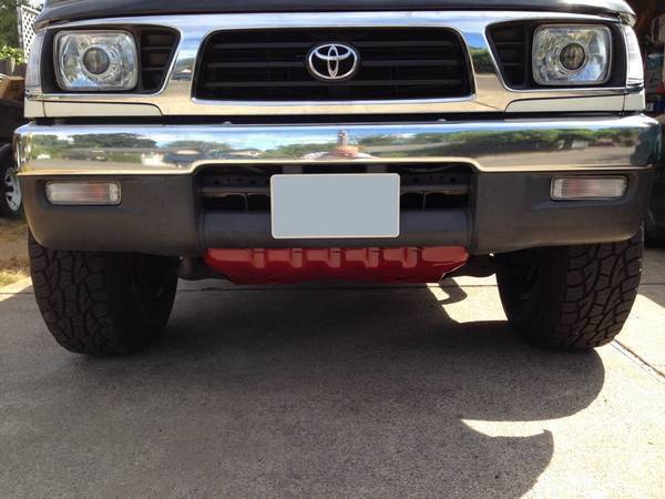

    Painted my skid plate to match the other red accents

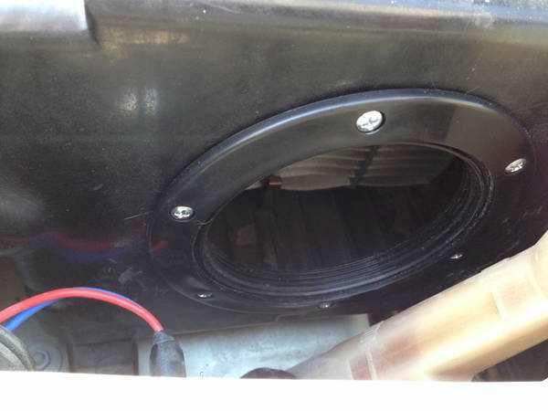

    Deckplate mod...

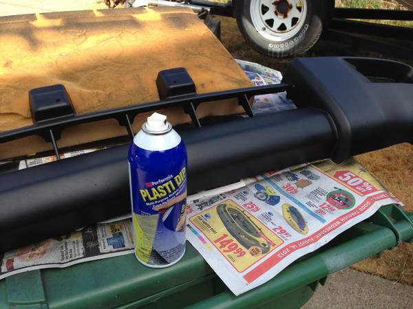

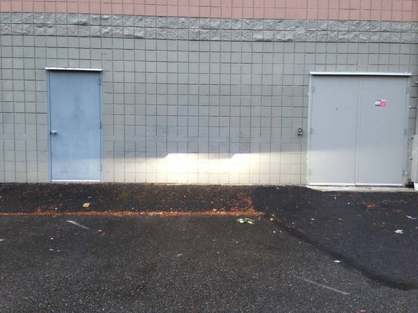

    Plasti Dipped my air scoop so it's actually black again.
    Managed to tweak the passenger HID so it's finally straight.

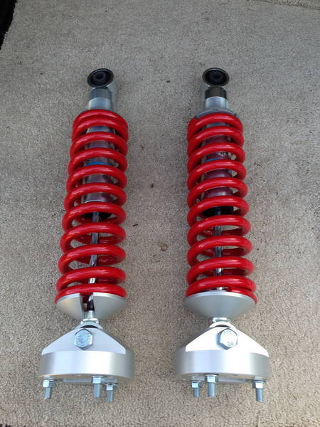

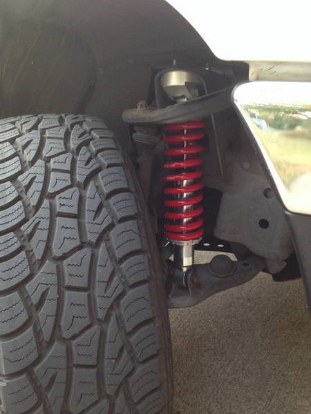

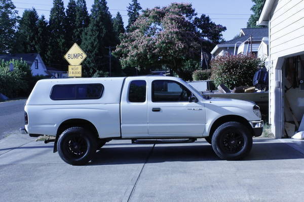

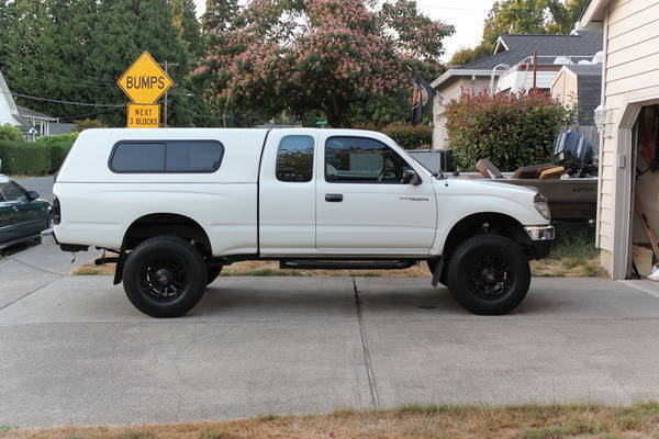

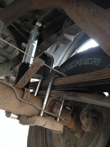

    Got my Toy back from being lifted today!
    Before:
    After:
    Bilstein 5100s and Eibachs from Toytec:
    Bilstein 5100s and add a leafs from Wheelers:
    SanClementeTac01 likes this.
  18. Aug 23, 2013 at 6:58 AM
    #18
    stikle
    stikle [OP] Well-Known Member
    Apr 26, 2013
    #102916
    1,201
    Seth
    The Sovereign State of Eastern Oregon
    1997 LX Xtracab 4x4 V6 3.4L
    Eh, see my Build Thread sig link. Too many mods to list.
    Stock UCAs.
    Before lift:
    After lift:
