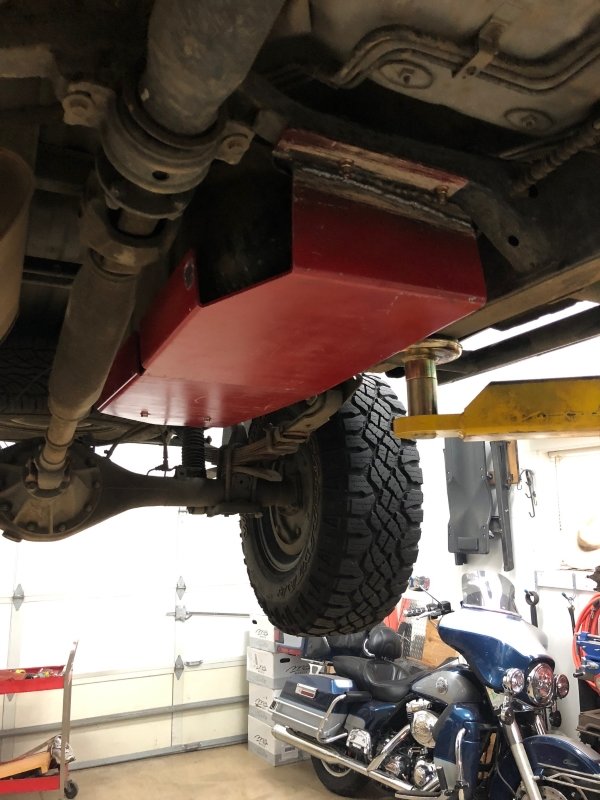

    Oh and also finally got my gas tank skid mounted. Had to do some custom fab work on it at a friend's house because it wasn't manufactured correctly. I'll just have to hit it with some more paint now, but that's not a big deal.

    Any pics of how you fixed it? I got one from the same batch & it’s just sitting in storage as of now, but I’d love to install it! Thanks in advance

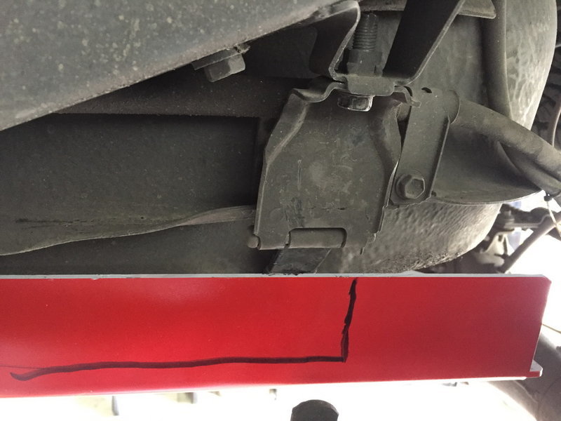

    Well, the previous picture posted showed a completely unnecessary cut on the front facing side. We had to weld it back together. Where we DID have to cut it was on the driver's side. It wouldn't fit up over the strap that held the gas tank up, so we marked it and my buddy whipped out his plasma cutter and voila.
