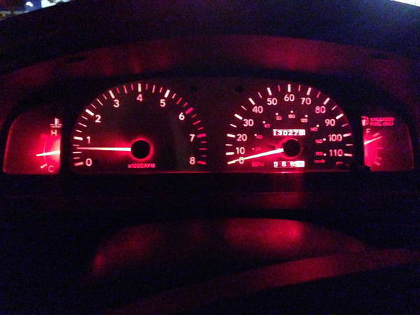

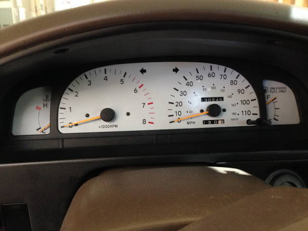

    The cluster mod takes five 194 LEDs. Make sure you get the ones that light 360 degrees. I bought mine from superbrightleds.com.
    And I think you'll need a 74 for the climate controls. There are three of them on my order, but I can't tell you what exactly the other two were for. :confused:
    It wasn't exactly hard, just time consuming. You have to take apart your dash to get the the cluster out. More than a couple bolts involved. The hardest part was regarding the speedometer cable. It's just pressed onto the back of the cluster. When you're putting the cluster back in, it's a bitch to get your hand back behind it to get the cable pushed back on.

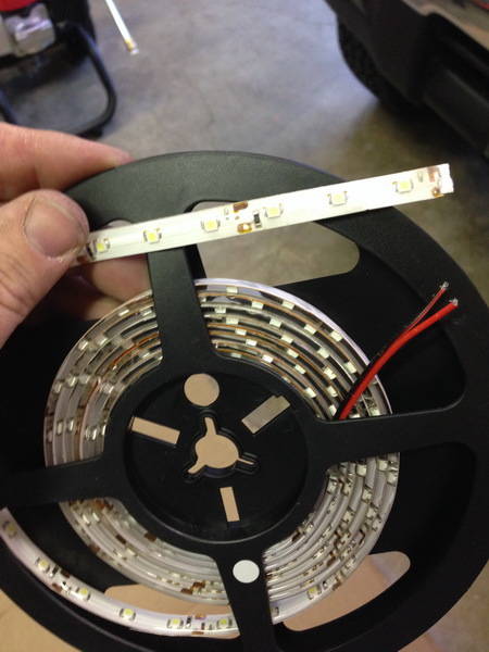

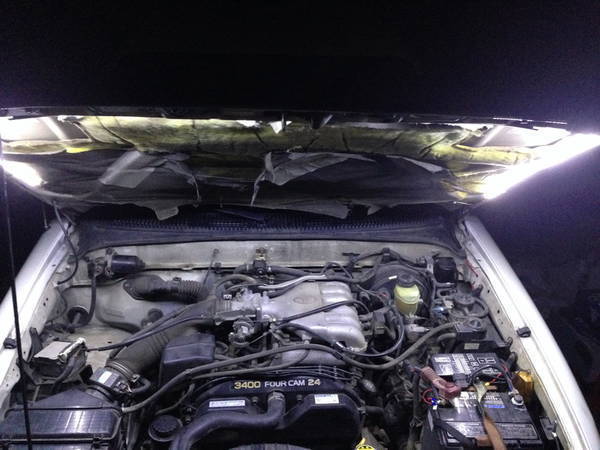

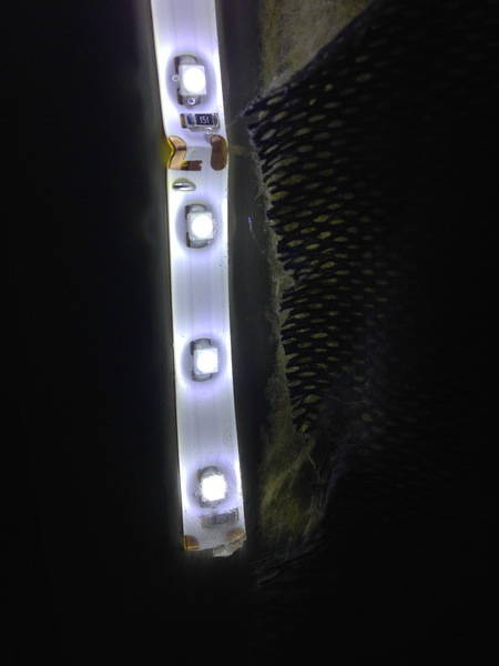

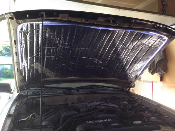

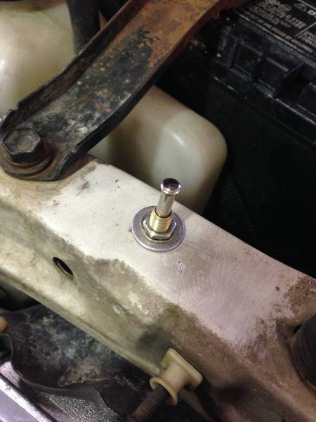

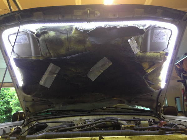

    Here's last night's mod....turned out awesome:
    Pin Switch:
    LED strip:
    Cut to length every 3 LEDs:
    Results in:
    Total darkness:

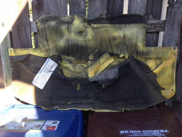

    I should start looking into doing something with that ugly ass hood liner.
    Edit: I just talked to my Toyo tech and he says it's ok to just remove it altogether. It's just there for noise dampening and to keep excess heat off of the underside of the hood.
    Edit 2: I am going to replace it with Dynamat Hoodliner

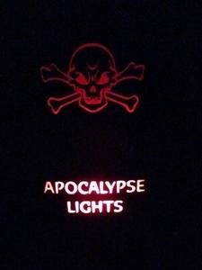

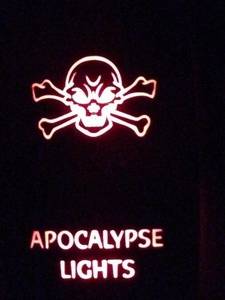

    Added some fun illumination!
    Apocalypse Light Switch
    In the dark:
    With light:
    Unfortunately it's almost invisible on blacktop or daylight.
    Also I need to go back and revisit the wiring. The switch lights up properly (bottom on all the time, top on when lights are enabled), but the problem is that the lights are on ALL the time when the switch is enabled. I should be able to utilize the door pin switch somehow so they only come on when the door opens.

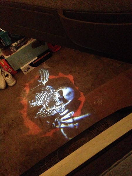

    Oh yeah, I also fixed the wiring for the door projectors. The switch and lights are dead when the doors are closed. When a door is open then the switch becomes active and can switch the projectors on/off. I still think I might want to hook the +12 into ignition so the off LED lights up when the truck is on. Wiring is a PITA though, so good enough for now.

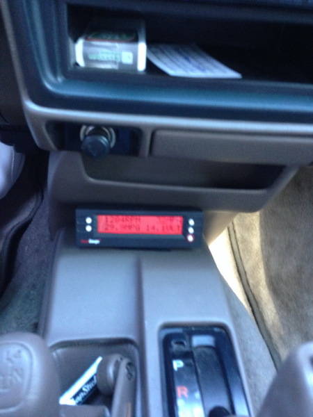

    Also added a Scangauge II to monitor Voltage and temps. Snagged it for $40 off of a Labor Day sale. I haven't played around with it at all yet, so it's all default except the color. Decided to stick it here with Velcro. I didn't like how much space it took on the steering column in front of the gauge cluster. I thought about putting it in the junk pocket under the stereo, but I like my...uh...junk. :D
    Blurry in-motion pic, but whatever.
    And yes...that's the window handle laying by the 4x4 shifter. I lost the Damnit Clip™ when I was putting the door projectors in. Another $.86 down the tubes.
