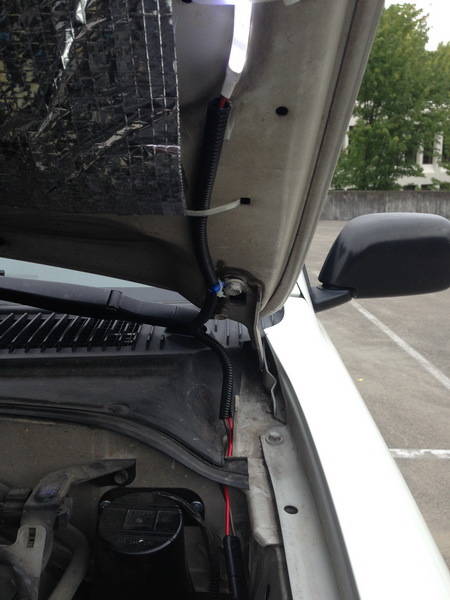

    Lifted with shackle lift and spacers. Bilstein 5100 Rear Shocks. Plasti dipped fender flares. Kenwood headunit and door speakers. DUAL 12" sub with 250 watt amp. Footwell LED light strips. Underhood waterproof LED light strips. Blue LED map light(meant to get white but I like it). LED reverse light.
    Ok so where did you hook up the led's under the hood? I know youve got the pin switch but where is it hooked up to get power? Everything looks awsome man!!!

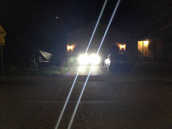

    I ran the wires down the driver's side through some split loom, then continued on with the the positive going to battery positive and the negative to the pin switch. The pin switch grounds to the body so make sure the surface is clean above and below. You might even have to remove a little paint around the hole to get to bare metal. I used an existing hole for the pin switch and it worked out perfectly
    Here's a picture of the wiring with quick disconnect at the bottom. If you look closely at the hood bolt, you'll see a little bit of blue. I used a ring connector on the bolt, and then zip tied the split loom to the blue plastic part to hold it in place. Could have even ran a little wire around the loom and crimped both ends into the ring connector. I just thought of that. Might go back and do that just so it looks a little cleaner.

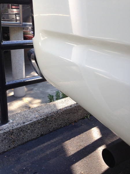

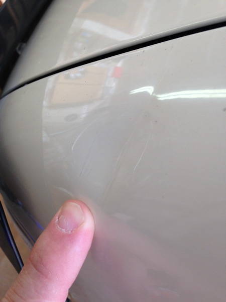

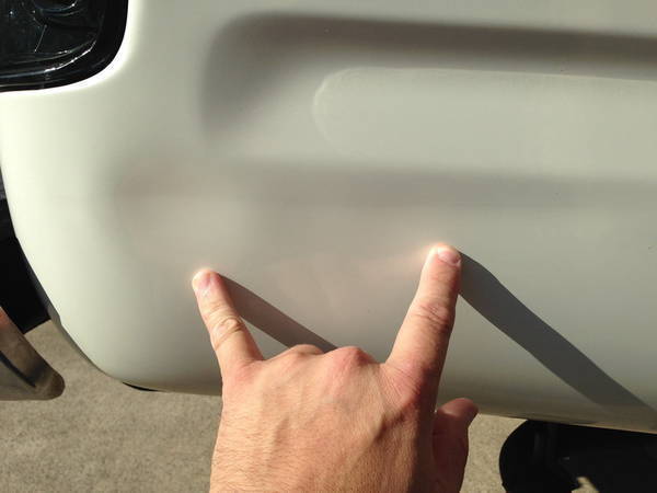

    And for today's mod...it was more of a fix. I had a dent in the rear side bed where someone hit and ran me, and the one on the fender where I dropped a 3/4" piece of plywood on edge. Oops. :mad:
    So today I had a Paintless Dent Repair (PDR) guy show up and he fixed both for a whole $300. Amazing job, the dents are completely gone!
    Fender before:
    Fender after:
    Bed before:
    Bed after:
    I'm a PDR believer!

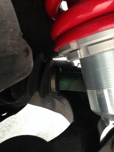

    I discovered that all four CV boots were leaking. The rubber felt pretty stiff, so it was probably just time to replace them anyway. 16 years...seems reasonable to me.
    Before:
    Ordered new Empis from Amazon and had them put on yesterday:
    I don't remember which ones were outer and inner, but here they are:
    Two of these:
    Empi boots
    and two of these:
    Empi Boots
    Parts - $77
    Labor - $200
    Not getting all greasy and frustrated: Priceless

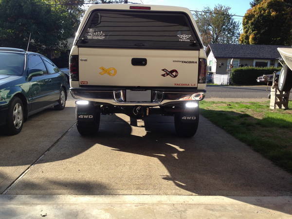

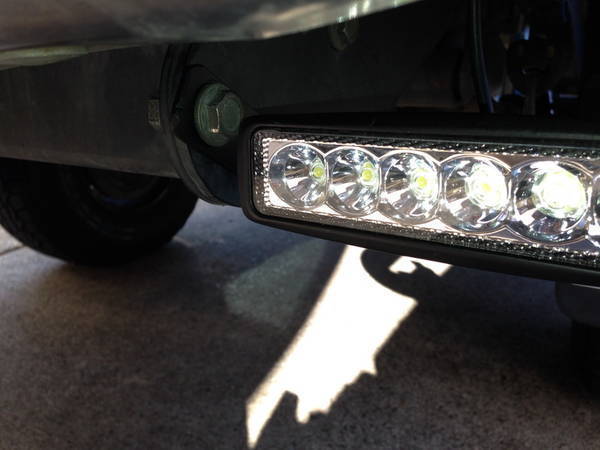

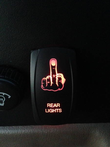

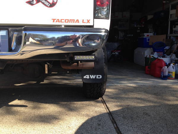

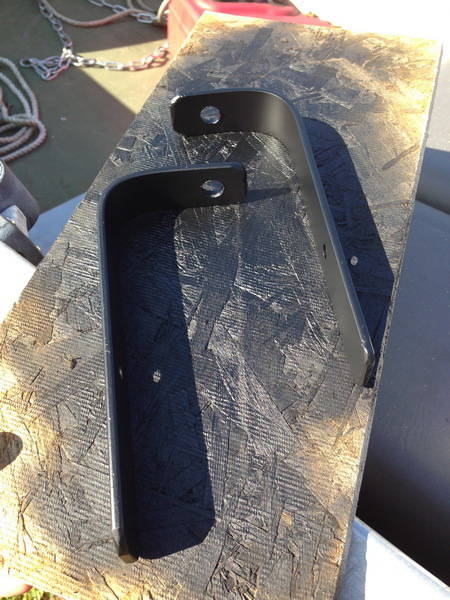

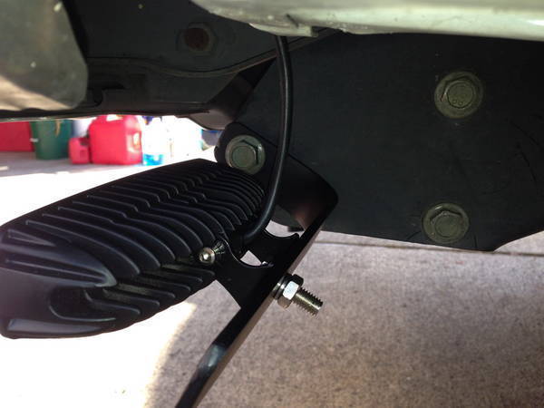

    This weekend's activities:
    • Installed new rotors
    • Installed new ceramic brake pads
    • Installed and wired my rear light switch to the ignition accessory so the text lights up
    • Used split loom to clean up the wiring all the way to the back end - PITA
    • Conscripted a buddy to help me make rear light mounting brackets
    • Painted the brackets and mounted the lights to the tow hitch frame.
    • Washed her
    Rear Light switch by OTRATTW.
    I intentionally made the bracket extend slightly past the end of the lights just to add a little more protection.
    Here are the lights that I used:
    18w 6 LED 1360 Lumen 6000K
