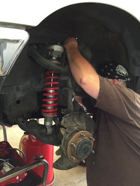

    Well, I got the next upgrade done today!
    A buddy of mine bought an Atlas lift from a going out of business shop and installed it in his home shop.
    I never want to work on the floor again!
    The Callahan 2005 Tundra Brake Kit is an (almost) bolt-on replacement upgrade that fits 95-97 (and maybe others) Tacomas. I went with Callahan because they had a nice red caliper that matched the other red accents on my Taco. There's plenty of other options as well.
    (I'm sure glad Callahan didn't sell to Zalinsky (Tommy Boy reference FTW!))
    I also bought to upgrade at the same time from .
    Add brake cleaner and a bottle of DOT 3/4 brake fluid and the total price of the upgrade was right around $420 and 2 hours of time.
    It was relatively straightforward. The hardest part was getting the damn passenger side brake line "U" retention clip off. Took two of us 20 minutes.
    In position with the arms lined up properly on the frame:
    Going up!
    Wheel removed:
    Old pads removed and caliper unbolted:
    Removing the driver's side brake line retention clip:
    You can see the lip of the passenger side retention clip. It was a bitch to grab hold of.
    I managed to turn it almost 90* - gee that was sure a help.
    My buddy took a turn at the clip while I went and cleaned off the new rotors:
    New Tundra 13WL caliper (left) vs stock Taco caliper:
    Here's the two parts of the dust shield that had to be trimmed so the bigger Tundra caliper would bolt-on properly. Only about 1" or so from the top and 1/2" from the bottom was required. 30 seconds or so with an angle grinder and a couple of quick swipes with a file to clean up the edge.
    We also had to bend the dust shield back so the new rotors didn't touch. It didn't take much.
    And after trimming:
    Hand tightened the new rotor on with two lug nuts to hold it in place and then bolted on the caliper:
    Inserted the new pads and figured out how the retention clip worked since it's a different style from stock. Also remembered to put the bottom pin in too:
    All done!
    Everything torqued to spec, and bled the brakes on both sides. The first side was totally mushy. I felt the pedal all of a sudden get firm about halfway through the second side. We did about 3 cycles past when air stopped coming out just to be sure.
    Topped off the brake MC, mounted the tires, torqued down the nuts, and took her across the street to a school parking lot and did some speed runs and slowdowns to try and "bed" the new brakes. They grab pretty hard now...locked them up at about 30mph and had some tire squeeling.
    Plenty of clearance on 16" wheels. As others stated, you can't do this on stock 15's - there's just no room.
    The only problem is that when I was backing out of the shop, the brake light indicator lit up on the console. I checked the Scan Gauge and no codes were thrown. Checked the E-Brake and it was definitely disengaged...not that it should matter since that's the rear brakes and we didn't touch them.
    I drove about 20 miles home and the light was on all the way until I parked it in the garage. I did plenty of braking on the way and everything feels tight and solid, and no odd sounds.
    I'm going to have to do some Googling or something to figure out what's up.
    Edit: I let her sit in the garage for an hour or so. Went back out, added a little more brake fluid (even though it was above Minimum), started her up and left her in park with no foot on the brake, and released the E-Brake. No more brake indicator light. <shrug> Who knows...I'll just watch it for a a while and see what happens. Looks all good now.
    So...there we go!

    Lesson learned: After installing something, go back and check the bolts after a couple of days.
    My console brake light came on again the other morning. I checked the reservoir and sure enough, the fluid was way down. Not dangerously so, but still, there shouldn't have been any change.
    So I got down underneath and sure as shit, there was brake fluid all over the underside of the passenger well and all over the inside of the tire and wheel. I wiped the caliper off and then pumped the brakes a few times to figure out where the leak was coming from. Turns out the banjo bolt wasn't quite snug enough. A 14mm wrench later, more fluid added, and all has been well again for days. The pedal also firmed up a little more. I hadn't realized it was slightly mushy, but it was.
    So yeah. I'm still pleased with the result and so far don't feel the need to upgrade or replace the rears at this point.
