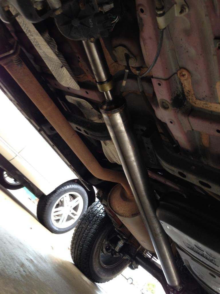

    Edit: I didn't want to discourage you, but driveshafts are heavy, and accidents happen... Case in point
    I had safeties, (jackstands, partially set bolts, etc) and I removed them one by one to get more range and flexibility while I was under my truck. Then that happened. It happened back in May, but its not something I'm forgetting anytime soon.

    I have never installed a CB. The most I have done is simply take off the driveshaft to have the CB replaced and then reinstall it. I am afraid my "new" CB is a little too worn to add the silicon to. After all this headache I am tempted to just get a one piece and eliminate the vibrations all together.
