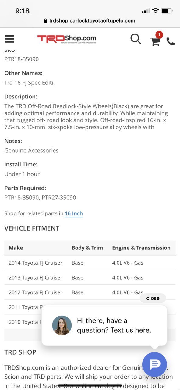

    Anybody find the magic number for TRD 16x7.5 wheels with 10mm offset?

    A 7.5-inch wide wheel with +10mm offset has 4.64-inches of Back Space.
    That said, your TRD OR wheels are 7-inches wide with +25mm offset which works out to 5-inches of Back Space.

    Thanks for the reply, I double checked and the TRD wheels I purchased are 16x7.5 with a 10mm offset.

    Ah okay, yes the bead lock style wheels are 7.5-inches with with ET+10 offset. The 4.64-inch Back Space is correct :thumbsup:
