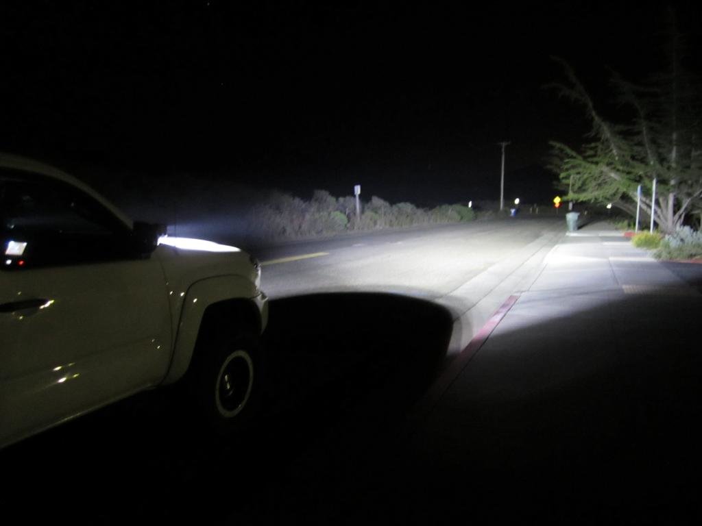

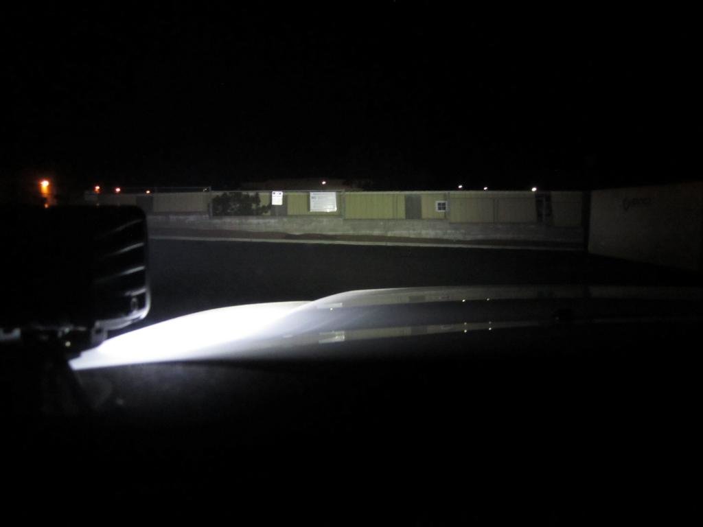

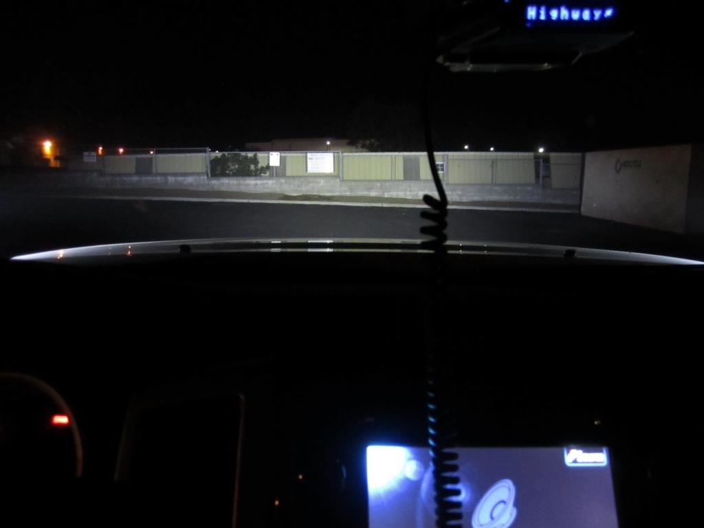

    do you have a lot of glare on the hood from the d2s on the hood bracket?

    My D2's are the "Specter - Driving" pattern so it's the best compromise between width and length. There is a glare on the hood, but it's honestly not too bad, and I have a white truck too. I can try to snap a photo tonight for you.

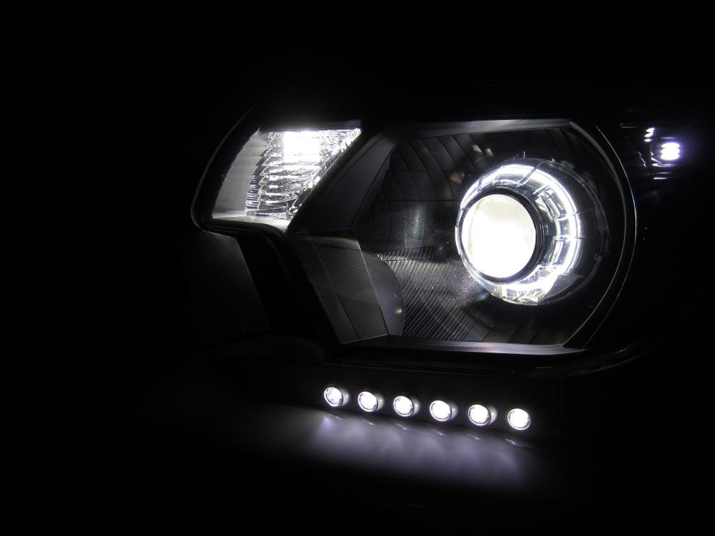

    Thanks! :) what Jerez said below me \/\/\/\/ shoot Anthony "DTFtacoma" a PM. Mine is his "Type C" bumper. ;)
    Haha thanks but more like "DRY WALLET" build lmao. Hey but who cares, carpe diem!!! You never know when it'll be your time to go right!? :)
    Caesar at Lightwerkz will definitely take care of you on that retro! Were you surprised at the pricing??? More or less than you anticipated???
    Andrew @ TRS builds the LS460's for Caesar and he's also a very active member here on TW so you've got plenty of support if you ever need any on your headlights. Andrew is a VERY helpful guy, and is always responsive with emails and calls!
    Please run Osram CBI's in your 460's!!!! That's the only bulb that anyone should ever run in these projectors!

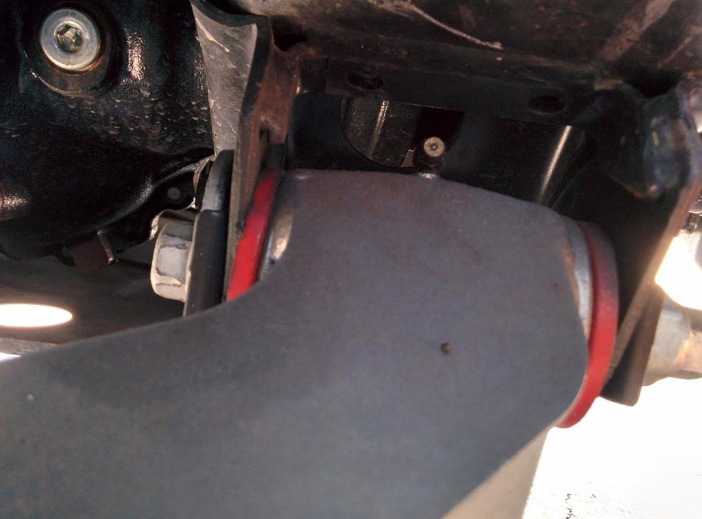

    Snapped these for you 5 mins ago....
    driver's side rear LCA mount:
    passenger's side rear LCA mount:

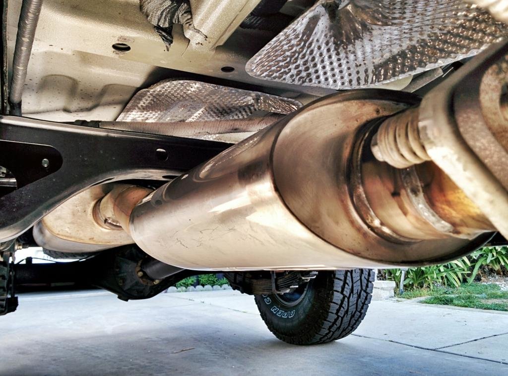

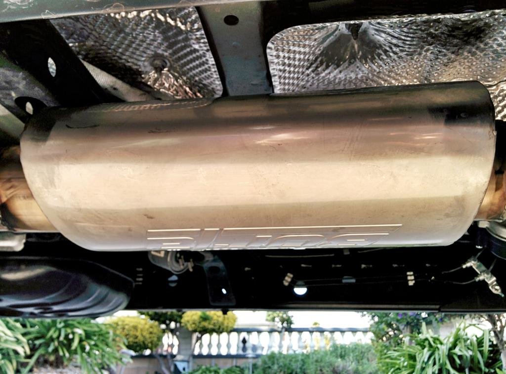

    Damn reading through this thread, I can't believe I forgot to post my exhaust system update back in February!!!
    Anyway, because I am terribly OCD when it comes to finding the balance between a good sounding exhaust that won't kill mine or my passengers' ears inside at ANY cruising rpm.....I got rid of the Vibrant resonator and replaced it with a Borla XR-1 canister. Part #40943(center in/center out/12" long/ 7.875" wide/4.5" thick").
    which feeds into my bigger Magnaflow canister in the rear(specs on 1st page):
    I kinda took a similar route to Super Werty here on TW running inline muffler canisters on a full catless 3" exhaust system. The only difference is that mine uses ALL center in/center out canisters and I have my exhaust dumping right before the rear axle
    The result, in my opinion, is perfect. I was getting a bit off annoying drone in a small area of the RPM range in 6th, but it was the range I would cruise in the most lol---the 65-73mph range. So, I had to do something about it because it was getting on my nerves. It was louder for my passengers in the back too.
    With the additional muffler in there it's ONLY loud when I want it to be, and it's very tame at any cruising speed/rpm. Nice tuned deep sound.
    You know I had to shoot an updated video!
    http://youtu.be/Ay6H70CulRA
    I apologize, the sound quality for the lower revs is absolute SHIT. The slight breeze + limited cell phone microphone pickup on sound, but I assure you it sounds much better at low rpm's than what it is in that video. I will try to shoot another one when there isn't such a breeze rolling through.

    Alright without further delay....the Rigid D2 shots....
    Please note, ONLY the D2's are on and nothing else in these shots: [bright!!!]
    Driver's side:
    Both sides:
    Beam output:
    As you can see, the glare isn't too bad at all. Hope these pics help.

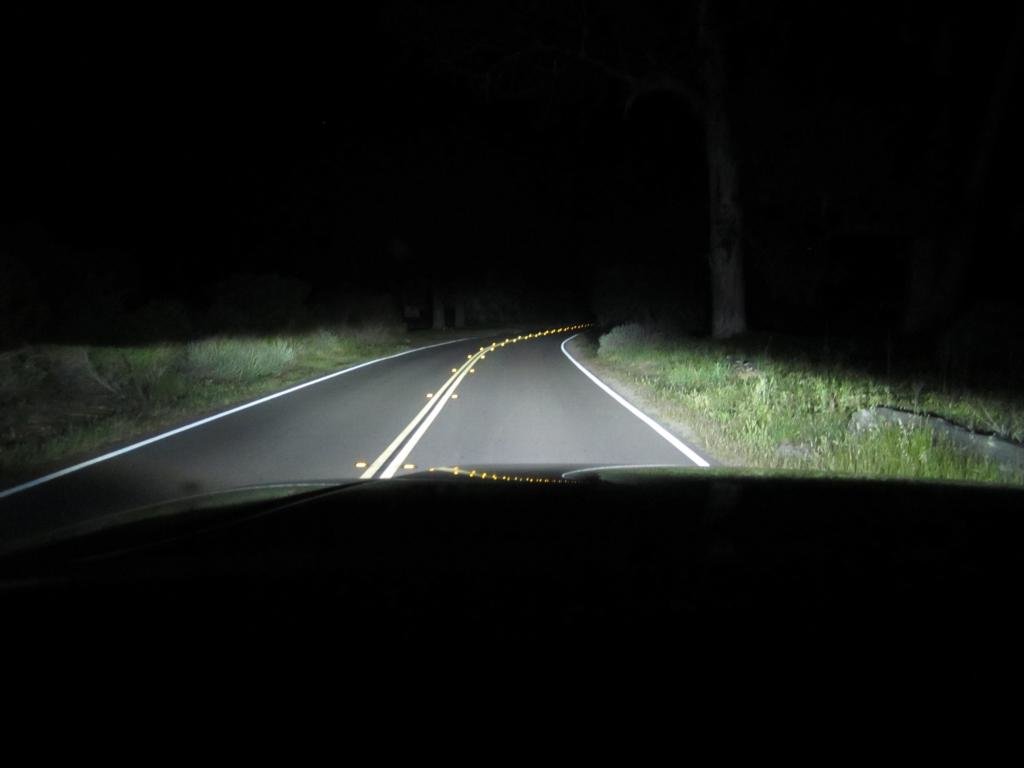

    A driving shot with the LS460's (low beam)

    Thanks man I really appreciate it! Those pictures just sold me on the D2s
