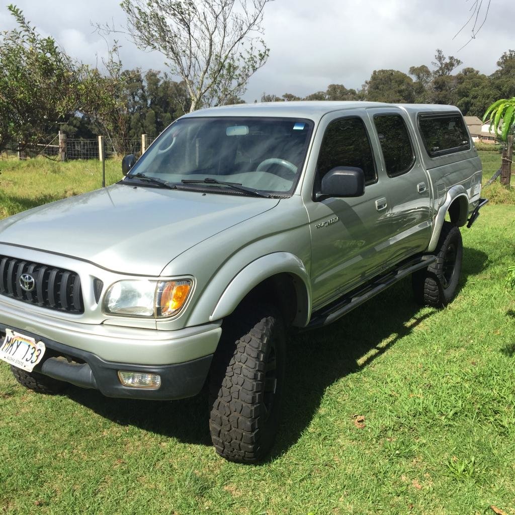

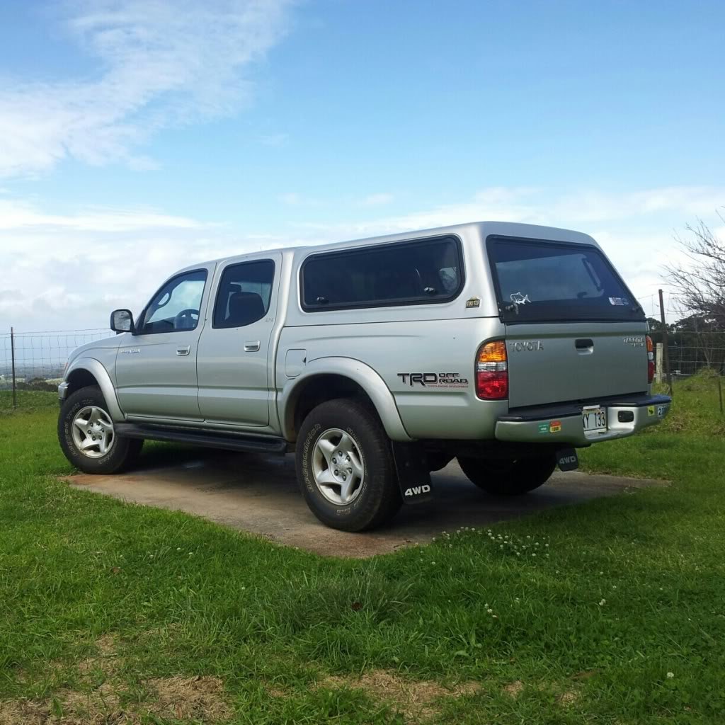

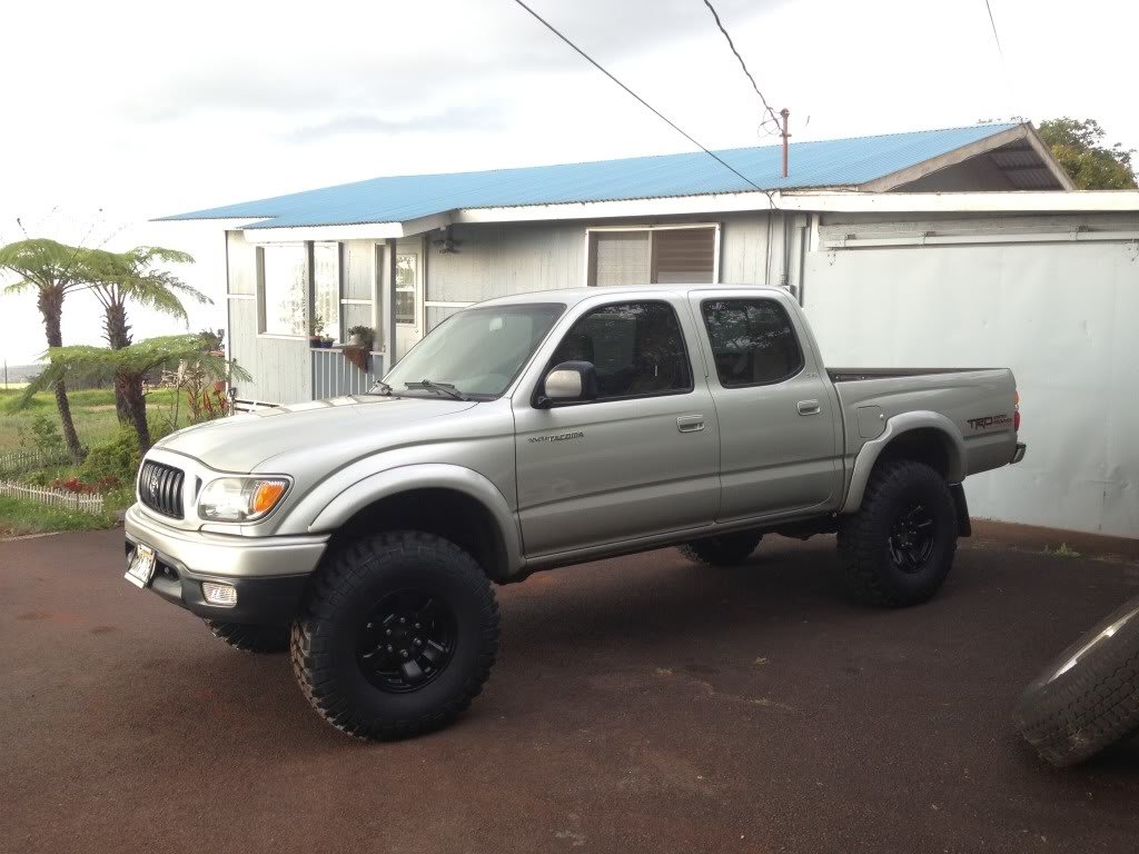

    here is a pic when i got it (finally after 4 years of saving up found a nice one!!

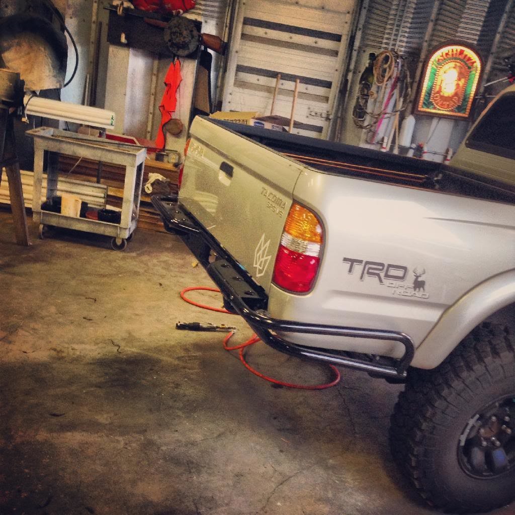

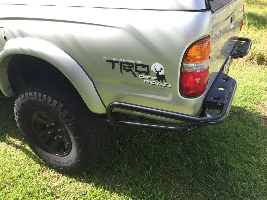

    Here it is all done except for my Relentless front bumper waiting for him to offer it in aluminium again!!
    Suspension is awesome rides great goes almost anywhere couldn't ask for anything more!!

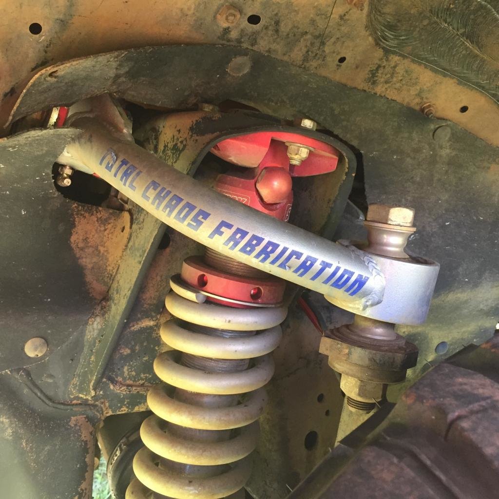

    Suspension:
    Sway Away 2.0 Coilovers
    Total Chaos UCA's

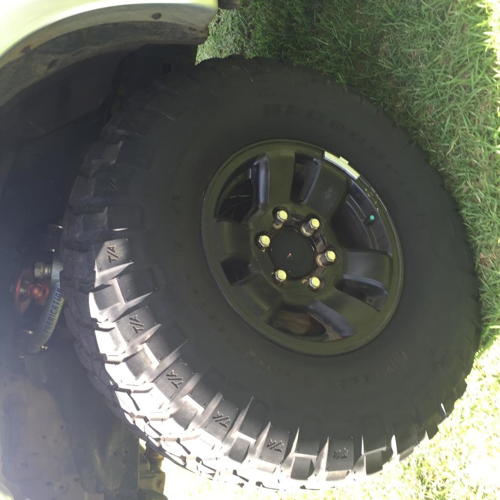

    Wheels and Tires:
    33x10.5 BFG Mud Terrains
    98 Alloy Tacoma wheels Painted Black.

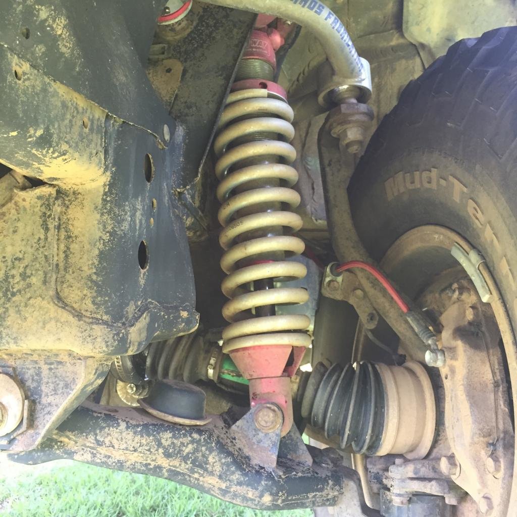

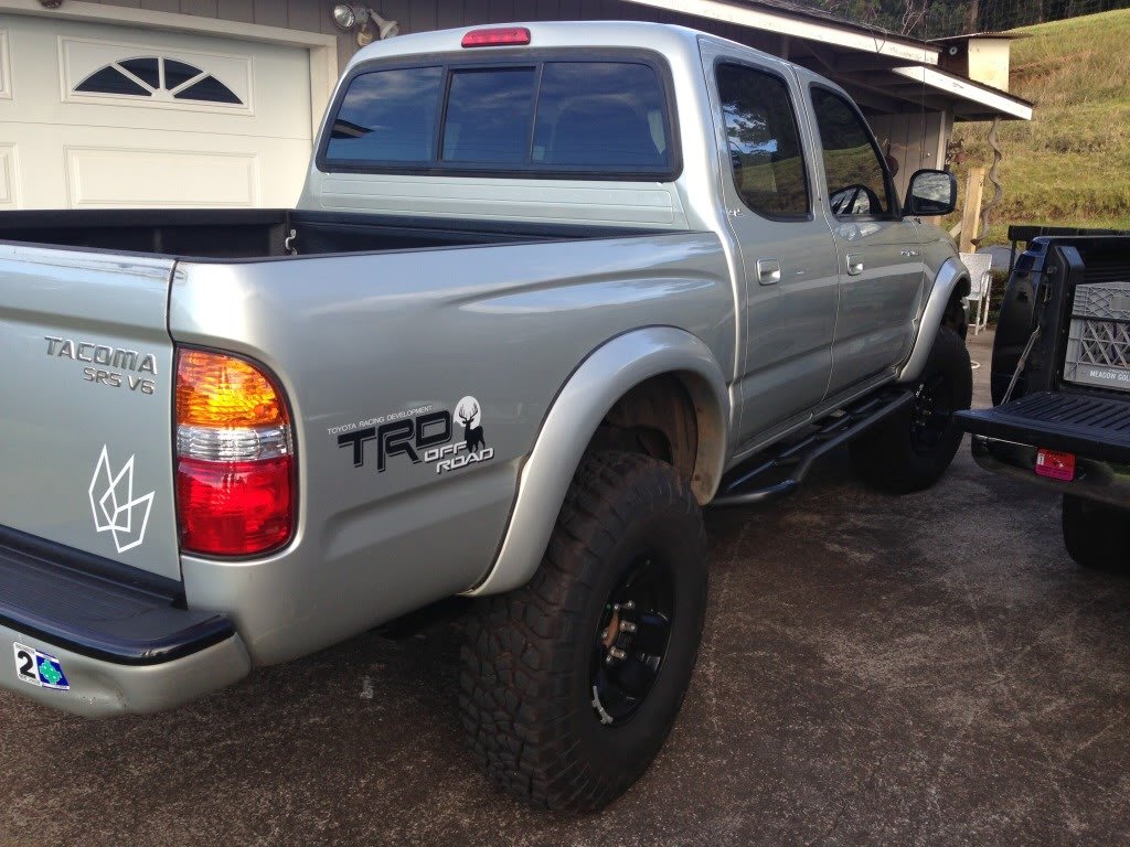

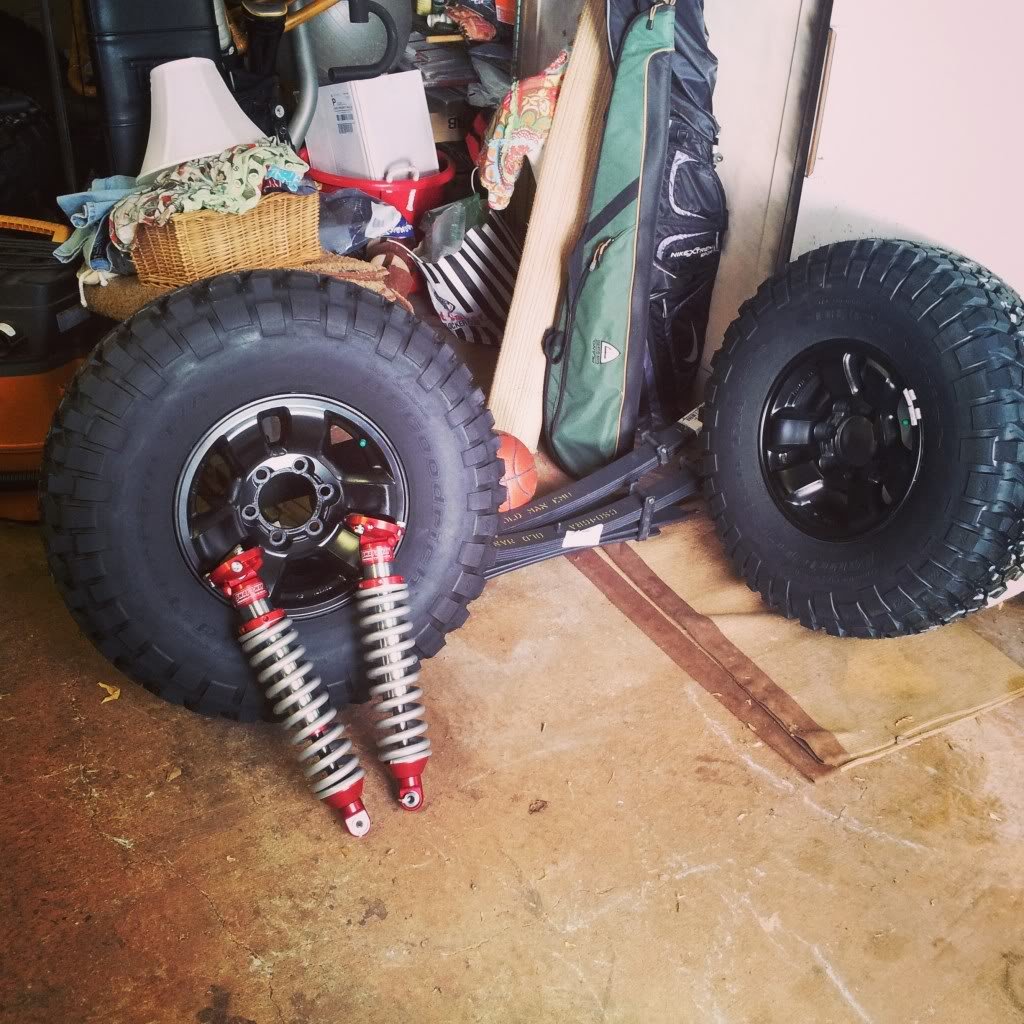

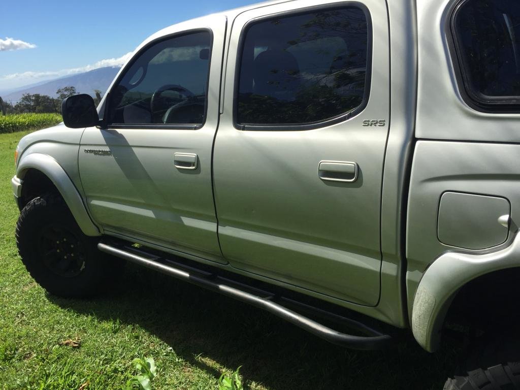

    after some research here and over at TW ive picked up some 2.0 sway away coilovers dakar rear leaf springs and some icon vs 2.0 rear shocks. cant wait to install them and i got some 15 oem 4 runner wheels and painted them black and threw some 33x10.5 on em. just gotta find the time to put it all together (i work to much!!!)
    also got a Metal Miller skid plate on the way!! and just ordered today some all Pro Sliders.. thanks to my local shop IMM (intense motor sports maui) i could get all this stuff at a good price living here in hawaii
    .......... so here it is after install!!
    5AF651A0-A40B-4E76-894F-A1DD9B668288-329_b931ce40fea389e7568455056de08835f4c7ad90.jpg
    ive got to level it out but i think it looks pretty good

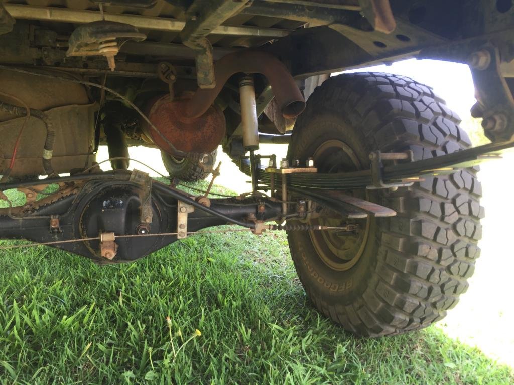

    Dakar springs.. running stock shocks for a week or so waiting for my stupid icon rears to come in!. installe the whellers brake relocation and rear line pretty simple stuff.
    3AF22B08-A1F4-4591-B20E-A2D0662C80BC-329_07f86f5ff5388cefb8ff022ca041b98dad5861bc.jpg

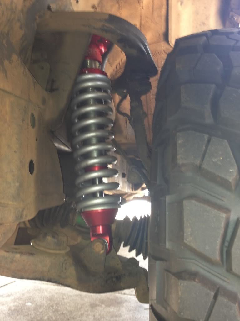

    Front saw 2.0 coilovers.. again a pretty simple install after i figured out how to do the first one..

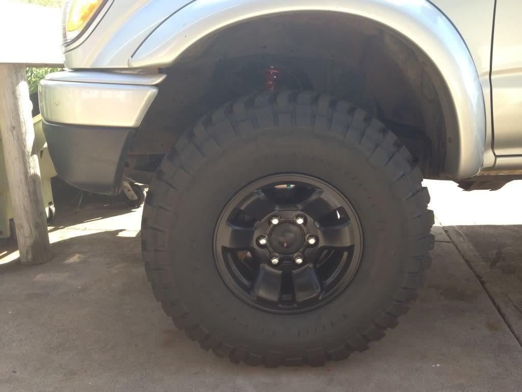

    got some older model 15 inch rims came off a 4 runner sprayed em black and running some 33x10.5 love the ride so far

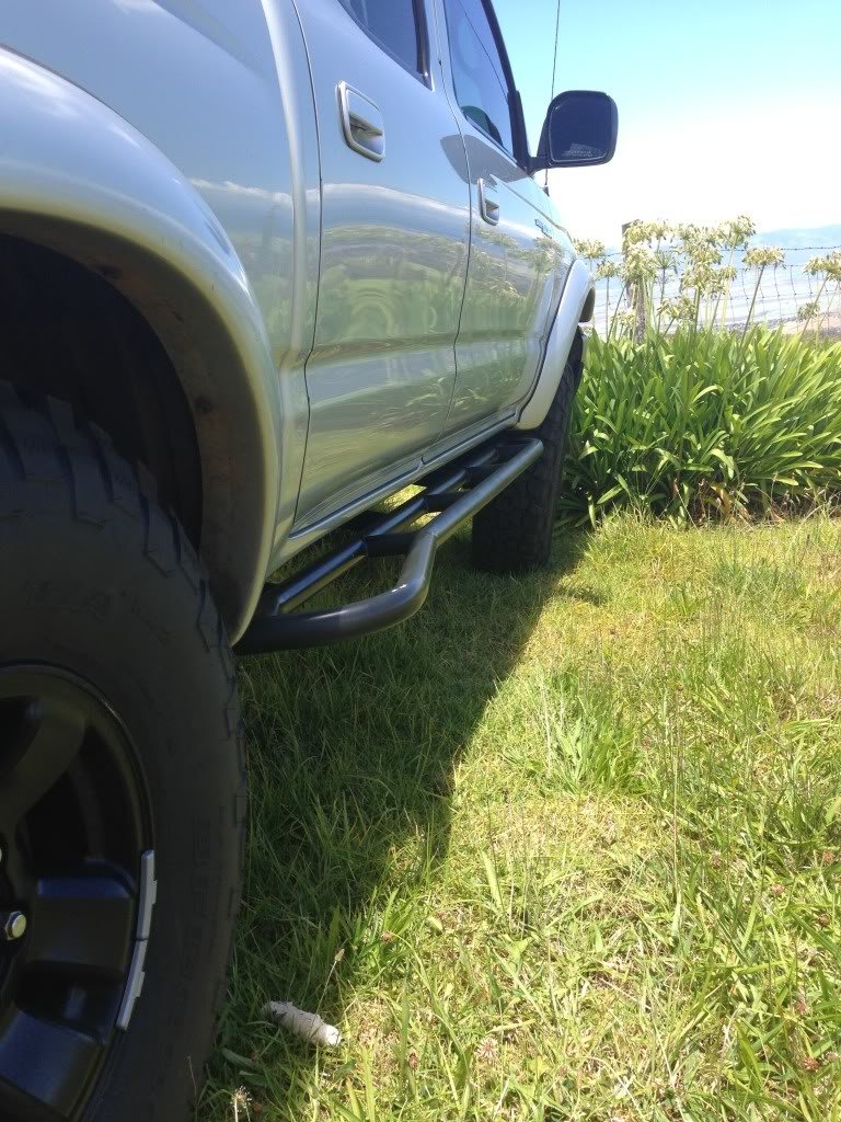

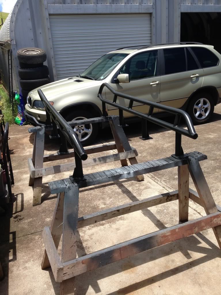

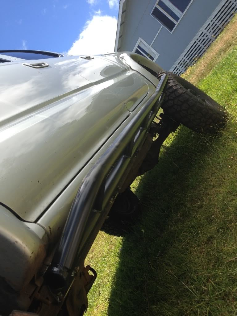

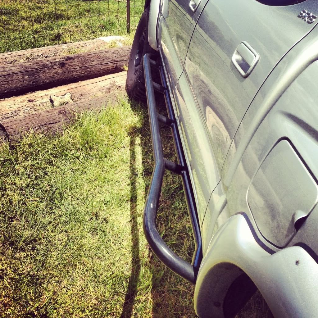

    and got my allpro sliders in using some rustoleum spry paint seeing as if i plan on actually using them i can just touch em up easy!!
    CCC4A00C-370B-456F-9DB0-0C652796DEBD-329_ec1c44f9735813ed89f088d4bd74f29e4d6b7517.jpg
    B89EBA71-5603-4D7D-8E4D-D1E399B6C7F9-329_8ba26bb42de7f6f0e769deefe576438e68530ddd.jpg
    ED8D85A5-835B-4609-A72F-486DFE4DE380-329_74f869ce421fd9a0e3df45ec3d273e937a9bf43d.jpg
    330F47A6-3D72-4B22-B075-436CAD1DD98C-329_dd8680cb322a35f47526b202fb1688bad2a953b3.jpg
    6B9CC0A1-CBAC-49EC-B310-634515CFBF2A-329_817c038eaa06aac341bbe24593b3a707096afe26.jpg
    got to finish them up tomorrow..

    got em all painted and ready to weld up!!
    C84ECD9B-4C93-4D61-958A-AF8BE1DD2A6C-449_eb1d4e1efe30545d9dcdc1d3742eb1455b16cafa.jpg

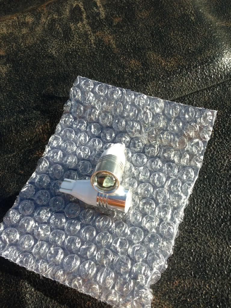

    i got some led reverse light from ebay hopefully they will work out well see when it gets dark!! i like the whiter look of the light i hope its actually brighter. if anything it looks good ha
    here is the link to the ones i got. you can just do a search if your looking for some of t15 led cree any of those should work.. i think one with a 360 pattern would work better but these were 10 bucks so ya.
    http://www.ebay.com/itm/251273262321?ssPageName=STRK:MEWNX:IT&_trksid=p3984.m1439.l2649

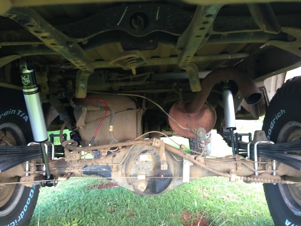

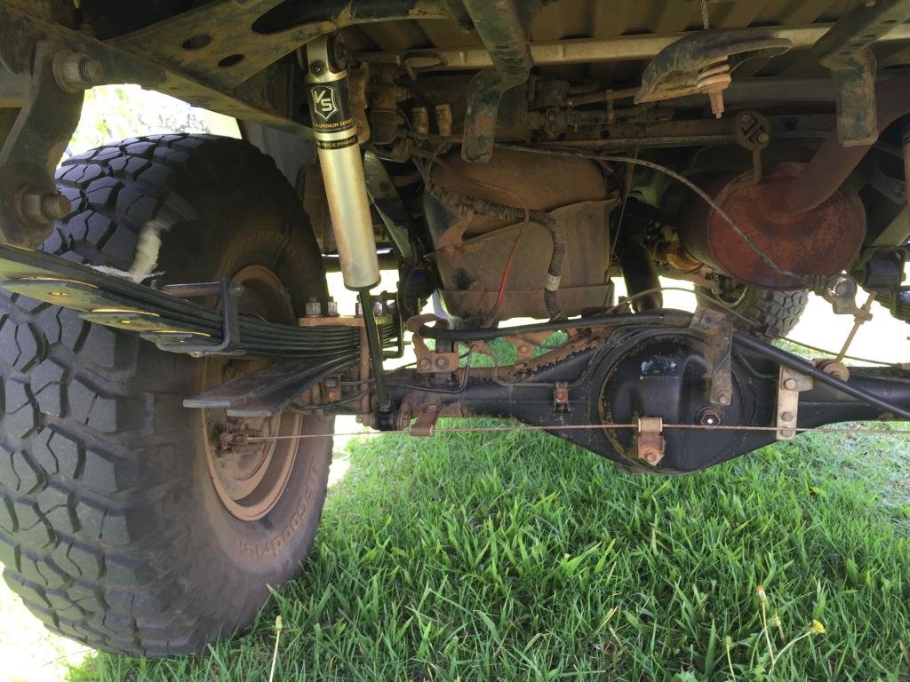

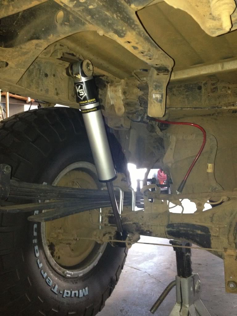

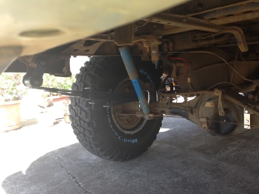

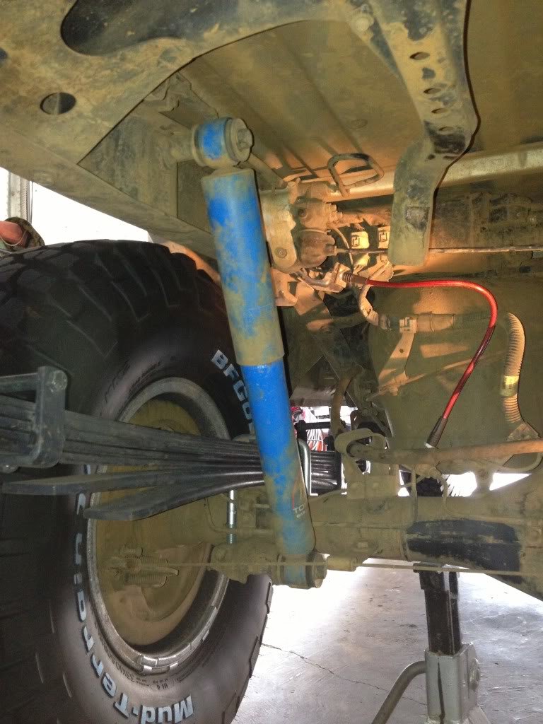

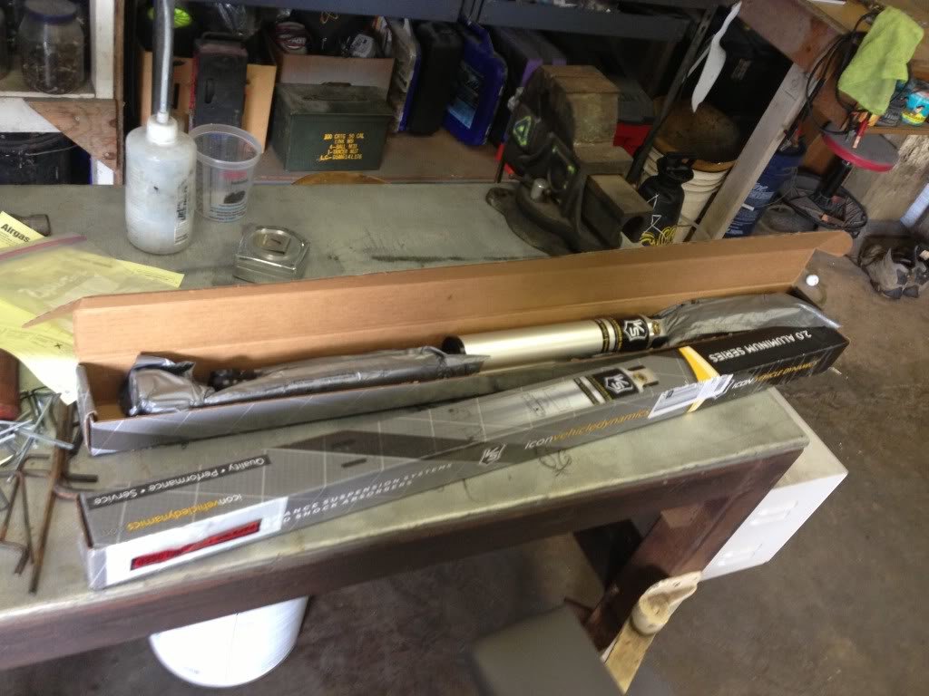

    rear shock install day!!
    9AB76123-F019-4C85-9456-550A2C8E75D7-133_caf6c78a40429c6d046c6afb59c4c68ce2d7ba0b.jpg
    just take of top and bottom 17mm bolt. use a prybar to persuade them off the perches apply some grease and slide on the new ones re tighten the bolts and wall ah new icons installed
    2DA8B85C-049C-41FF-AF79-946A056F3824-133_2b8d0367872a9a99bc6aedba45b2631635c12335.jpg
    1099B51F-274E-4987-BE15-AF2A6D4AD31D-133_3864b1013cf7bddbd57683e78b0cb211a14d01fa.jpg

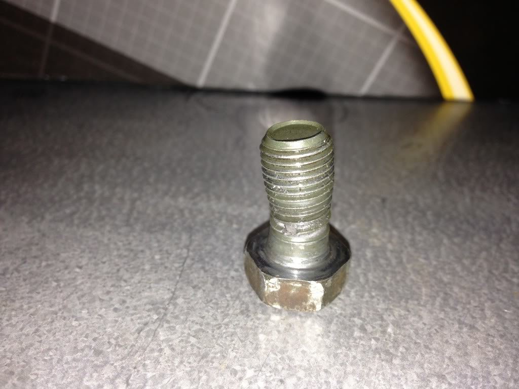

    i snapped my top bolt because of a stupid torque wrench!! thank goodness for a friends come along set!!
    8812E980-43D6-4D93-B0D3-26D44FA888D0-133_a98c622a7989d510de74814877cc84769a363338.jpg
    all done ride super nice they just flow right over bumps!! way better than factory

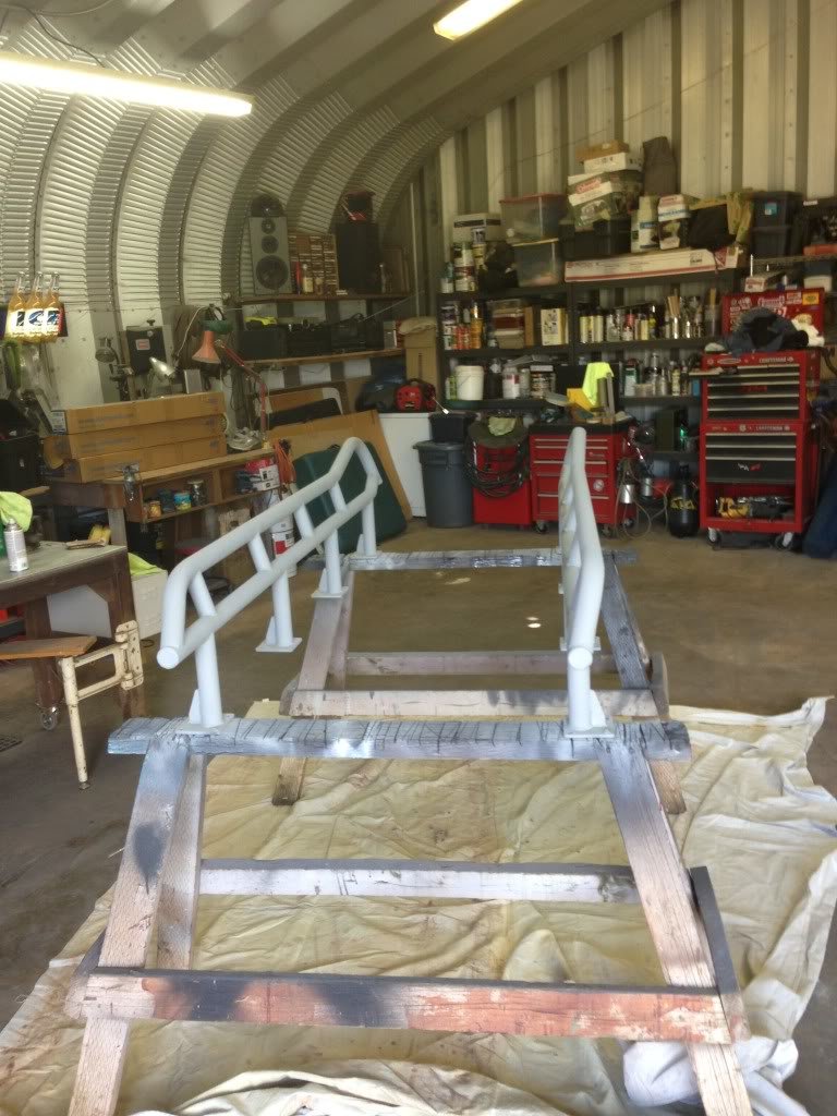

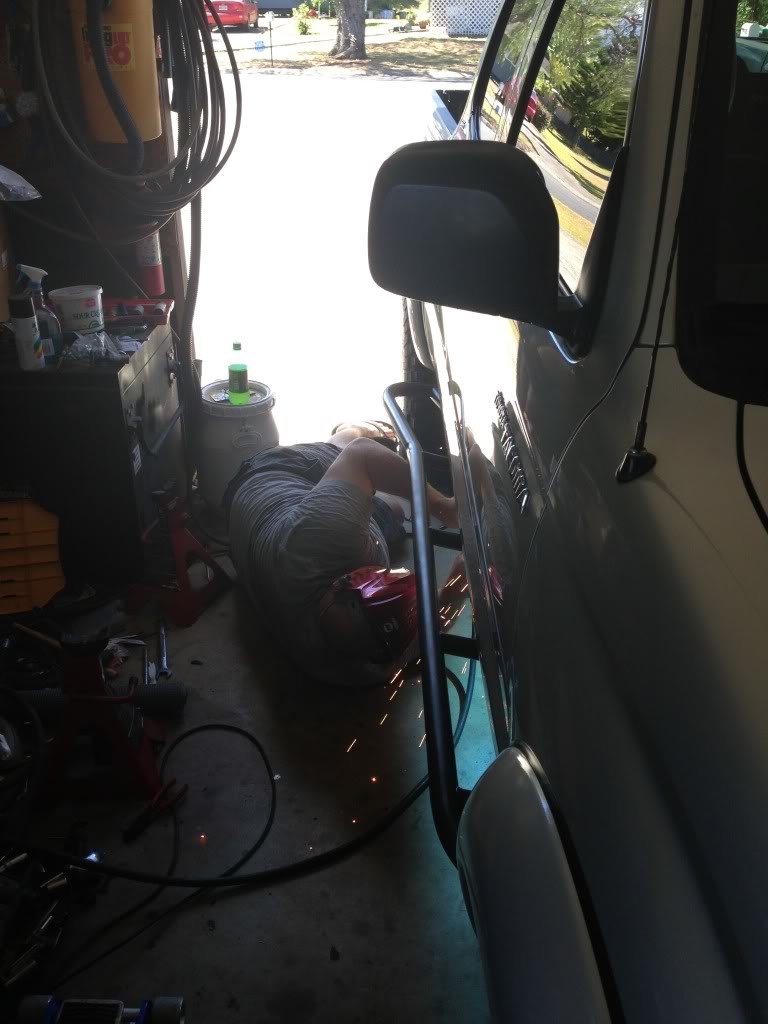

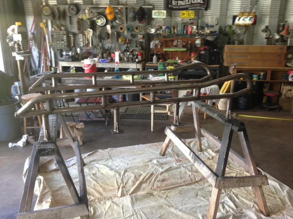

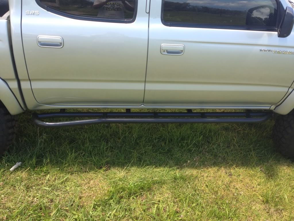

    finally got my sliders welded on with the help of my buddy!! Allpro sliders and sockmonkeys last bedside decal love the decal very high quality and awesome design

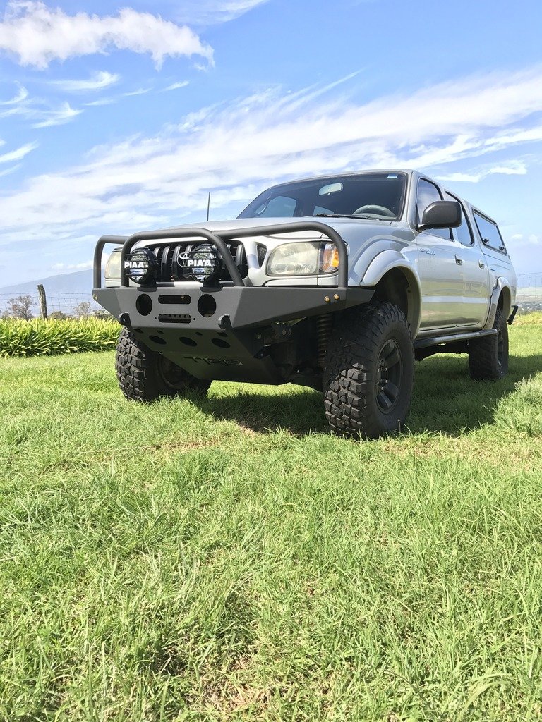

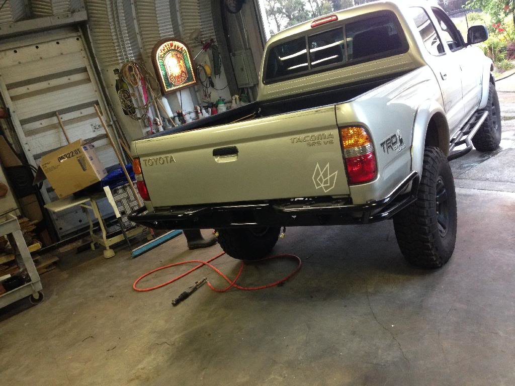

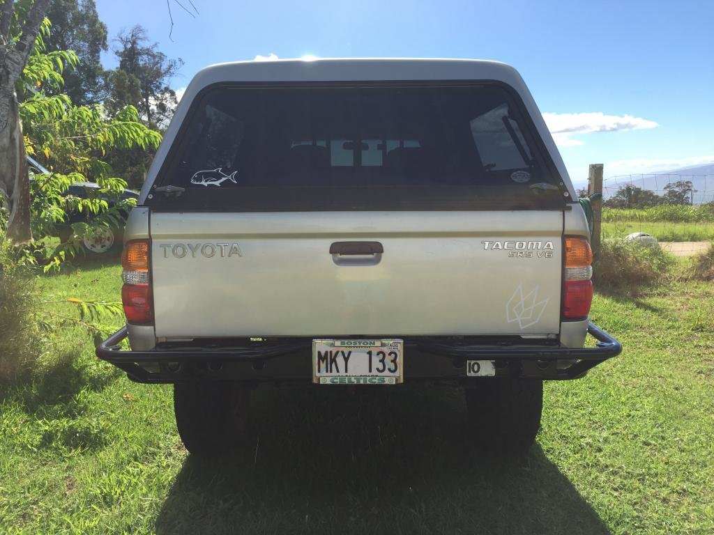

    Got my allpro bumper painted and installed F4F76854-DB03-46C2-B52E-39E622DE8866_zps_65e17727be5a7a7ed8fef2ea96b136c89afed6ac.jpg
    4E321C5C-AC27-4E8A-99C0-0C6168CB6D1E_zps_3da7bebdd1b5fc000d8b48185ad482fbd52c8400.jpg

    Thumbs up to your build, it's coming out super clean! I was curious as to how the allpro sliders with the kickouts would look on my truck and this now answers my question as well as confirms my eventual investment in a set of those, I was curious what kinda flex you are getting out of the rear? My truck is still all stock suspension wise and was thinking of going with the allpro expedition rear leaf kit but was open to other options as well.

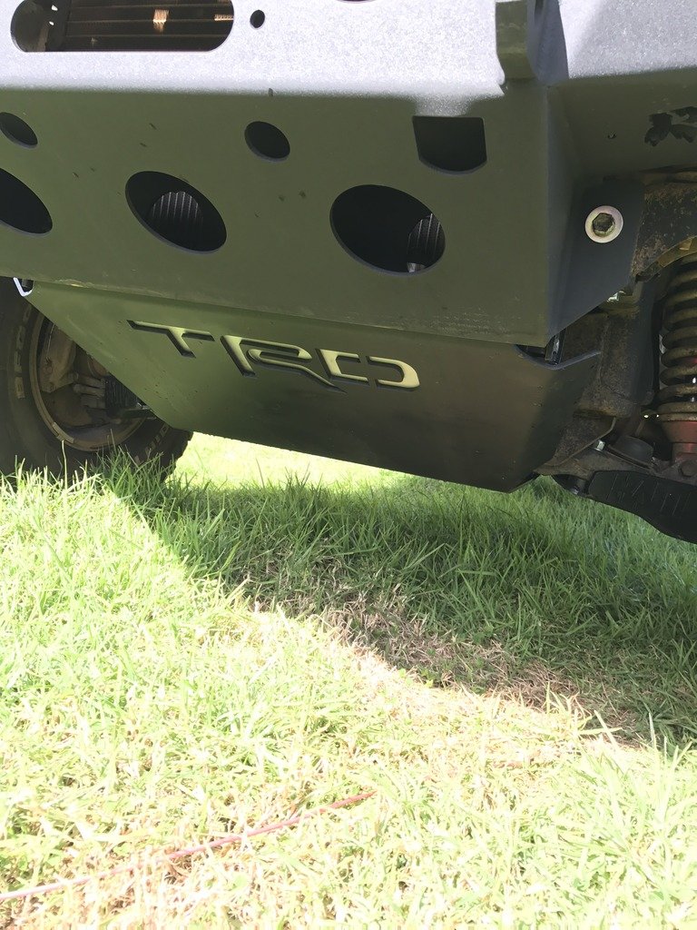

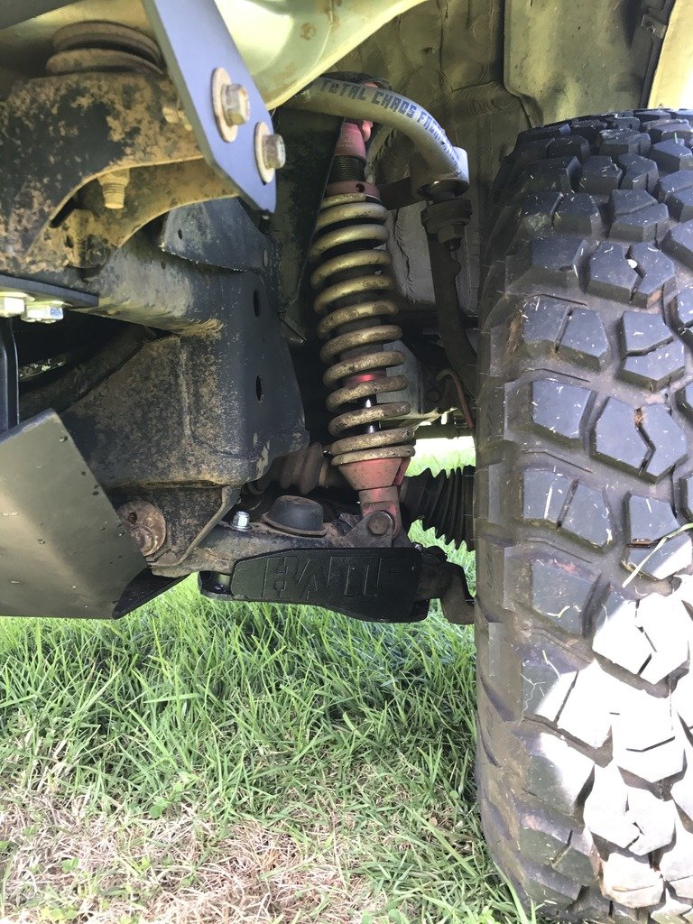

    finally posted pics of my bumper and skidplate set up.
