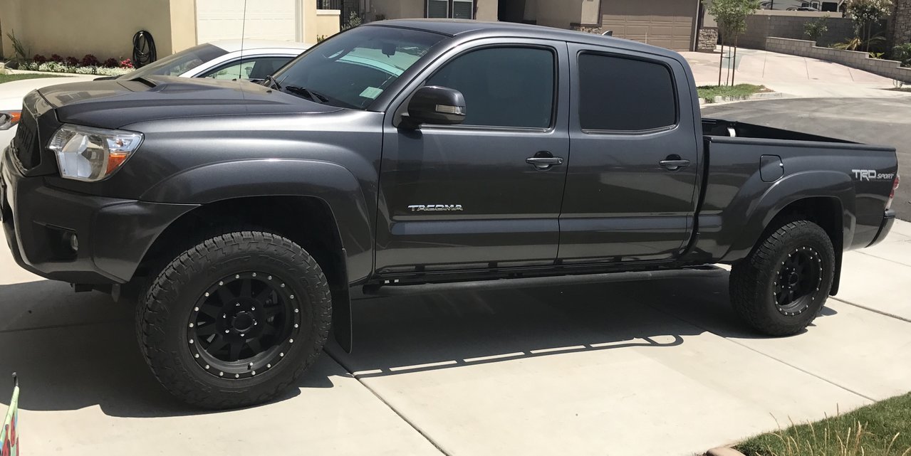

    I got the sport edition did not change rear at all and added off road tires so got a total of 3" lift front 1 in rear from front 5100's and rear tires. I have 2015 with dclb with 20k miles. Did the mod with 1000k hasnt changed at all the way it sits. The cost was only 350$ For the front 5100's installedplus the wheels and tires. This truck sits perfect now. IMG_5538.jpg

    Nothing. The new tires added an inch overall so rear lifted about an inch. Front about 3" total with 5100's and tires. When you look at truck u see a very slight lean to rear which is exactly what i wanted. Total cost 350$ install of 5100's front

    How is a "slight lean to rear " comparible to a bro lean? The truck lift shop said truck is now perfectly level. Although appearence of a very slight rear lean which is odd if its a perfect level. This is exactly how every person I personally know levels their tacoma. This shop does every tacoma that same way as well and is a very reputable place where i live. To whoever asked what their set at its just below max cause they said max could comprimise the trucks existing peices and cause issues. Its been done 3 years now no issues of alignment or anything. Crown toyota dealer maintance guys compliment me every time i drop it off. I guess they just like that compton bro lean

    Dont know all i know is the lift shop took specific measurements said im sitting level. Not sure what those are since it was so long ago. Whether they are right or wrong my front sits higher now and i gained an over lift from the 5100 and upgraded a/t tires. No spacers or anything else was added. Sometimes i wish i did a lift with 4" front 2" rear to sit just a tad higher but wife has hard time as it is getting in from just the level.
