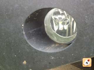

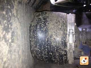

    I used some rubber, 4 inch pipe fittings. Something like this
    fitting
    But the 4 inch version. One side hooks on to the bumper. On the other side cut a hole and a slit. Use the metal clamp to secure. Mine have held up flawlessly for about a year

    Still going strong. I need to rotate them about 10* passenger. Light output is good. I've since done the anytime fogs. I like it, works good
