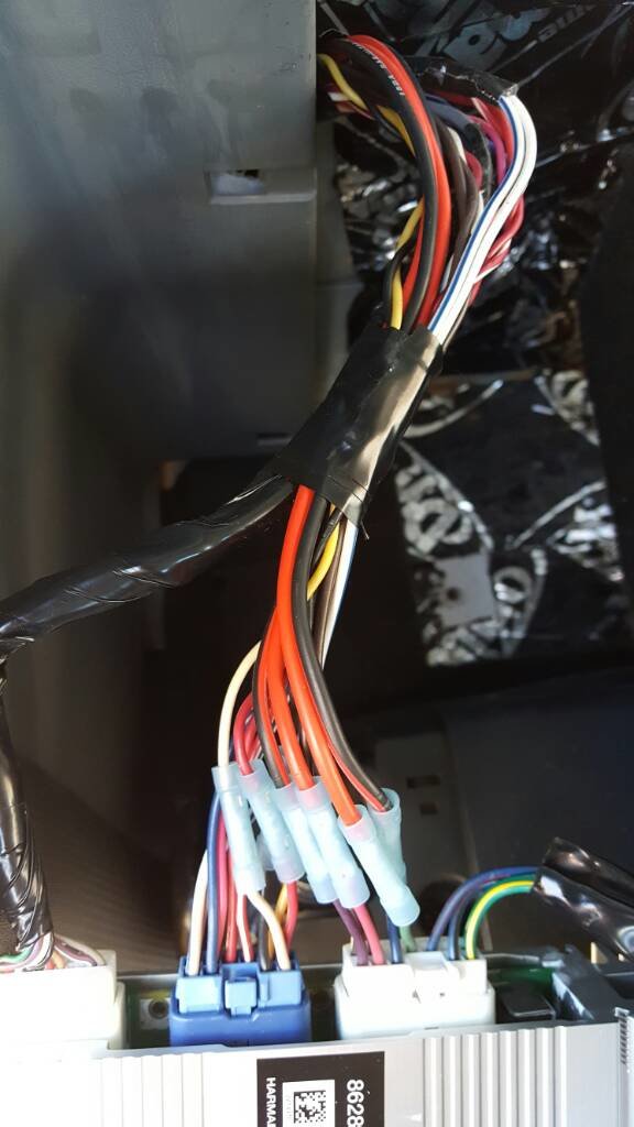

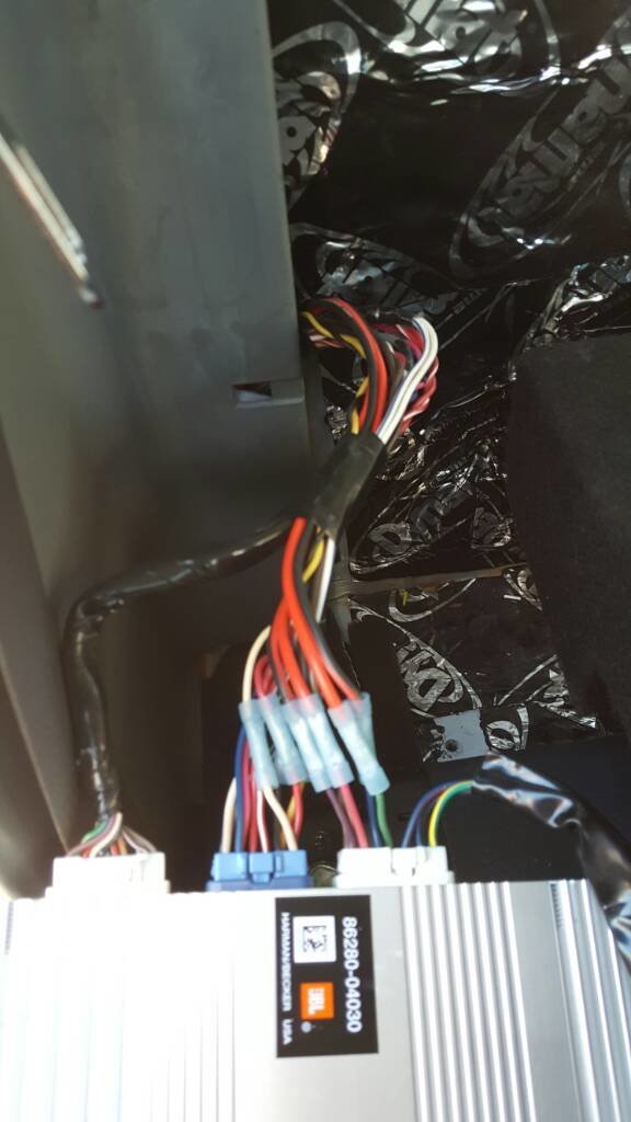

    the stock jbl speakers currently run off a amp, if you choose to bypass the stock amp completely you can run any amp. At that point you might as well R&R all stock speakers, should you choose to replace the amp you can;
    1. rerun new wires to all the speakers
    2. use the wires already in place but splice into the harness that plugs into the jbl stock amp
    hope that helps!

    You can add an amp but it must be after the jbl amp. I've done this. If you remove the jbl amp, you will get no sound.

    Bear is correct you tap into the harness shown with the connections it's the wires coming out the amp that carry the power to the speakers

    I intend to sum the Fronts/Tweeters/Sub in the Main CH of an LC6i and run the 4-Sub wires in Ch.3, but I'm not sure exactly what wires I need to splice into and run to the LOC...I have a ‘13 JBL wiring diagram but photos would help because the diagram doesn't seem to correspond exactly to what I'm seeing in the pics I've found. The diagram seems out of order.....
    Also in messing with my stock JBL amp, I noticed the bottom-most 4-wire harness seems to be the SUB OUTPUT, but I see in others photos that they spliced out of the top two wire harnesses....So confused..
