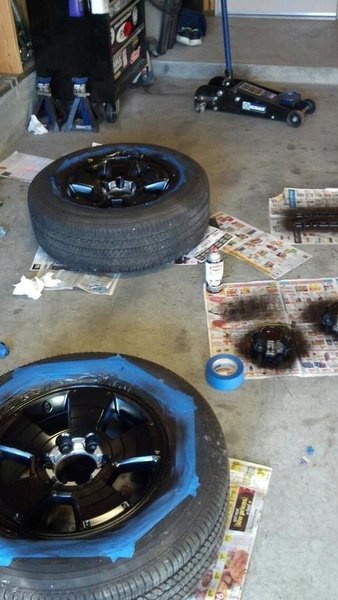

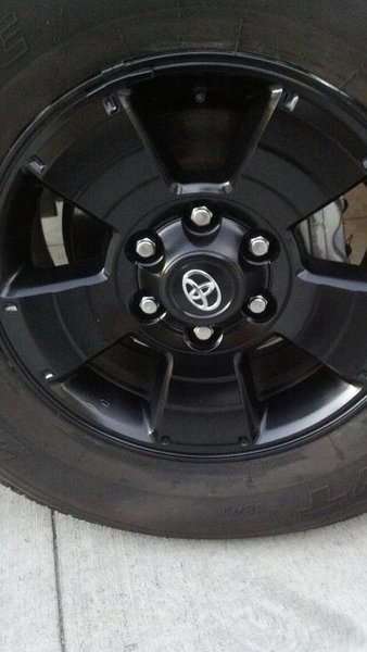

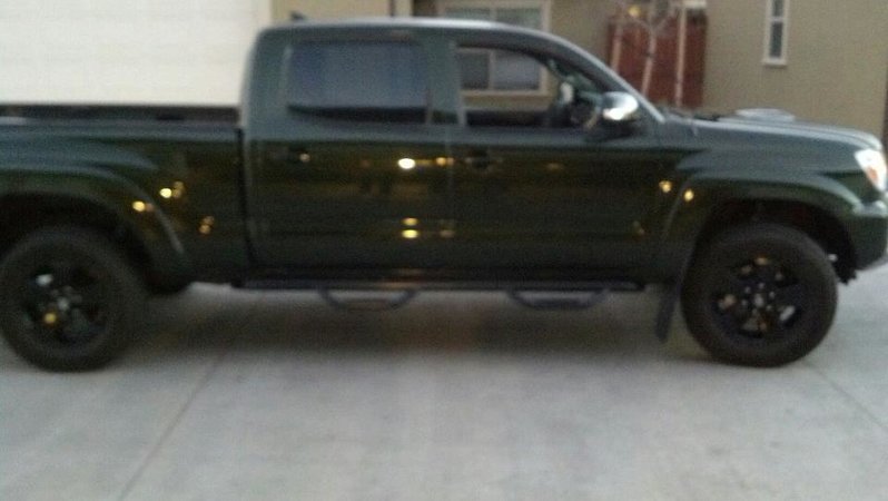

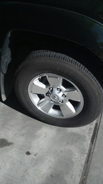

    Just did my rims today. Took some time but I really like how they turned out. I think about anyone can do it if I figured it out. Also sorry about that last picture, it was dark and wouldn't focus. More pics to come!

    So which products did you use?

    I used Rustoleum High Performance for the Alloy and Krylon Fusion for the center hubs. I started off using 600 grit like everyone recommended but it was sort of underachieving for me so I switched to 400 and they scuffed up real nice. I also popped off the center Toyota symbol off the cap. I don't know why people recommended taping it off when it easily snaps off and back on.
