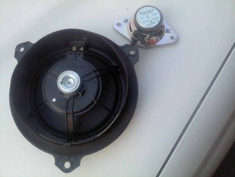

    Tom, flat out, the speakers have to be upgraded first. It'll take you like 5 minutes to pop off a door panel and pull one out. You let me know if you've seen a cheaper quality speaker in your life. See if you can get a paper clip to stick to the magnet. Unless Toyota has seriously upgraded their stock equipment, they are the worst junk ever. A new HU would be a waste, IMO. You won't get the benefit of the upgrade. I was looking at a new HU as well, and decided to change out the speakers first. I spent $100 for 4 and it was a world of difference w/the stock HU. To the point that it was good enough for me and I skipped on a HU upgrade, just plugged into my aux port and it all sounds great to me. Audiophiles may take offense but it doesn't take much to improve the stock sound in a big way.

    For anyone who doubts this, here's the stockers from my '08 RC Base...
    The magnets are not strong enough to either repel or attract the other speaker.
    I can stick the tweeter to it and lift it by the tweeter.
    Lifting the main speaker barely lifts the tweeter.

    I never bothered to pull the tweeters as I wasn't gonna pay to replace em, but damn if the tweeter doesn't look more substantial compared to the woofer! Mine were the oval woofers, 6x9 I think, but just as shitty as that 6.

    My thought as well... but I went with the Polk DB6501 component system because even with the fairly substantial tweeters (and 17w being enough to handle the HF through a crossover from a decent HU), the system was completely lacking in HF.
    News radio on AM sounded good, FM voice fairly good.
    Music? I have my treble at +5 and I had bass at -5 to get tolerable EQ... and it was STILL too bassy and muddy.
    Now with the Polks I've got the bass moved up to -3 and actually enjoyed listening to KLOS and KROQ on the way home today.
