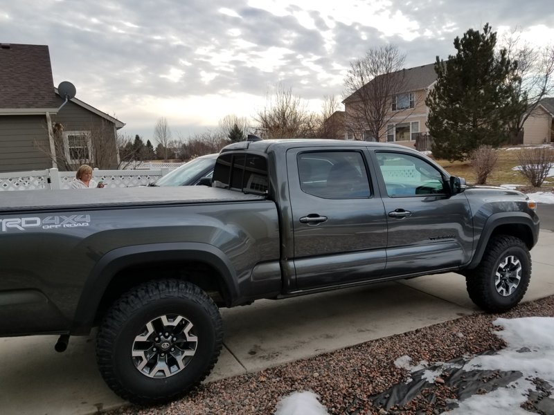

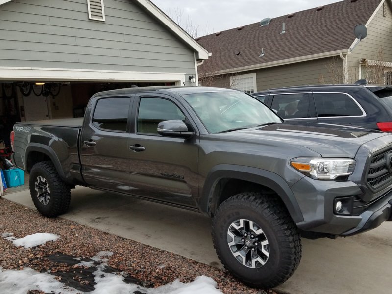

    Yes, the inch spacer eliminated all of the rubbing. The tires never did rub on the cab mount, just the plastic on the rear part of the front fender flare. Now, I get no rubbing and the tires sit flush with the edge the flare giving it a nice stance.truck1.jpg

    Sorry but just to be clear, this pic is with no lift. Only 1 inch spacer. Correct?

    Yes, as it sits, there is a one inch spacer in the front and a 1 inch block in the rear.

    Sorry but I am not sure what you mean here by spacer. Are you running a wheel spacer or did you add a spacer lift to the front coils (of both?)? If you did add just the spacer coil lift could you share which exact manufacturer and part. I greatly appreciate the information. I too am interested in running some 255/85/16 tires on my 3rd gen trd/OR and am trying to get some insight into the requirements. I really don't want to add much lift due to the loss of down travel.
    fwiw I posted many months back about running this exact size tire (255/85/16 on oem wheels) and had several replies that it would require minimum 3 inches of lift and possibly a CMC.

    I have wheel spacers installed along with 1 inch coil spacers up front and 1 inch blocks in the rear. I will have to look for the manufacturer, but the coil spacers were exactly 1 inch thick which nets approximately 1.5 to 1.75 inches of lift in the front. This combo is working well until I get the coilovers I want.

    Many thanks for the clarification. Your truck looks excellent with the setup. Last question were the wheel spacers required for any specific reason with your setup other than just cosmetics? As mentioned I too have same setup in mind that you have (running same stock wheels) but really did not want to run wheel spacers.

    The wheel spacers made it rub worse. I only installed them to improve the looks.
