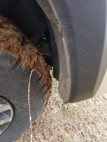

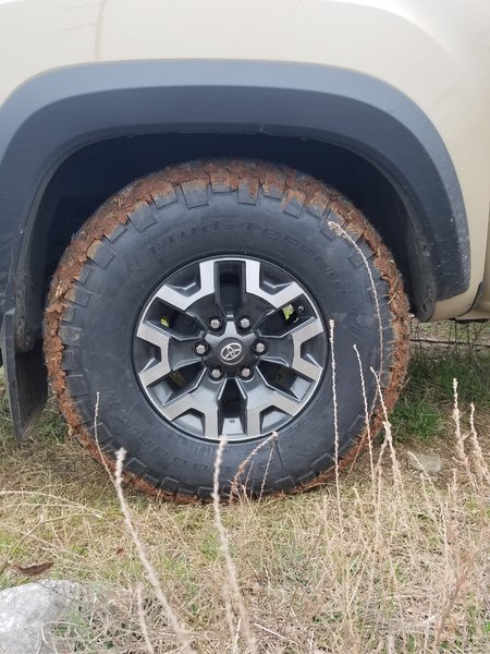

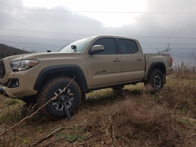

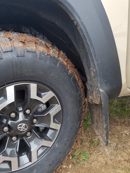

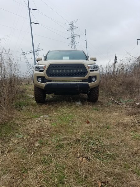

    I rubbed twice all day. Once entering a parking lot that had a v shaped drain and I was going fast into it. Second was when I went too fast throuhg the trail and hit a bump too hard. I really think both of those rubs were from tire deflection. I may be mistaken though. When I was crawling i turned my tires atleast 80% at one time going over mogul and moderate rocks, never once rubbed. I flexed out all the way intentionally another time and didn't feel any rub what so ever. I've never had a true set of mud tires. And these things walked through water and mud up to my diff. I'm a happy camper and To say I have a chub is putting it lightly.
    Pic dump to come.

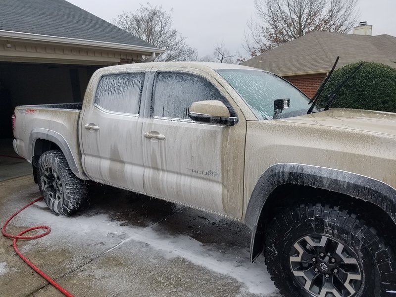

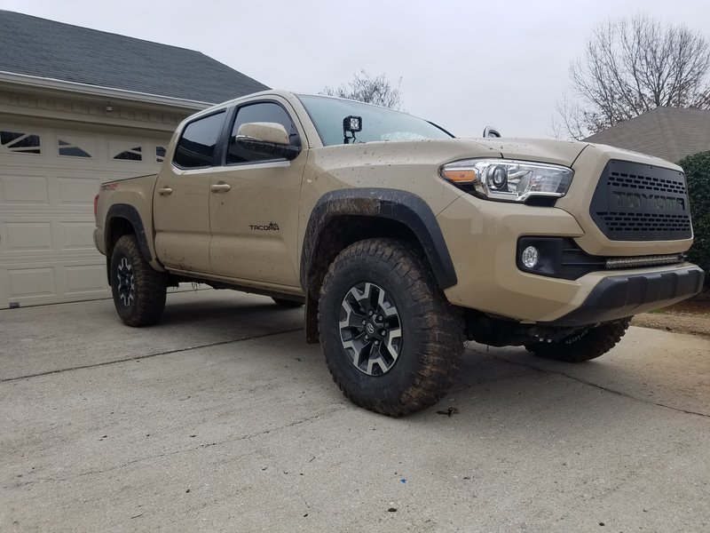

    And my inner detailer couldn't leave her muddy.

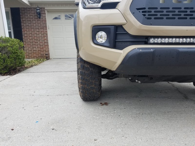

    Is that 33's on there? How much lift?
  10. Jan 25, 2017 at 1:55 PM
    #70
    Sandytaco14
    Sandytaco14 IG: qstaco17
    Nov 16, 2016
    #202580
    5,641
    Andrew
    North al
    '17 trd offroad 4x4
    Yes, and no lift.

    Super minor rubbing even with your mud flaps? Well then... this thread has officially sold me on a tire size. I'm a big fan of the KO2's however they're not made in this size. As bad ass as the KM2's are, the snow in Colorado doesn't play nicely with them for everyday driving. Looks like Cooper has themselves a new customer!

    I know. I really really expected to have a decent amount of rubbing today. So I get to keep my front mud flaps, and a awesome set of tires that gives me an 1" better ground clearance.

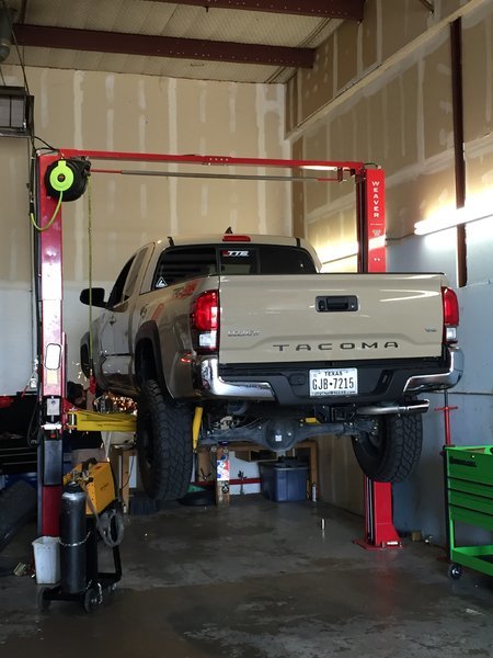

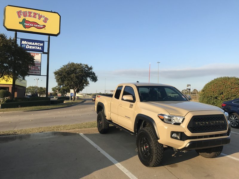

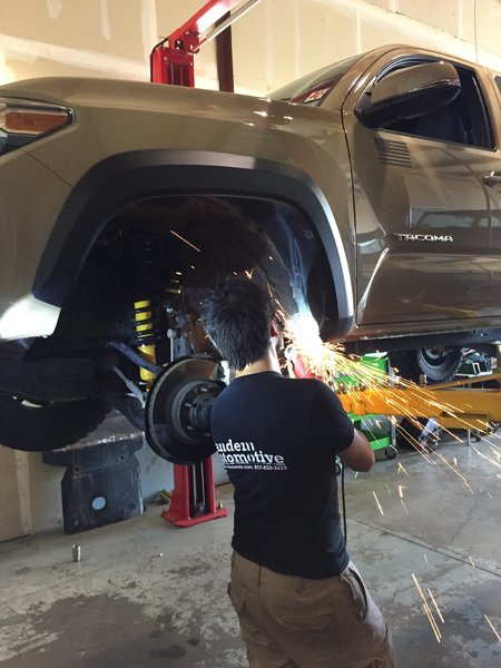

    255/80/17 3" OME suspension I had to do a CMC on my driver side rubbed at full lock. IMG_7833.jpgIMG_7433.jpg IMG_7436.jpg
