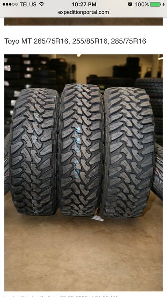

    Here's a good side by side shot for you.

    This is super helpful. Thanks for doing that.

    Thanks for sharing!!
    Do you think if the 255 fits the 285 will? I don't even think bfg has a 33" option for anything less wide than a 285...

    A 285 is about 1.22" wider than a 255, so you'll have over a half inch on either side of the same wheel size/offset.
    In other words, it's going to rub. You'll need a mild lift and/or some cab mount chop and some trimming/hammering.

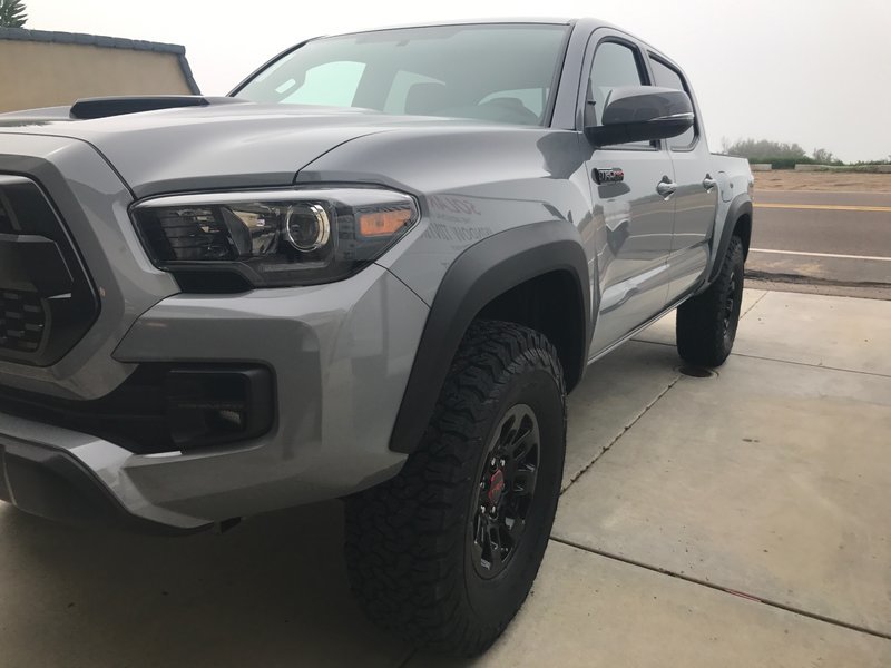

    Went with the ko2's, 285 75 16. They fit no problem at all. Look insane!!!

    Any rubbing at full lock or under articulation? Gone wheeling with them yet?

    I noticed very light rubbing once when I was in full lock and quickly reversed. Going to the dessert this weekend and will let you know how that goes. From talking to others and from what I'm experiencing if you stay on road is not an issue, if you off road you need very light trimming

    So what is the prognosis? Was there rubbing at full stuff and if so, how much?

    No rubbing really ever. When you back up quickly in full lock and hit a bump you might get a tiny rub

    Looks great, thanks for the feedback, those will be my choice if I keep my truck - love it but have a family of 6 kids and wife had to get a lease vehicle - arggh

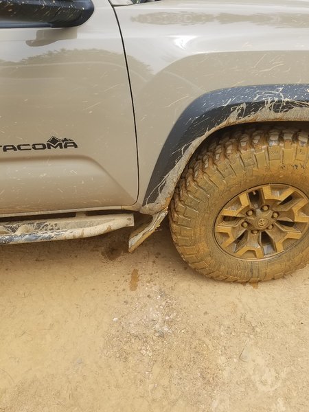

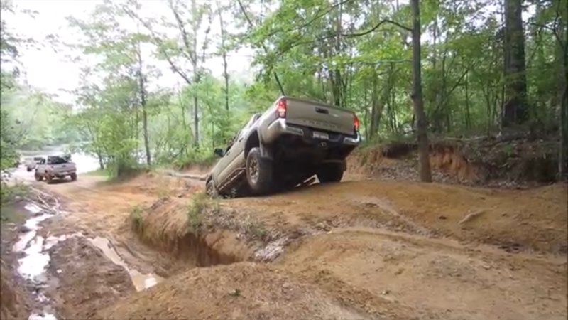

    Dragging it back up again. The rubbing was on the front mud flaps only. How do I know? Because I bent my passenger side mud flap back to my slider and cracked it, took both off and now no rub whatsoever. And I'm 1.5" lowered in the front running sliders and full mobtown skids. This tire size on stock wheels are perfectly fine even at full flex (See pics)

    ahh the old toyo mts
