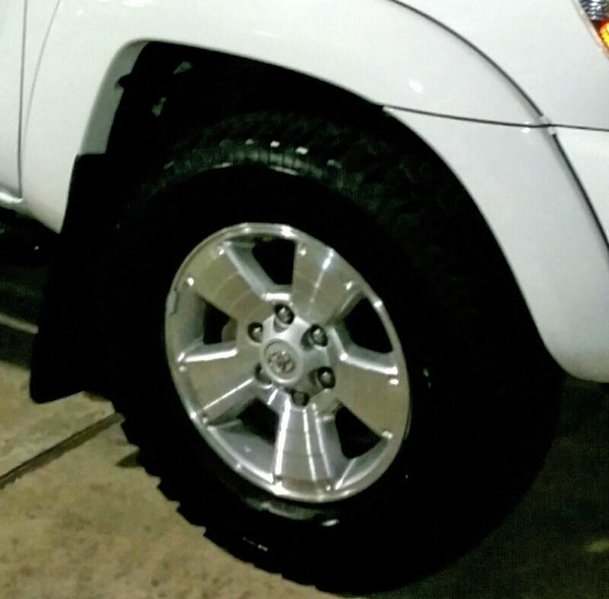

    Have anyone painted or get these type of stock rims black?
    Flat/gloss?
    If so, any pics or suggestions can share please? Thanks

    I've painted wheels before. You have to rough up the wheel surface with sandpaper, degrease the wheel surface, tape off the tire, prime coat, multiple paint coats, last multiple clear coats. Automotive wheel paint works fine.

    Yes. Thanks Chris. Looks like a gun metal color. Nice.

    Once you paint them, you can't go back.
    Are you better off selling your stock wheels and buying something else??

    Or you can plasti dip them.
    I did that and its been close to a year without it peeling off. Have to reapply on the lugs whenever the wheels get rotated though.

    When my OEM tires need replacing, I'll take my rims to have them powdercoated. I've done this with other cars, and I can tell you, the finish is like armor. A powdercoat shop will do the blast and prep in house, and you can choose the color, sheen, and texture. Not cheap, but you get one off wheels for a hell of a lot cheaper than any new wheels on the market.

    Like you said it's not cheap in comparison to painting your wheels with spray paint, but I've seen prices ranging between $40-50 per wheel to have them powdercoated. It's not bad considering how durable the finish will be in the end.

    I'm looking to paint mine too. My mechanic suggested powdercoating instead of painting. Called the local powdercoating shop in Athens and they said no problem BUT..
    A) they want $85 per wheel
    B) they want me to just bring them the wheels...
    Does anybody in Georgia have a better powdercoat shop?
