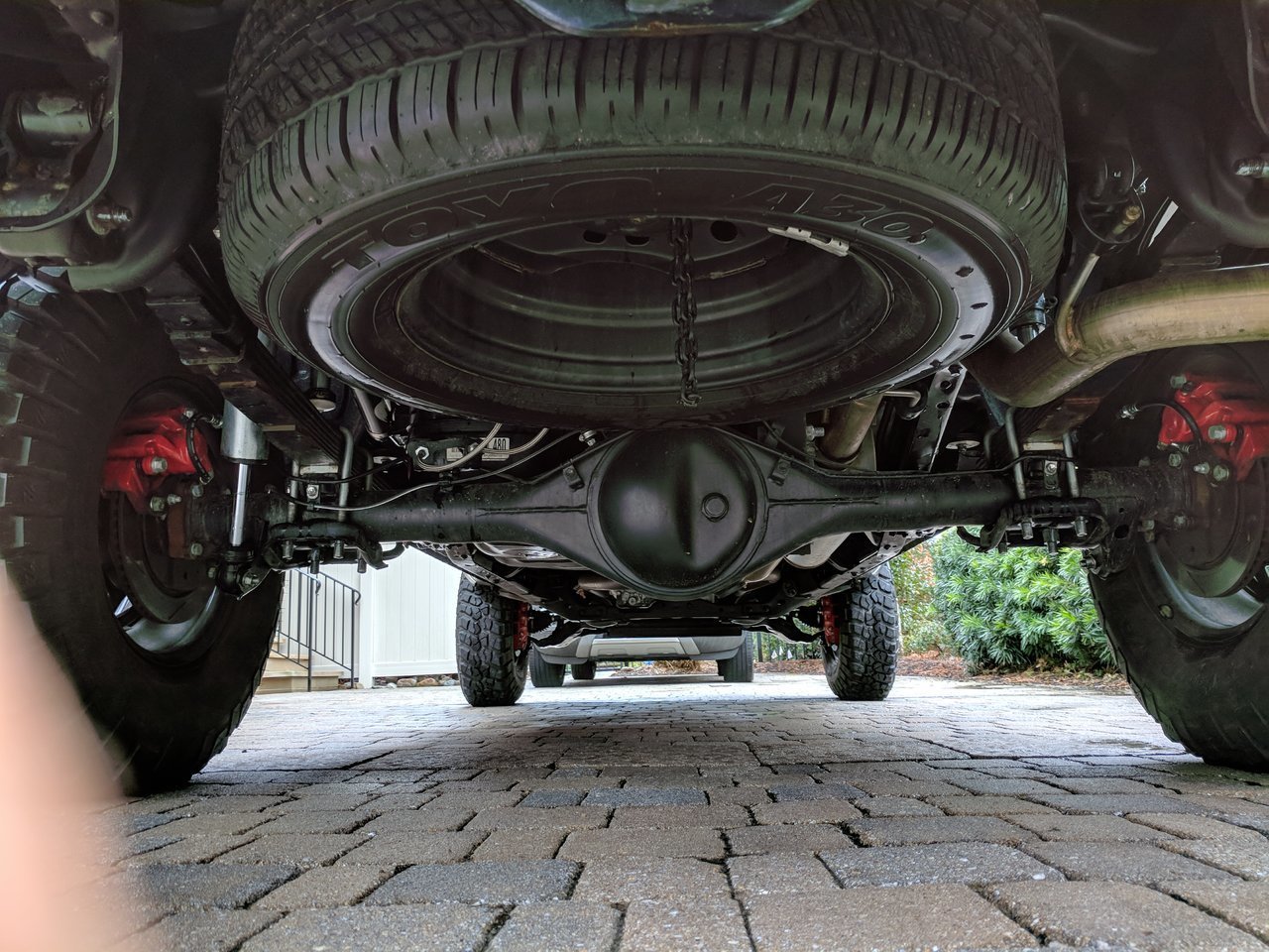

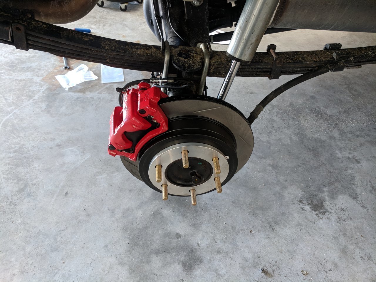

    I have done both the 6 piston fronts and the rears. The brakes will certainly function with all other OEM parts, however, it is a VERY nice addition to the kit to add the Sequoia master cylinder as well and didn't take too terribly long either. The brakes will work better than OEM without it, and then they will work a little better than that with the master cylinder installed while also giving you a really firm pedal and nice feedback from the brakes. When I did just the brakes and no master, after confirming I had no leaks and bleeding the system twice to be sure, my pedal was really weak and if I pushed hard it would go near the floor. It would still have pressure there, not like it would go straight through, just the OEM master doesn't move quite enough fluid so you end up over traveling it, which would eventually lead to its demise.
    Write up on M/C install is available through my Big Ole' Brake Upgrade thread! Post #72: https://www.tacomaworld.com/threads/big-ole-brake-upgrade-thread-for-third-gens.525568/page-4

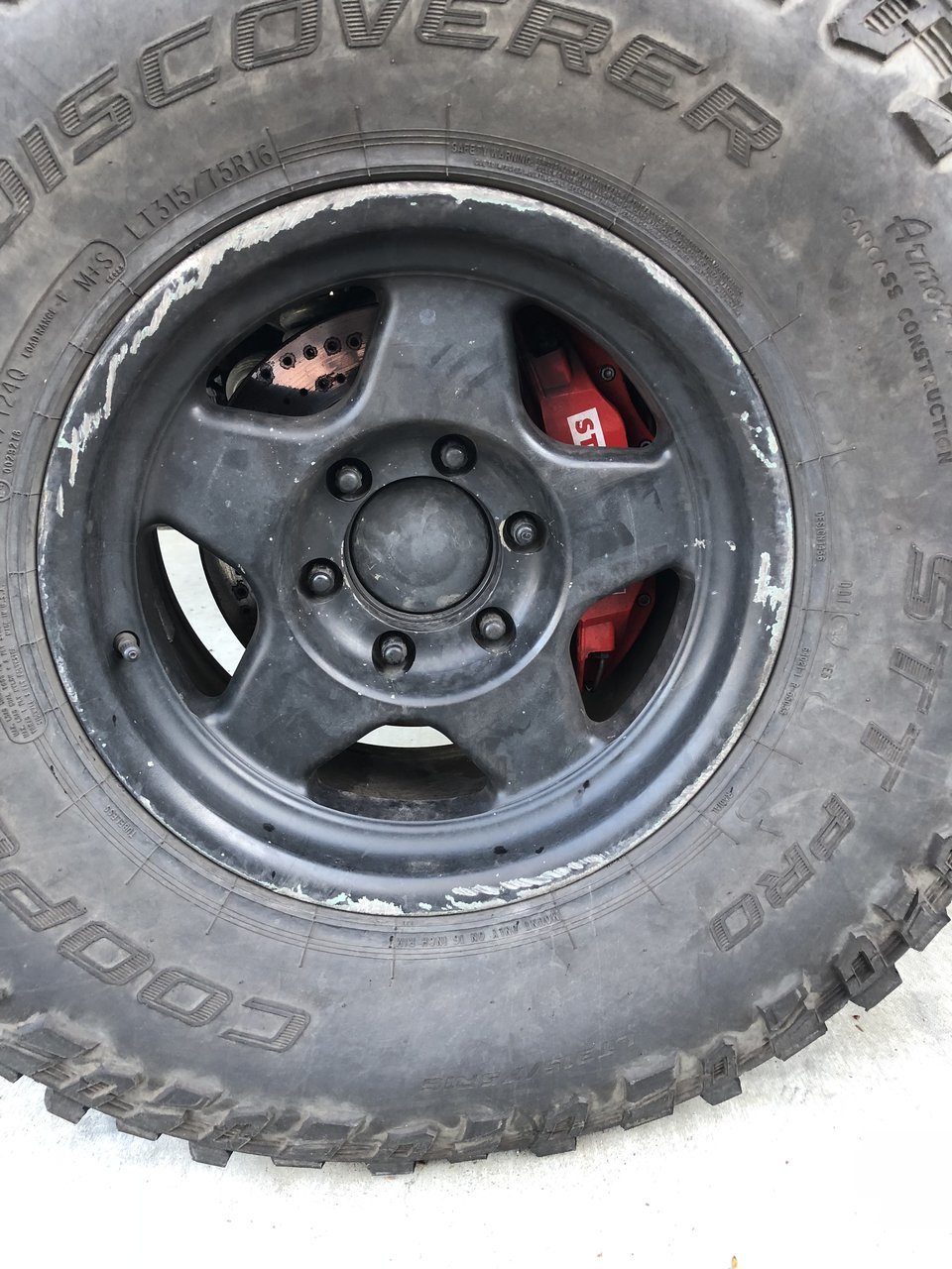

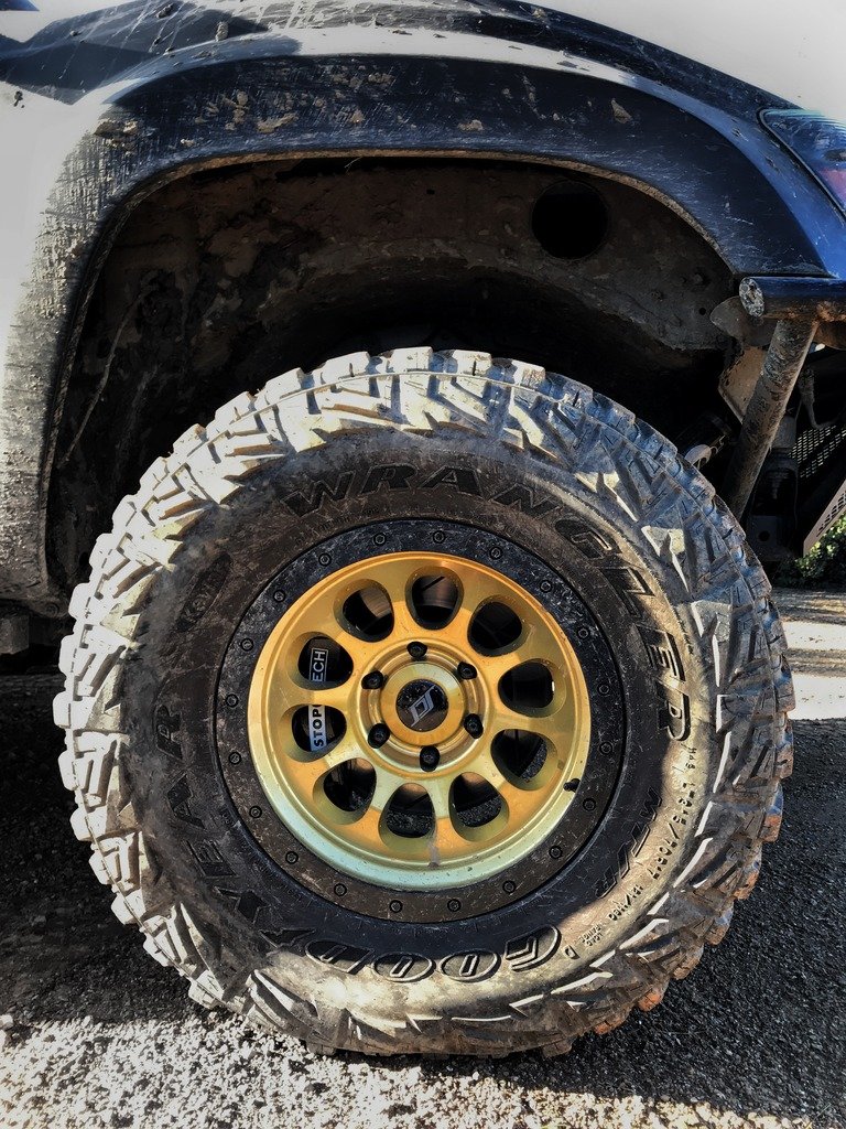

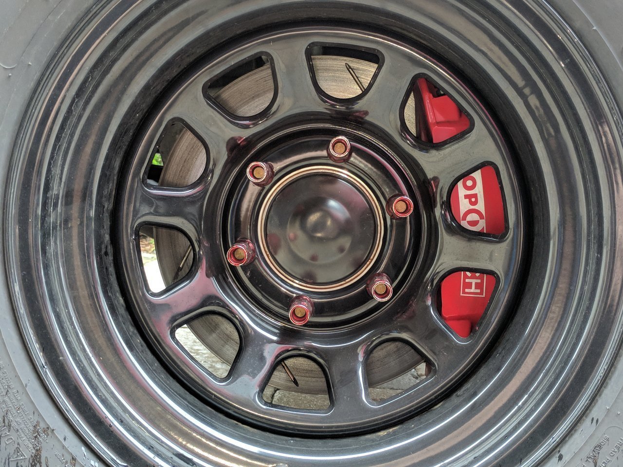

    Not SCS wheels but I have 16" steelies and it fits, barely in a couple spots but its in there and no weird noises

    No issues here, caliper is close though

    beautiful ! thanks for the pics

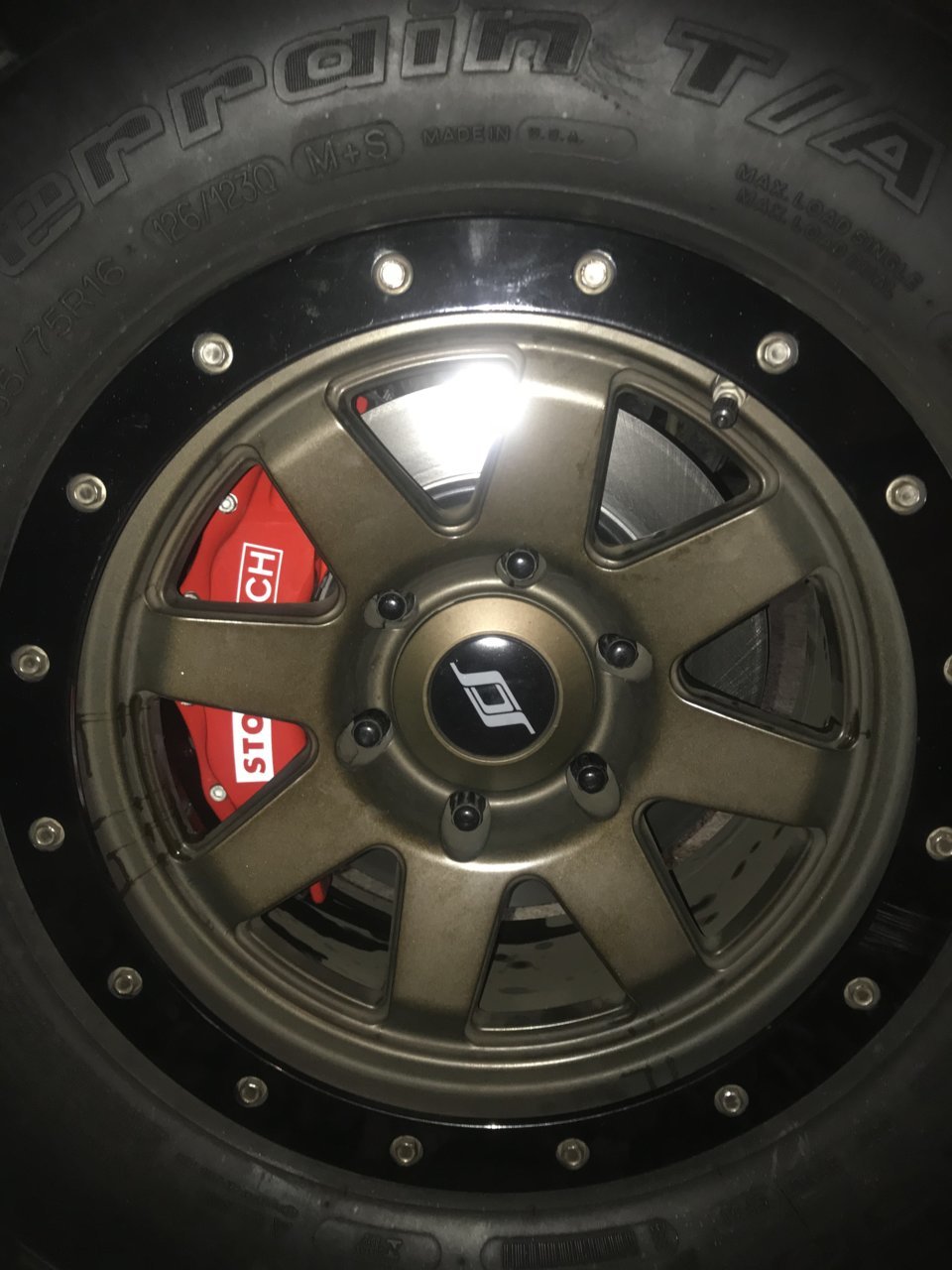

    Yeah i was being lazy. Just purchased a kit in red... gotta be a show off. I wonder if my crawl box can still over power them;)

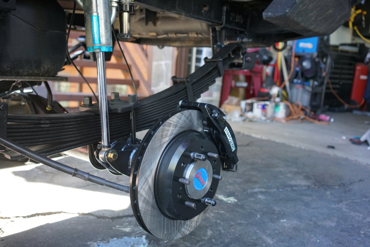

    One more...this time with the rear BBK to match the front

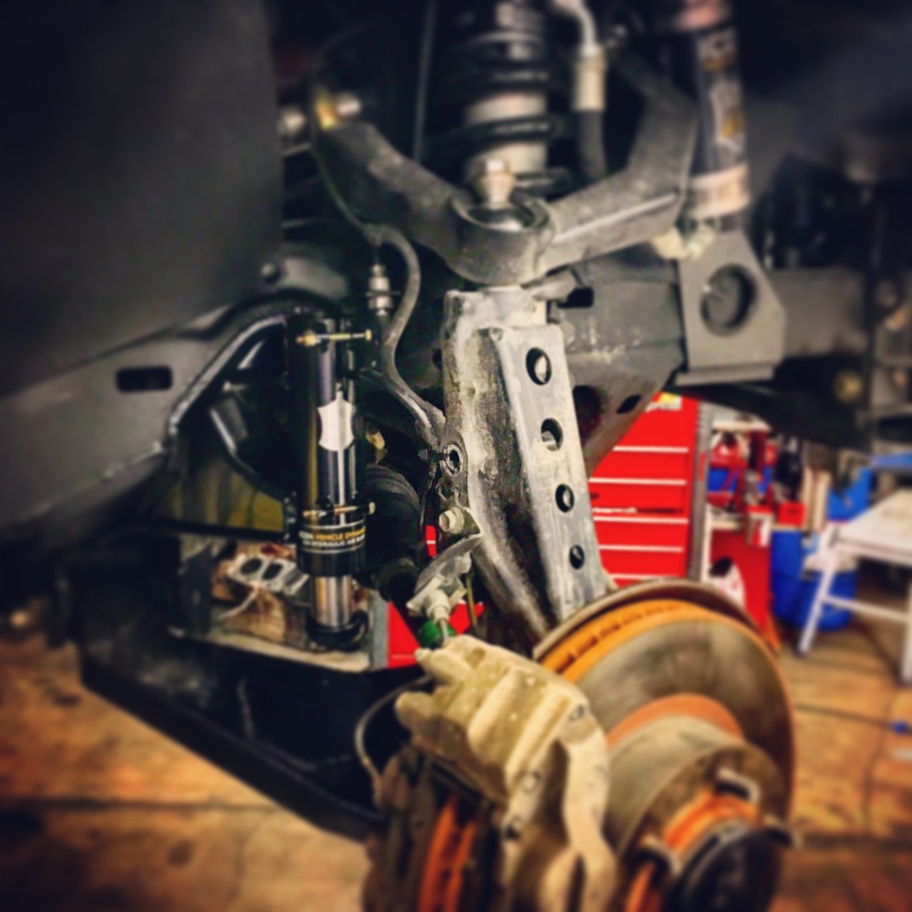

    It was an average Wednesday night. The rotor backing are working on a little dynamic machining. If the noise doesn’t go away by Saturday i will be pulling the hubs and putting in the spacer.
    Pre Stop tech
