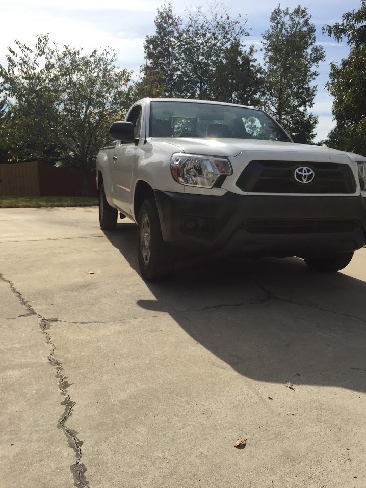

    Also recognizing that this is an old thread, here is a pic of stock steels and tires with 1" spacers on each wheel. Planning on upgrading to Cooper A/T3 30x9.5r15 in a few months.
    3MWOYHvN04_9hU2zFDmD0mt_oB-_-wWdYa2DYOf2_be92272d35fb96db35675a77e466f9fcdd8f0f3b.jpg
