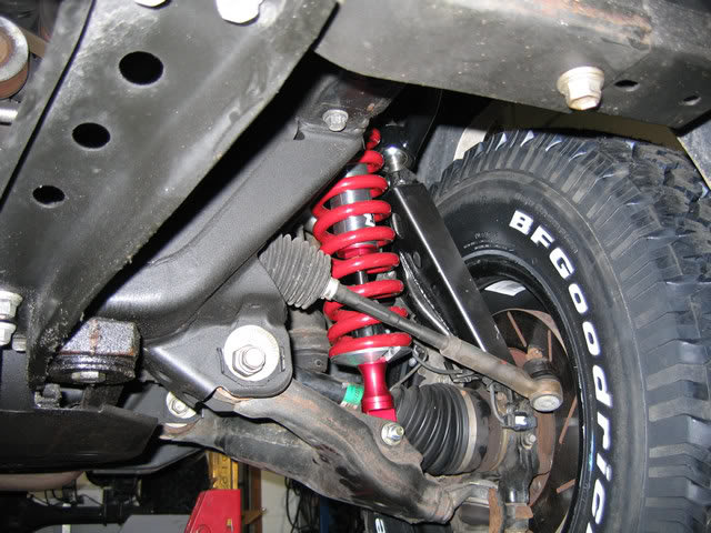

    You'll need to adjust your tie rods, but make sure you turn them the same amount on both sides or you'll throw off your alignment.
    For instance, loosen the jam nuts on both sides, screw in one side 1.5 turns, unscrew the other side 1.5 turns, and tighten the jam nuts.
    How much you need to adjust and in what direction is based on how off your steering wheel is.
    The tie rod is the shaft with the rubber boot over the inside part at the center of this picture
    You'll be turning the small diameter shaft after loosening the jam nuts. You'll see flat spots in the center that allow an adjustable wrench to grab.
