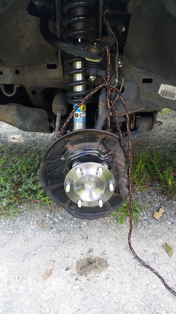

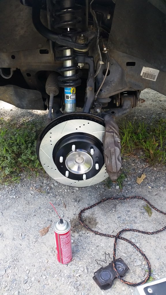

    After watching a video on how to press the wheel bearings out of the hubs I decided to purchase the whole preassembled unit and swap it out. Now I just hope this thing lasts until next week when the package arrives.
