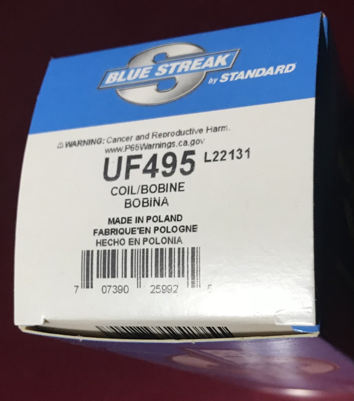

    If you have never replaced them, I suggest new NGK 6619 plugs and Standard Ignition Blue Streak UF495 coils 22BCFEDF-2C6D-4E70-AC77-3669595B8C7E.jpgreally perked it up
