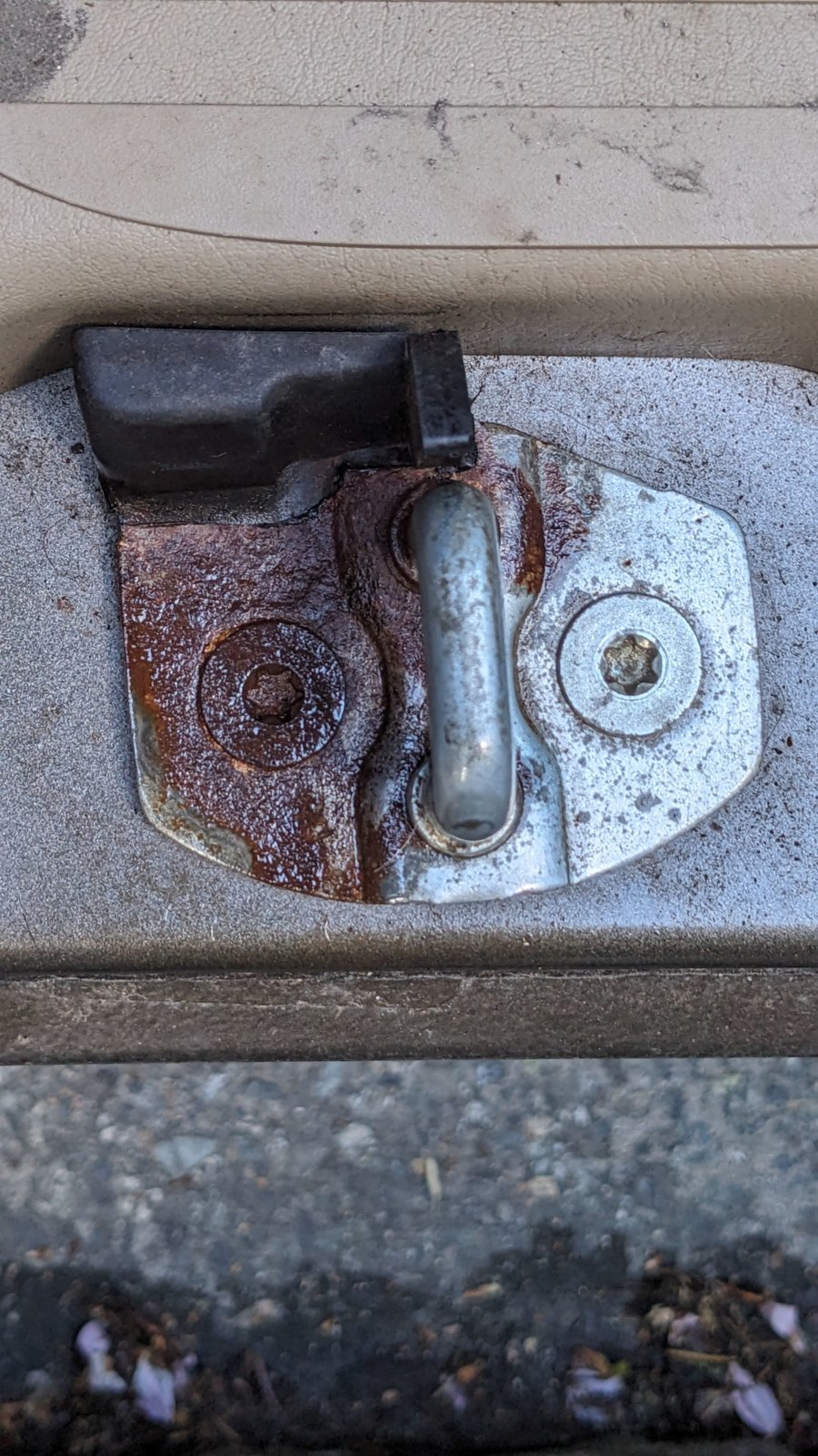

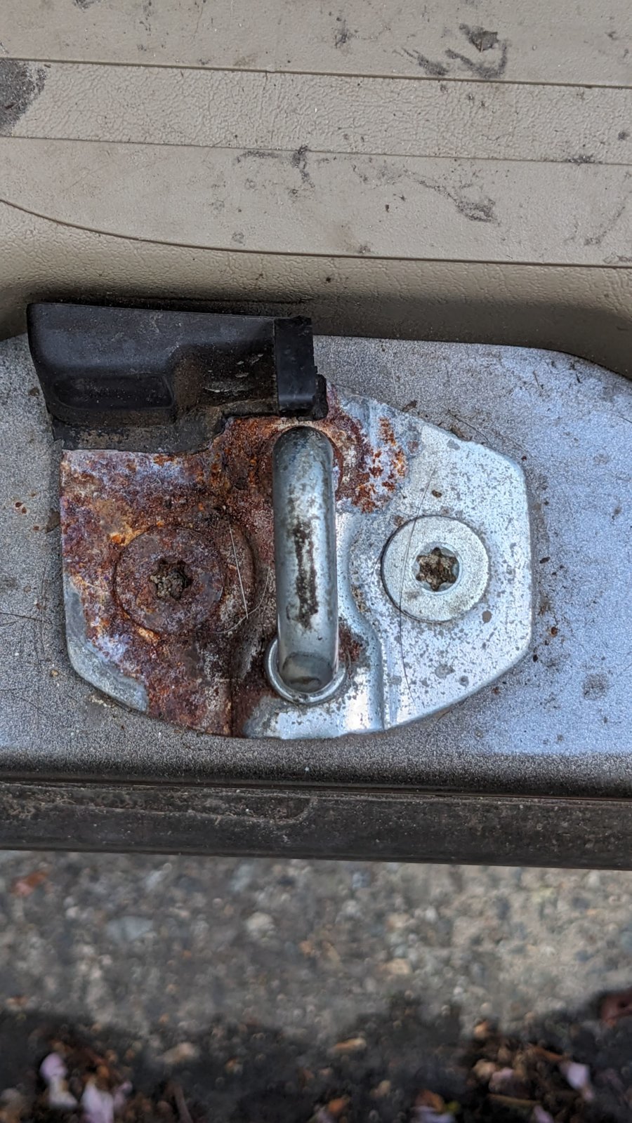

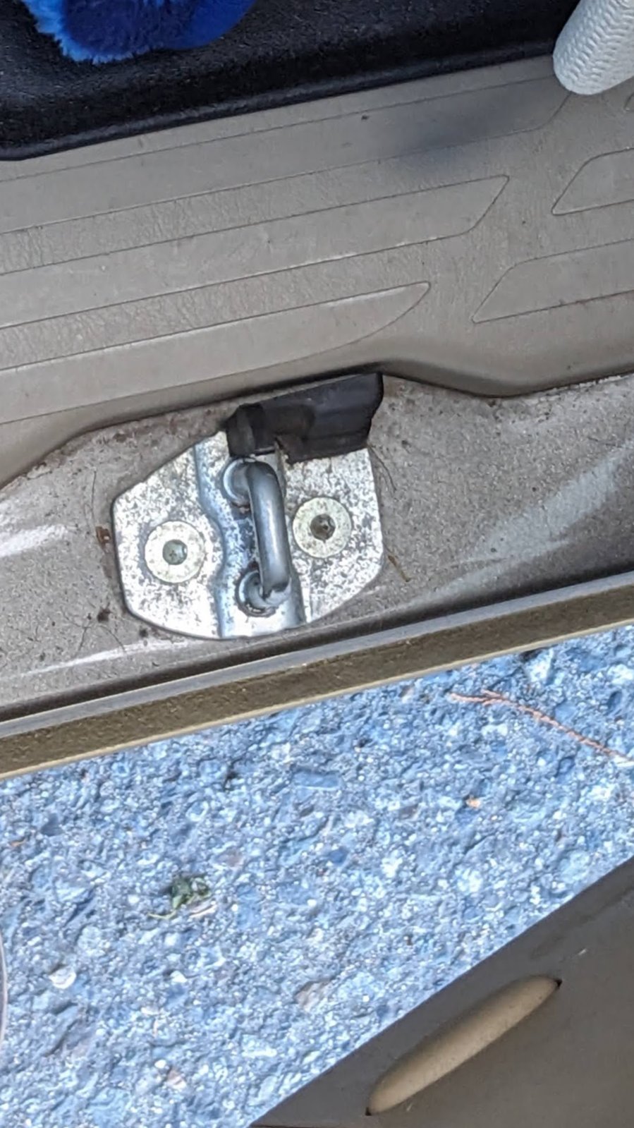

    Found this thread while looking into the reason these strikers rust, and seems the new lesson is I should leave mine alone. Sounds like the rusted bolt can break pretty easily and if not the backside that it screws into can fall into rocker?
    Passenger side has been rusty for years and driver side is fine.
    Passenger side this morning:
    Passenger side after a little bit of wire brushing then sprayed:
    Driver side completely fine:
