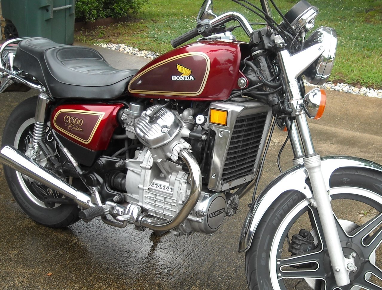

    @gearcruncher Yeah, I get that the equip is big $$$. I have all the goodies from when I painted my motorcycle. A body shop quoted $750 just to paint the fuel tank. I bought all the equip and paint for less than half and did the entire bike.
    I have compressor, HVLP spray gun, respirator (needs new filters). A tyvek suit w/booties, rubber gloves and some other small spends. My main expense will be the etcher (?), primer, paint and clear. I'll need barrels of elbow grease.
    I'm currently looking for a good stripper to remove the automotive paint from the rims (wheels).
    All the products you mentioned are used after painting. I used some of the buffing products when I polished some of the aluminum engine pieces to give a bit of shine to the bike. The polish was followed with clear coat. Here is my results.........

    Nice job on the bike . I use to have a nighthawk back in the day but never looked as nice as your CX .

    Thanks on the bike. Its an '81. It was a wrecked non-runner when I bought it. The only decals are the Honda Wing and the model name on the side covers. I'm hunting an '80-81 CB900 Custom. Talk about unicorns........
