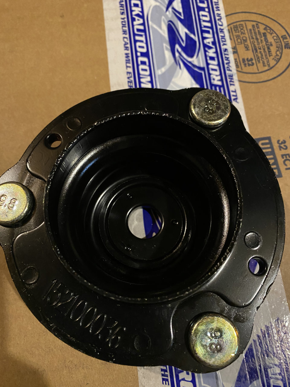

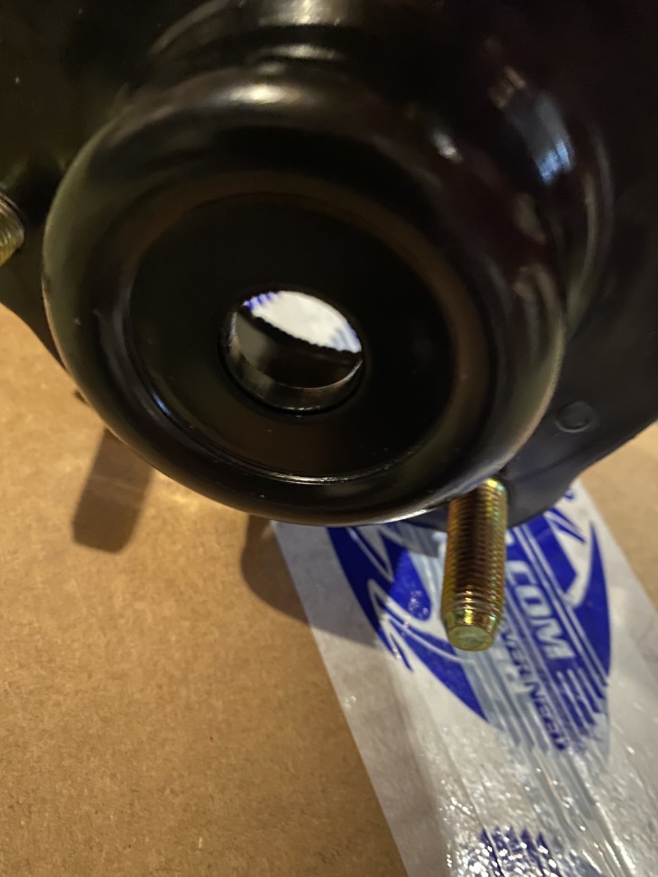

    this guy explains it. And my cheap Monroe top hats do not have rubber bushings pressed or glued on the underside

  5. Mar 13, 2021 at 10:14 AM
    Northern Taco
    Northern Taco [OP] Well-Known Member
    Oct 8, 2015
    #166156
    2,820
    2022 Tacoma trd off road premium 2023 tundra trd off road
    One more. Also bilstein cheaped out and now does not include rubber bushings/washers for the front 5100’s like they do for the rear 5100’s wtf?

    so to answer the question, are the top hats suppose to come with a rubber bushing that is 1) either pressed into the underside of the top hat or 2) a rubber bushing I placed under the top hat myself?

    My TRW tophats came with the rubber bushing molded into the bottom, just like OEM, and the tophat in that video you posted.

    Oops. I guess my tophats were KYB. TRW, KYB, they both have 3 letters and aren’t Monroe. LOL
