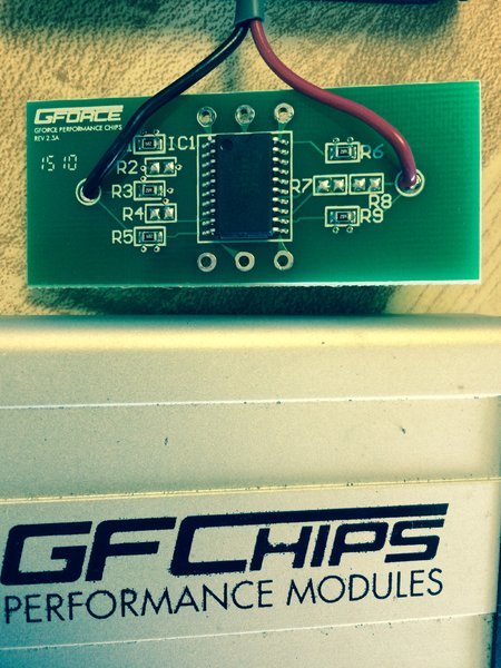

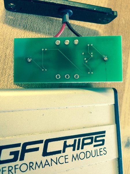

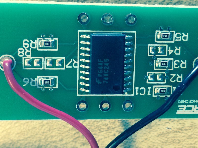

    Ok. I read all the bad press about GForce performance chips. I took it off and installed the PCN chip I ordered. Turns out the GForce chip didn't need to be "cracked" open because there are 4screws holding it together. I took the above pics of what was inside. I'm not an electronics expert by any means, but I do know that this is more than a resistor which everyone was sure was inside. I'd like someone who is knowledgeable in electronics to study these pics and tell me what you think this circuit board is supposed to do.

    It's supposed to take your money. It's a cheap double sided PCB cost about $2.50 to make at most. Doesn't seem to do anything..you got hot and ground to power the transceiver but what is it supposed to buffer? I'm not sure if you listen to the suggestions made before that you're getting ripped off with these products. It's almost to the point of being laughable... sorry to say.
    Just google 74AC245 as labeled in the picture and get a fairchild datasheet or equivalent manufacturer's datasheet to show you it's just bidirectional buffer. No extra logic or intelligence to make more HP.
    If you can and do yourself a favor and return the other chip as well... I can't believe people don't get arrested for this kind of scam.

    You have an ohm meter? Measure the resistance from the red lead to black lead. I bet it just offering resistance across the leads.
