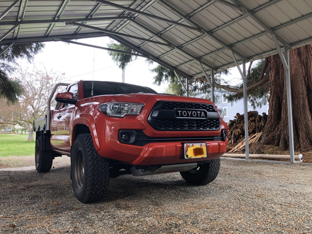

    Okay, better late than never.
    My truck was built in San Antonio on February 14th 2017
    Sport Manual transmission AC
    Tires, Wheels, Drivetrain, Suspension:
    • General Grabber ATX 275/70 17R
    • Koenig Countersteer 17” Bronze from FN wheels
    • Falcon Sport Tow/ Haul 2” lift
    • Total Chaos upper control arms
    • Dobinson Rear leaf springs Hilux heavy load, with Dobinson bushings
    • Firestone Riderite Air Bags
    • Air bag mount support plate
    • Cab mount chop
    Performance:
    • TSB 00062-18 - Stumble Fix, ECU Update
    • OEM Toyota Exhaust tip
    • Exhaust chop reroute with a heat shield
    Exterior:
    • Southern Style Off-road Slimline bumper plus Stage 2
    • Smittybilt X2O 10,000lb winch
    • UTE bed made by Triple M with black powder coated sides
    • Viair Heavy Duty onboard air system
    • Optronics STL211X brake/ reverse lights
    • GE Megalight ultra H11 +130% 53110XNU
    • Morimoto fog lights
    • Caliraised ditch lights
    • KC400 spots
    • DJI single row led light bar 12” in the hood scoop
    • Rounded fog light surround ( Canadian style )
    • Redline Tuning hood struts
    • Relentless Fab Hood Hinge Ditch Light Bracket for HAM antenna, connected to a BaoFeng handheld
    • OEM Pro grill with bronze lettering
    • Hella Sharptone horn 922000731
    • Meso custom black turn signals
    • Homemade 8.5 gallon grey water tank
    • Diff. breather extension
    • AC drain mod
    • @rrentrop Side marker blackout
    Interior:
    • Husky front and rear floor liners
    • Vehicle OCD Glove Box Organizer
    • Vehicle OCD Console Tray
    • Subaru Tweeters
    • Crutchfield Kicker 43CSC674 Kicker 43DSC69304 speakers
    • Xcel Nano Ceramic Window Tint
    • Mobius 2 camera as a dash cam. mounted on the GoPro mount with an adapter from Shapeways.com
    • Dashboard Blackout Premium Vinyl Decal Kit
    • Speed dawg shifter knob
    • Meso Customs fuse cover
    • Meso Customs red map lights
    • Meso Customs dome light
    • Meso Customs headlight trim plate
    • @rrentrop dash blackout kit
    • @rrentrop Glovebox letters
    Electrical/Wiring:
    • Homemade aluminum panel with Blue Seas fuse panel and 100 amp breaker
    • Backup camera mod
    Camper :

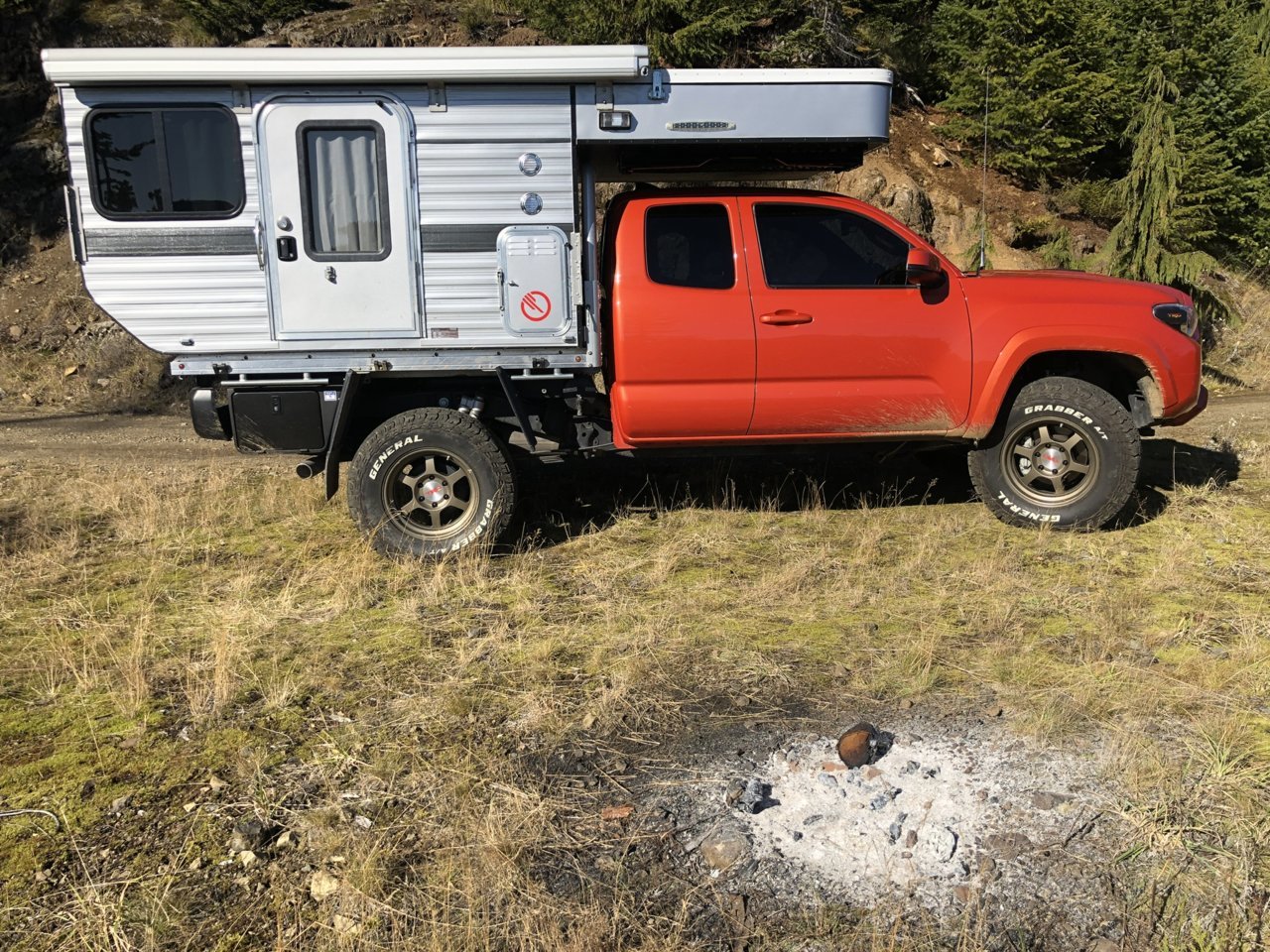

    Fourwheel Camper Fleet Ute 2018
    Silver Spur package
    Winter package
    Redarc charger
    Fiamma F45s awning

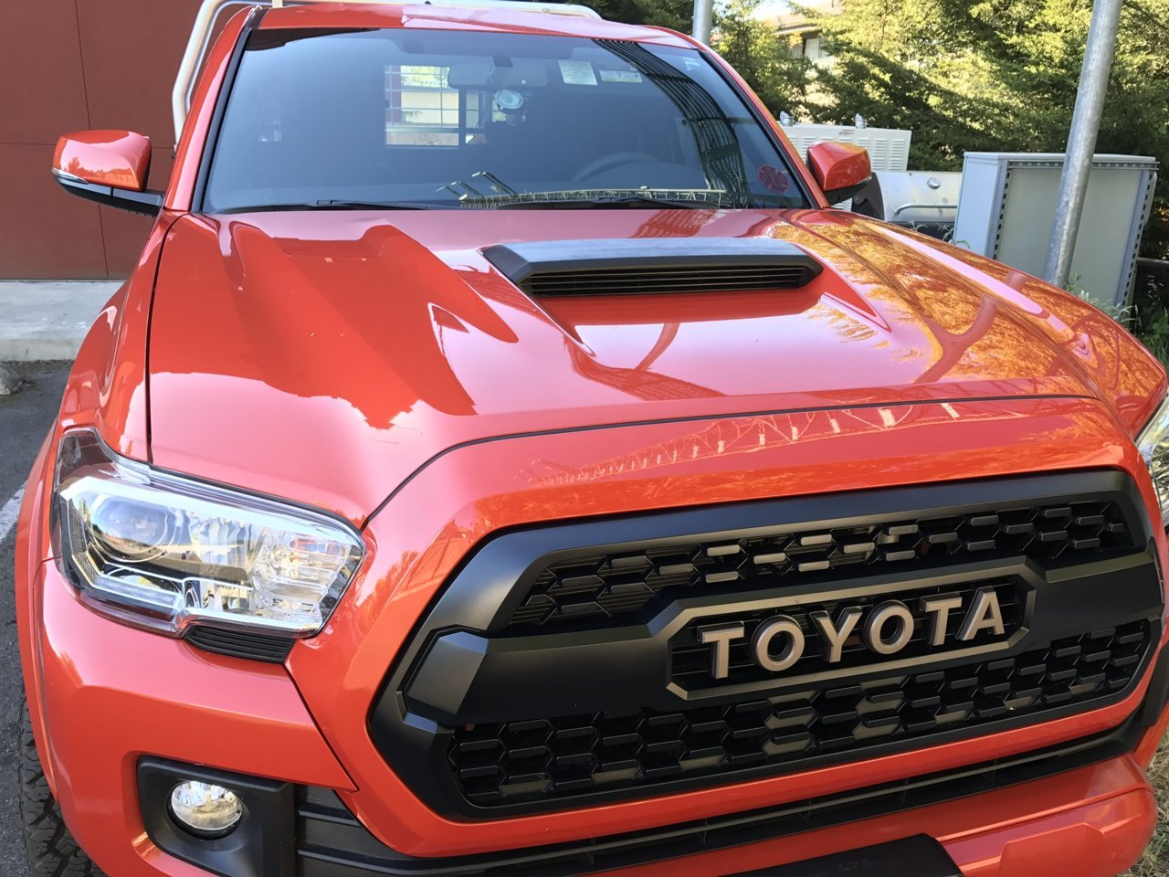

    Swapped out to the Pro grill and spray painted the grill lettering bronze to match the wheels. Plasti-dip the hood scoop black.

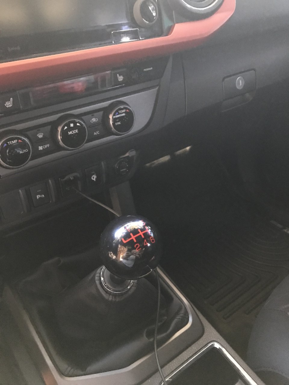

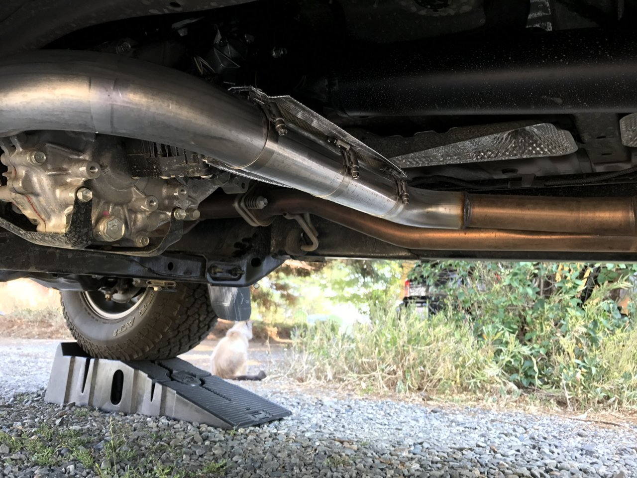

    Exhaust re-route with heat shield
    Speeddawg shifter knob
    Way more comfortable.

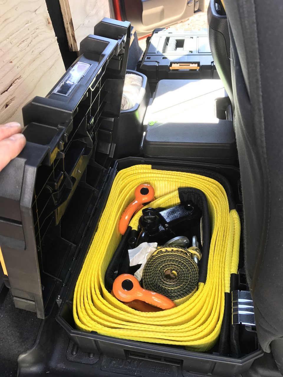

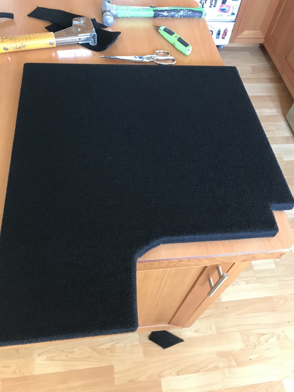

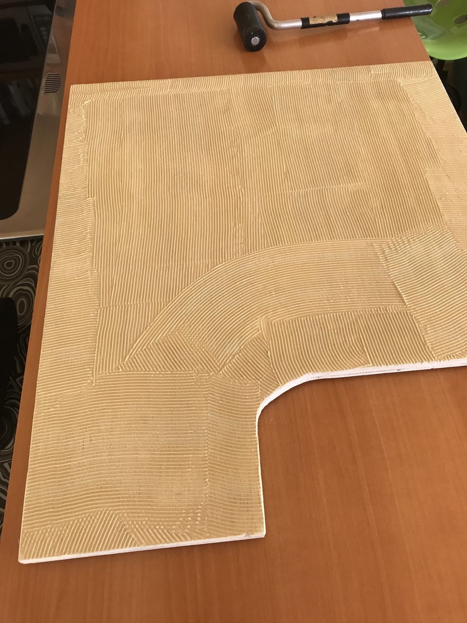

    Put together some recovery gear

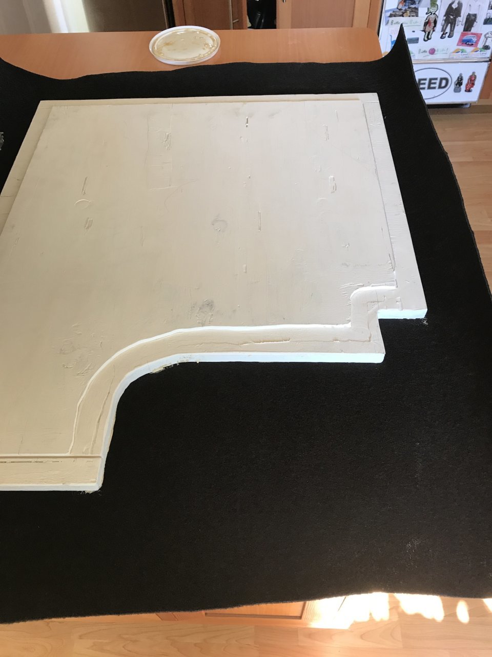

    Rear storage area remodel

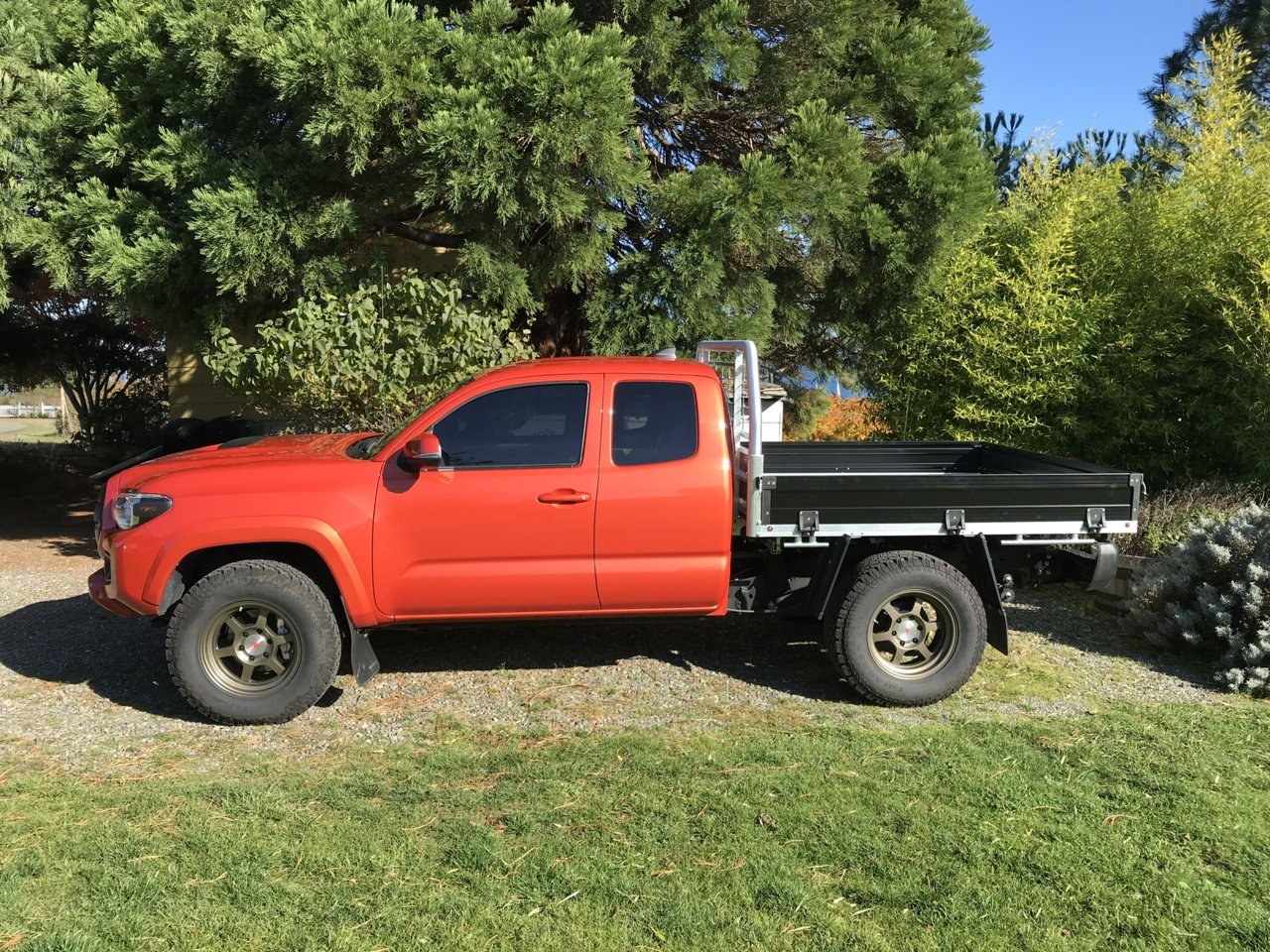

    Window tint and powder coat bed sides black. Toyota decal. No lift in this photo.

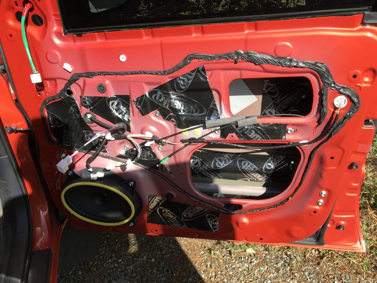

    New speakers from Crutchfield , front and back. Subaru tweeters on the dash and some left over Dynomat really helped the sound system . Also sprayed some Fluidfilm in the bottom of the door to keep any possible rust at bay.

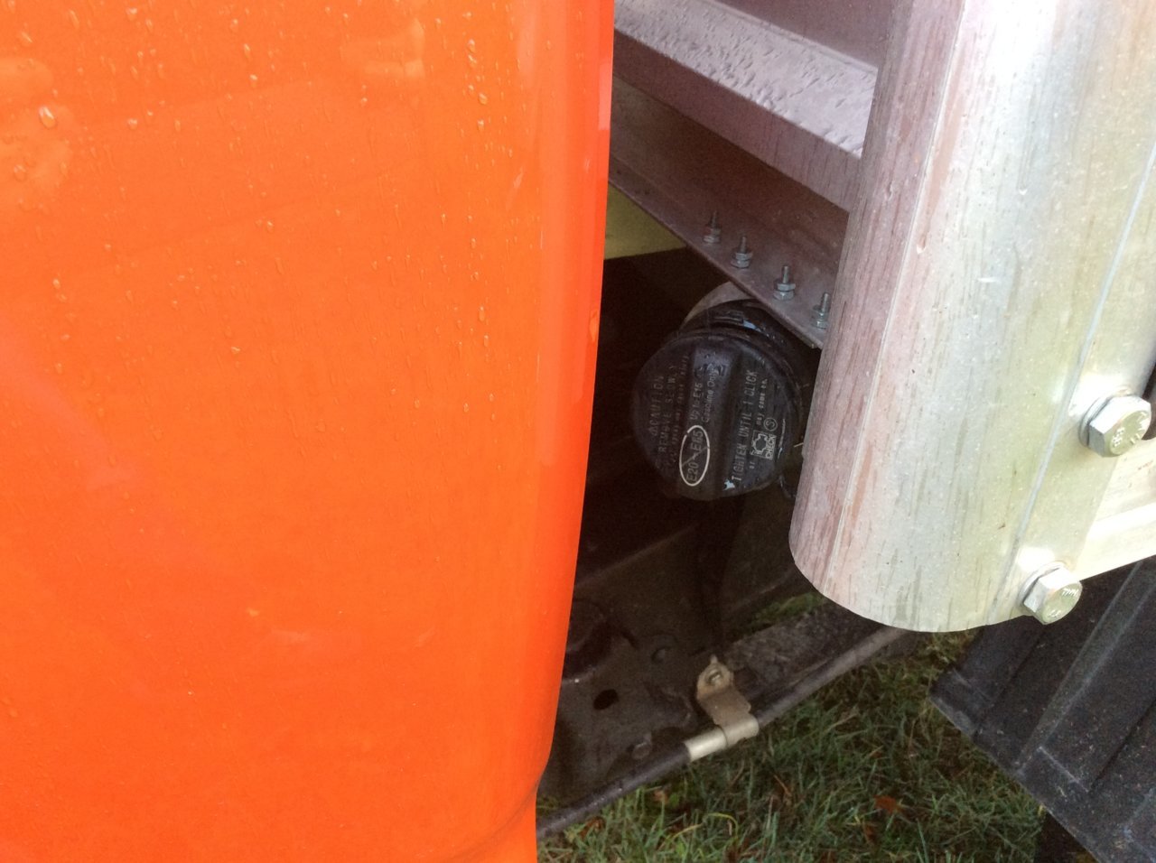

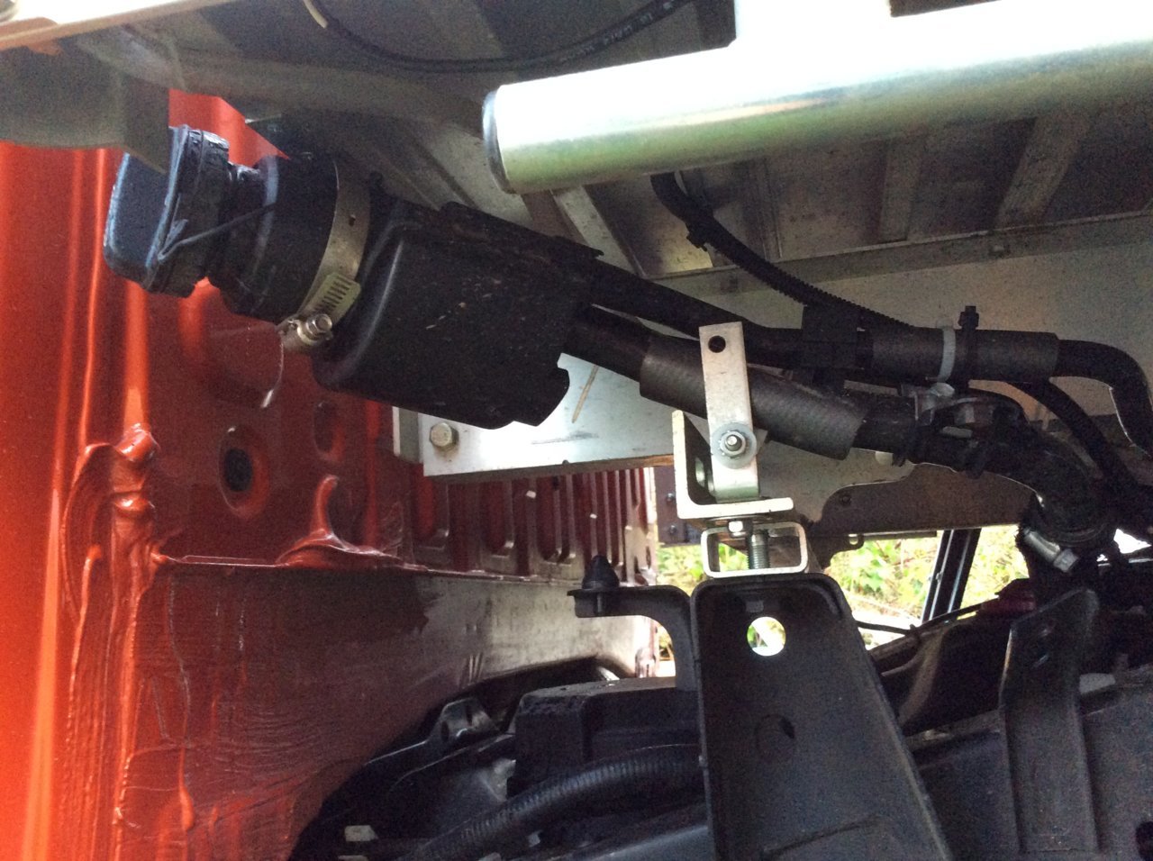

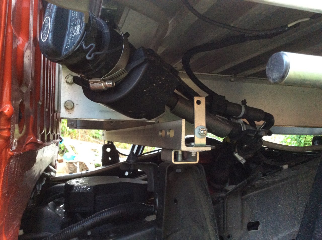

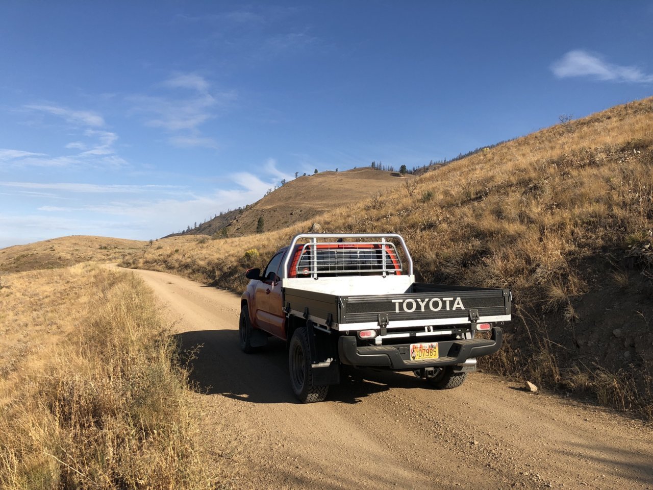

    I’ve thought some about doing a better job with the gas filler. Maybe weld up a new tube and get the filler into an easier to reach spot. But as it stands, works fairly well and uses the stock plumbing.

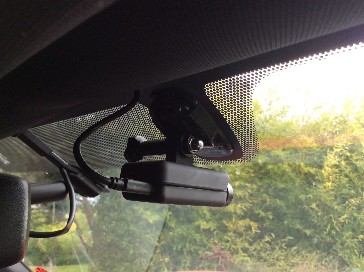

    I repurposed a Mobius 2 camera from a drone into a DashCam mounted on the GoPro mount, using a mount from Shapeways.com. It turns on with the ignition and just keeps recording five minute files , over writing the older files. If I need a file I have to plug it into the PC. It was a bit of a bear to set up, but takes great footage and looks really clean.

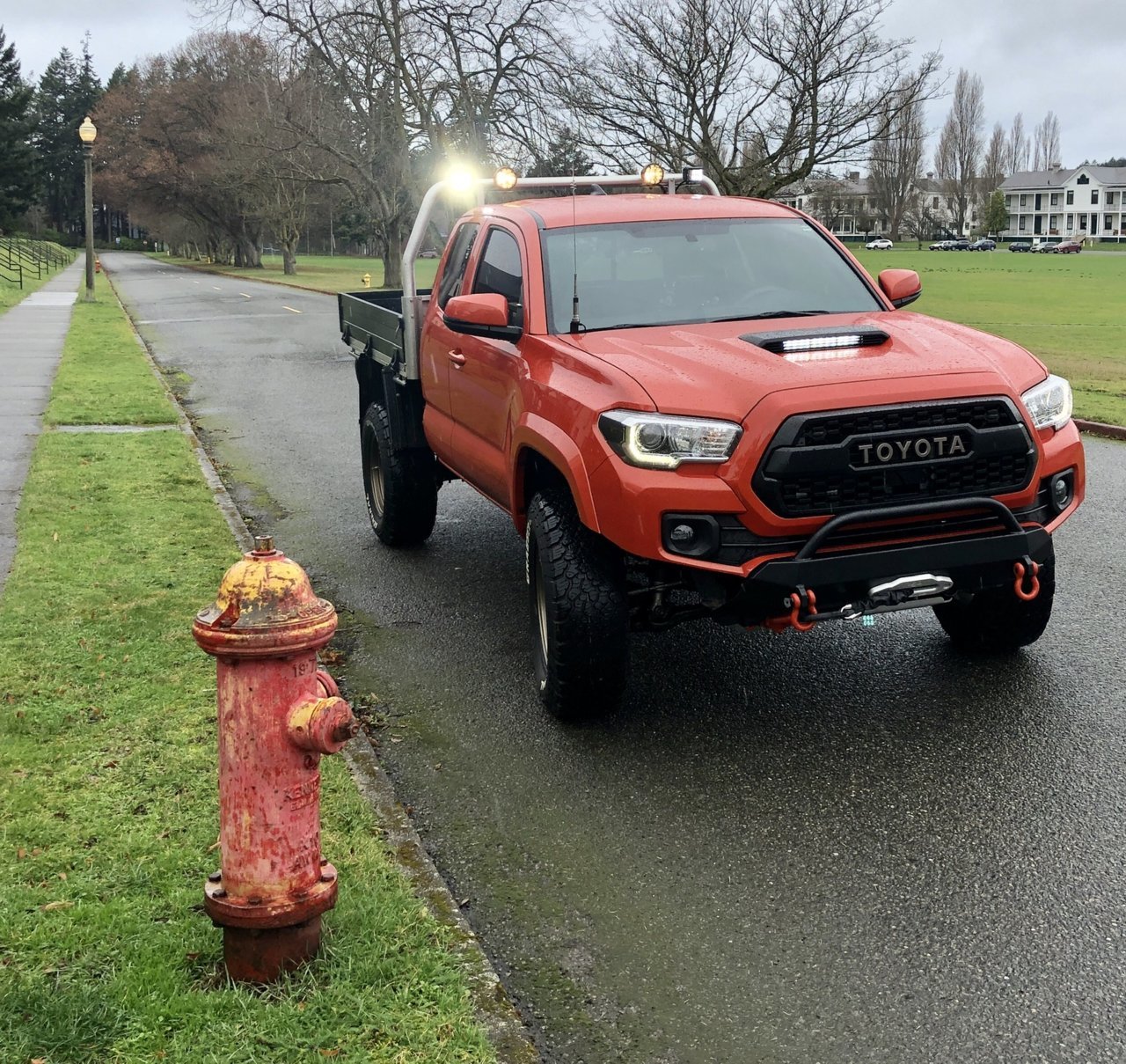

    Earlier this month I dropped the truck off at Mule Expedition Outfitters in Issaquah and had some work done. Falken shocks with Dobinson Hilux springs , total chaos UCA.

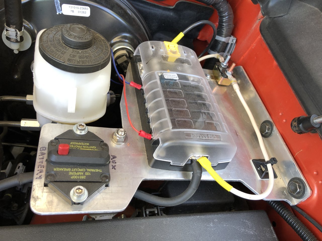

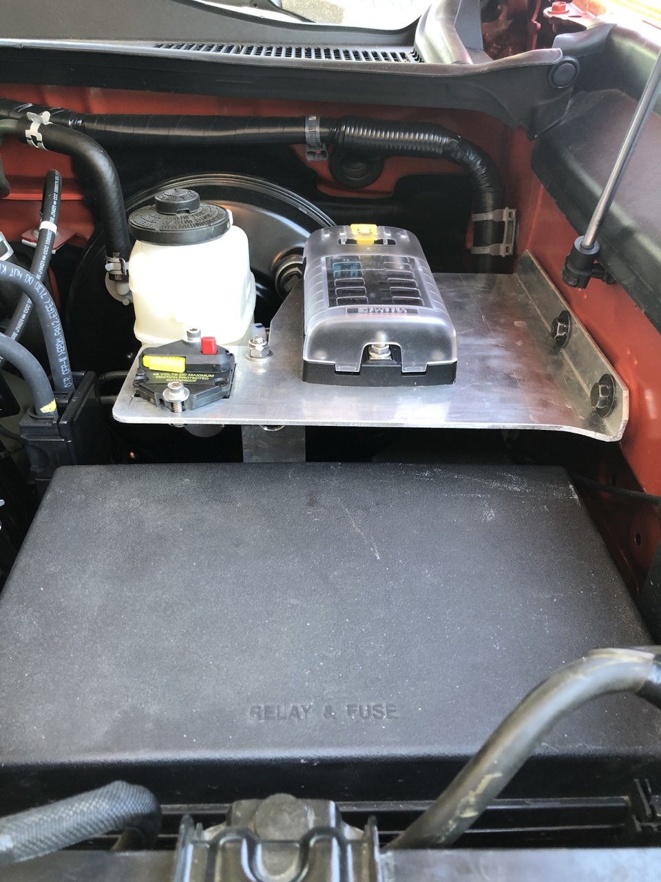

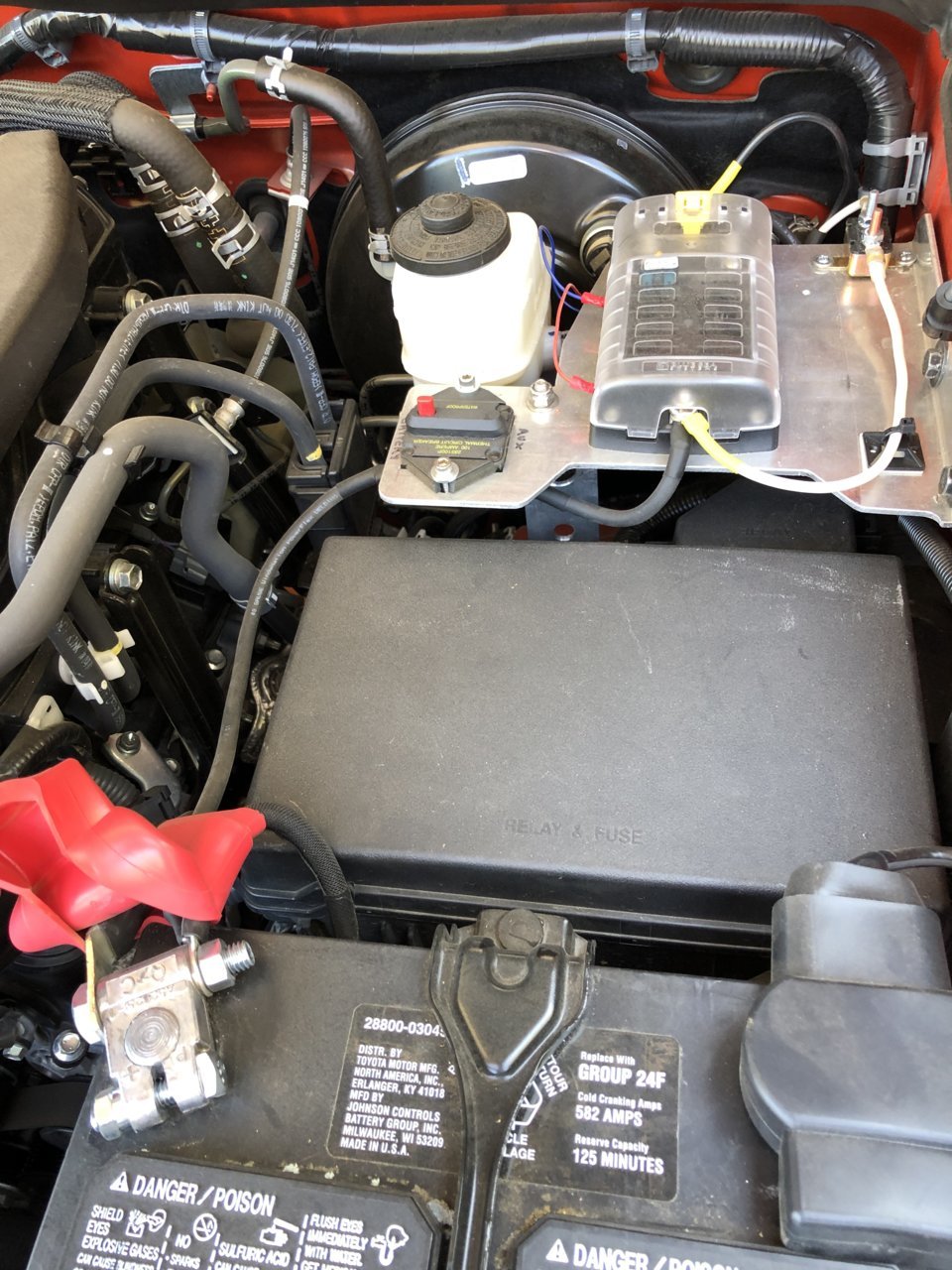

    I had some scrap aluminum knocking around so I fabricated an auxiliary fuse panel.
    Replaced the battery connectors with a more beefy military grade connection.

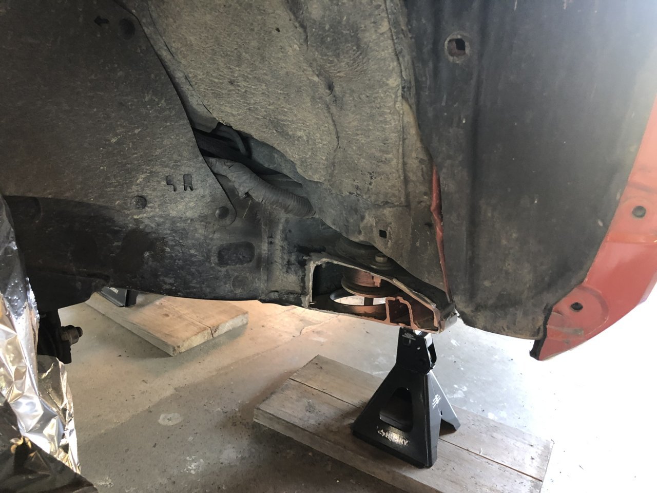

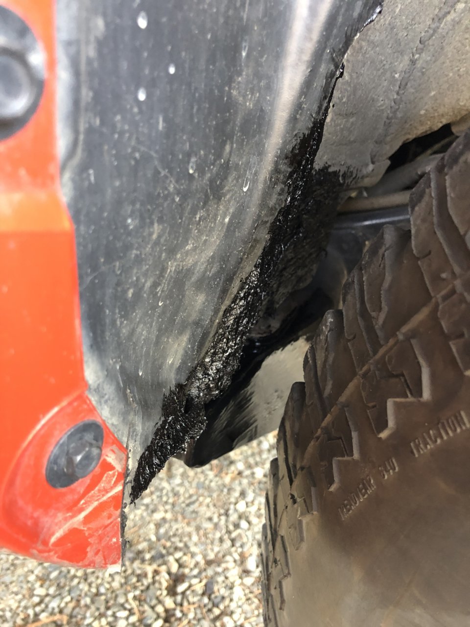

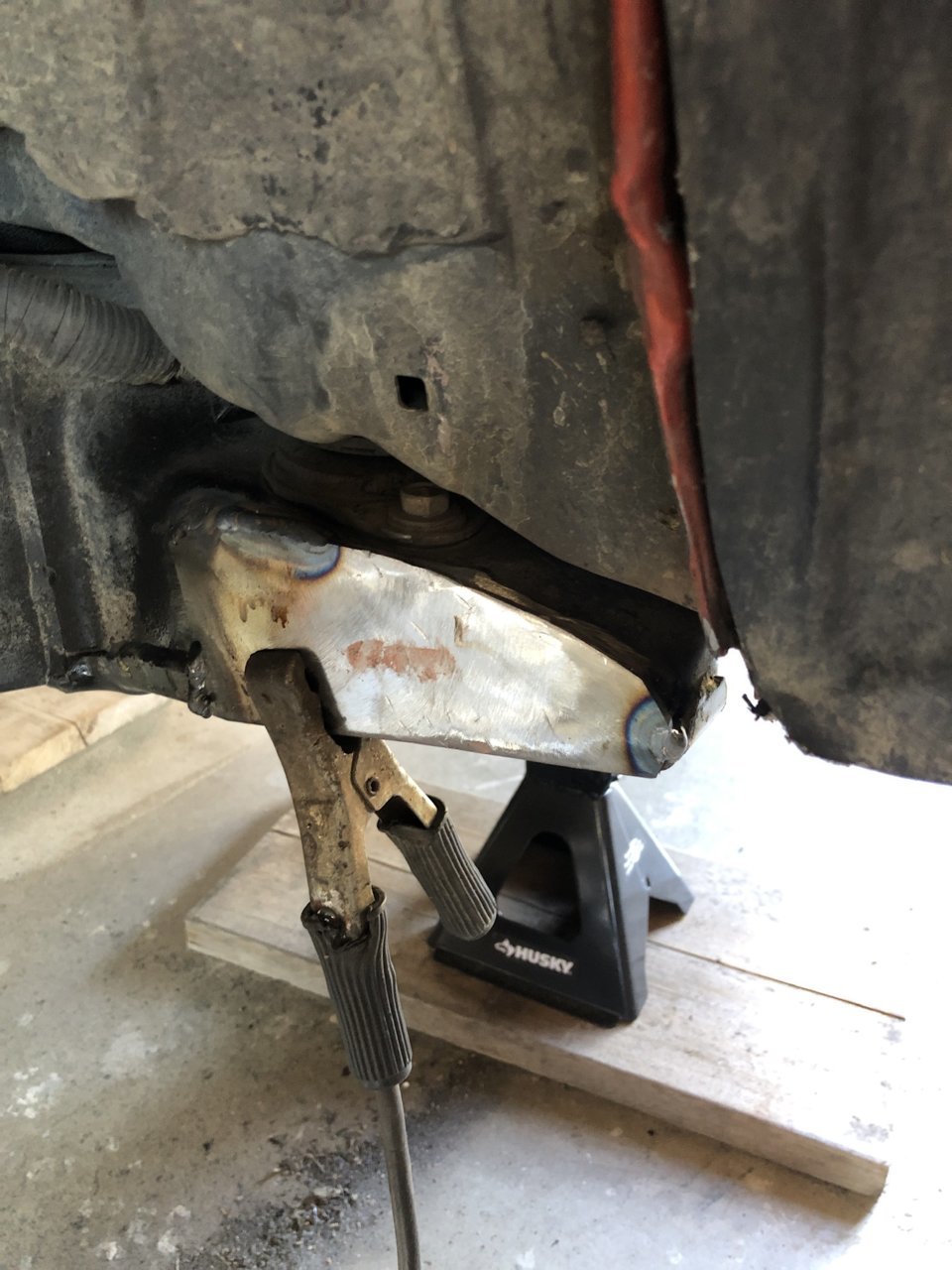

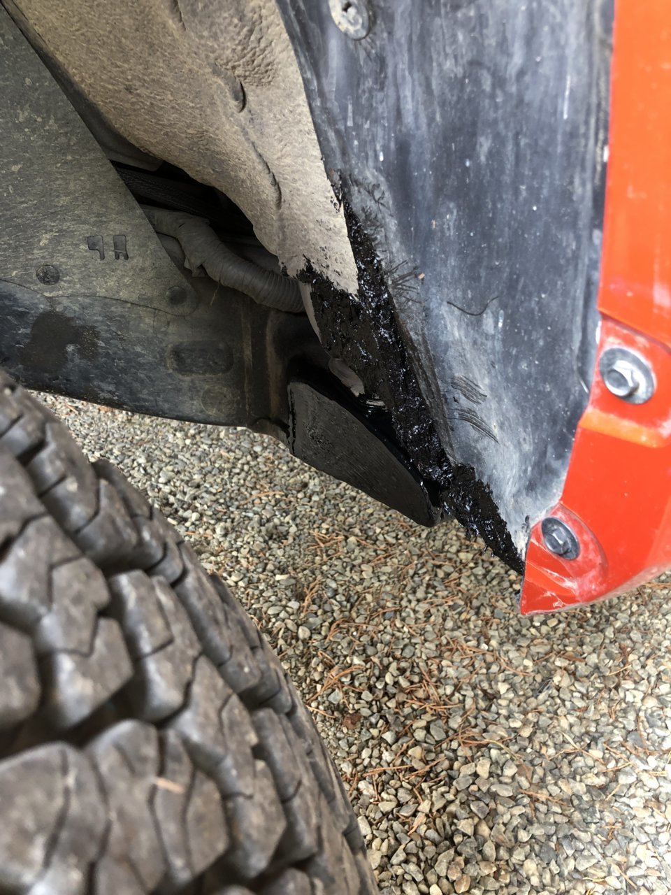

    The 265/70-17 General Gabbers AT2 tires rubbed pretty bad. Worse since the lift in fact. So yesterday I cut chunks off the body mount brackets and welded on some 1/8 inch plate. Also cut some plastic and beat the crap out of the pinch weld.
    34C37634-9CD1-45F9-BC67-D1B6C20FE055.jpg 8A8D63A4-37DD-437C-89AF-E0AF7D06D68A.jpg 4851BC4A-1EB3-4BDC-BA2F-C0292B66C29D.jpg
    Hoping for a Labor Day sale so I can pick up a larger set of tires. Probably 275/70-17. I’ve really liked the General Grabber so I think I’ll go with the ATx. E rated as the P rated have been a little worrying with the FWC fully loaded.
