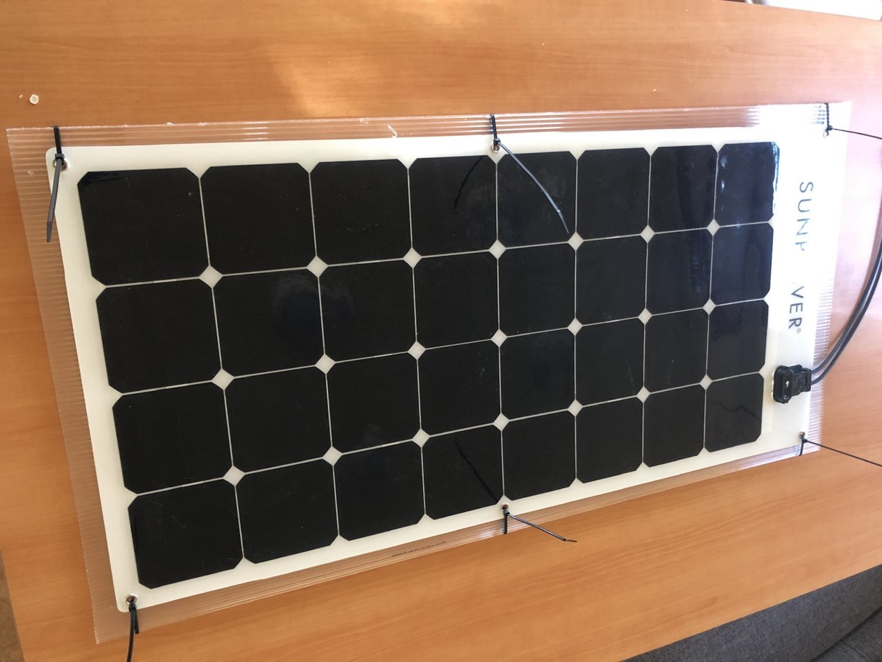

    WARNING- DON’T DO THIS

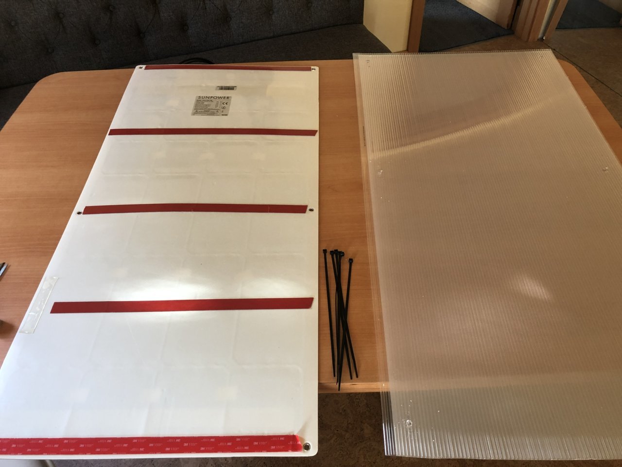

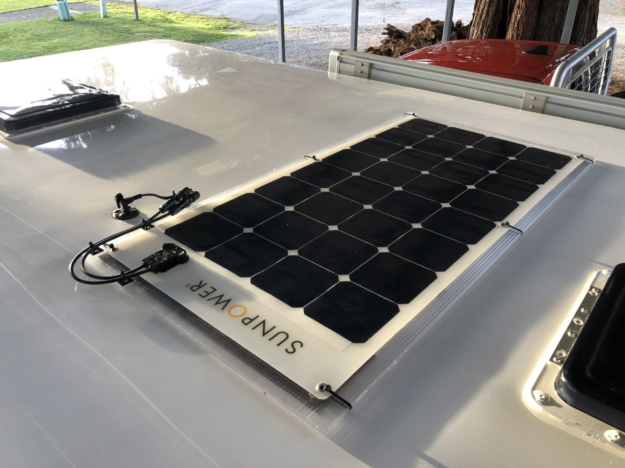

    Stuck my solar panel to some polycarbonate greenhouse panel using heavy duty double sided tape. Hopefully allowing some cooling through airflow under the panel.
    Also some zip ties cause....
    Then used heavy duty Velcro to attach it to the roof. My thought is it’s a good place to store the panel and get a charge. If need be I hope it’ll come off and can be placed on a longer cord in a sunny spot.
    Yup! Don’t do this. It blew off on I5 somewhere:amen:

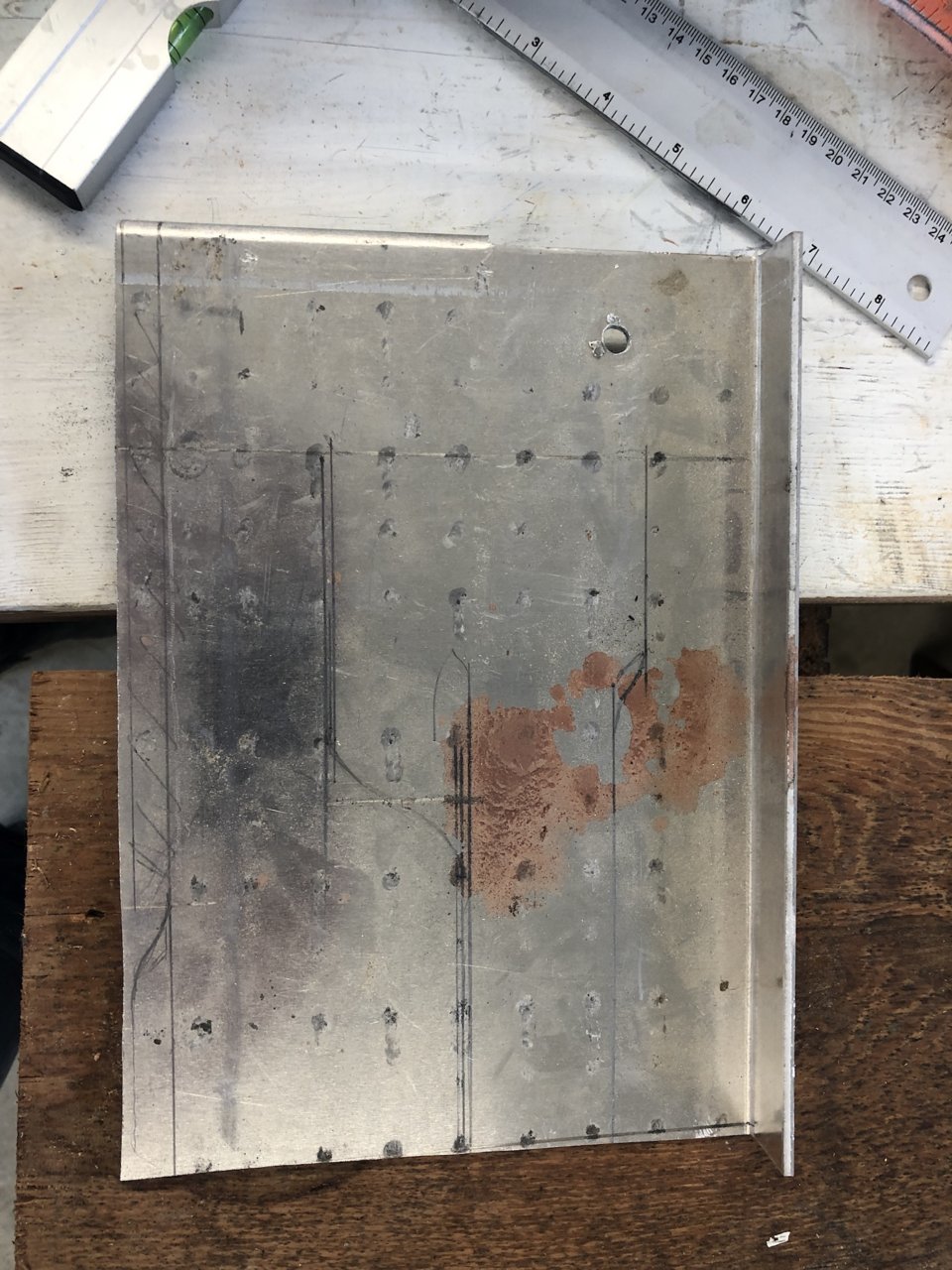

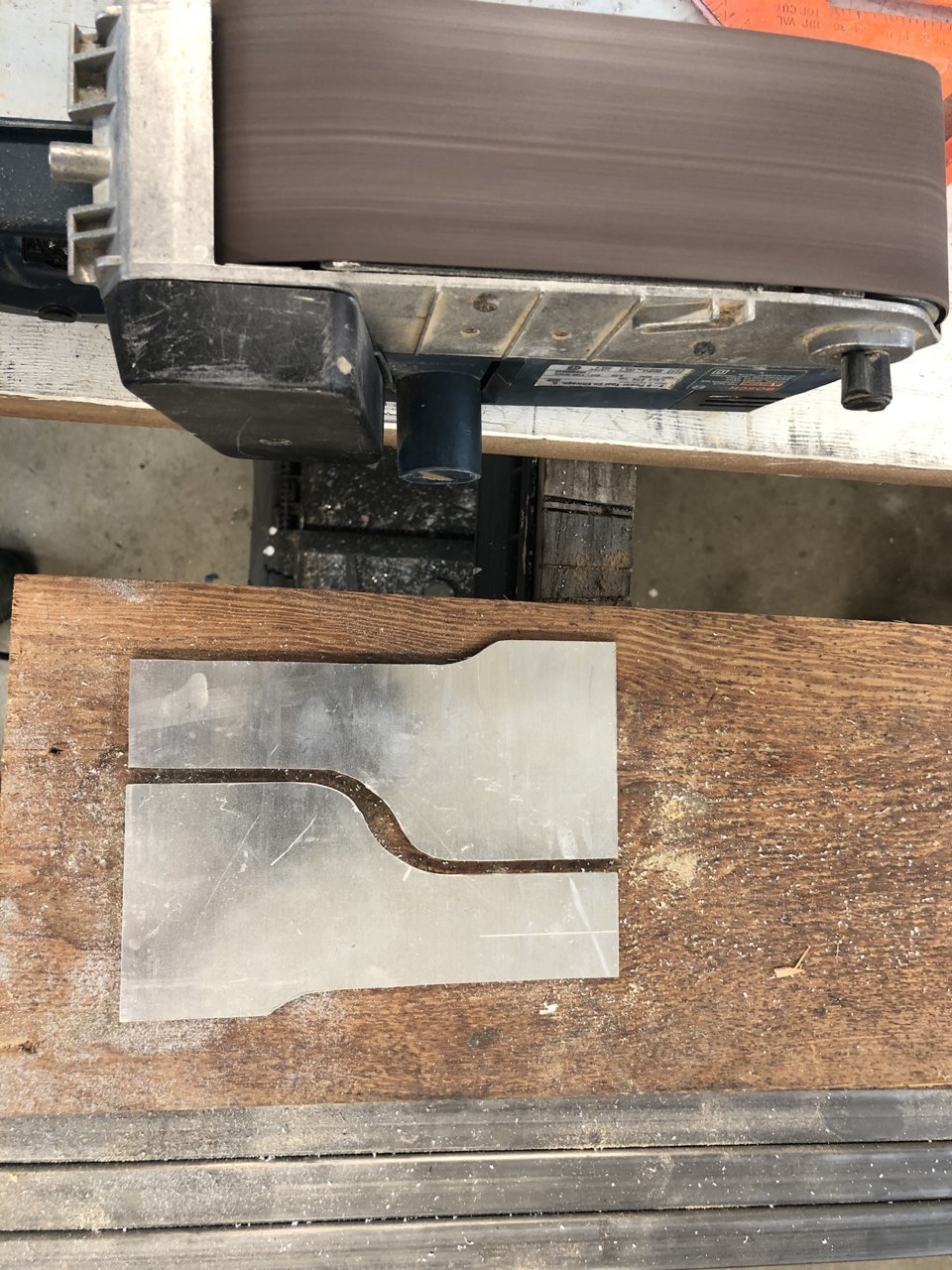

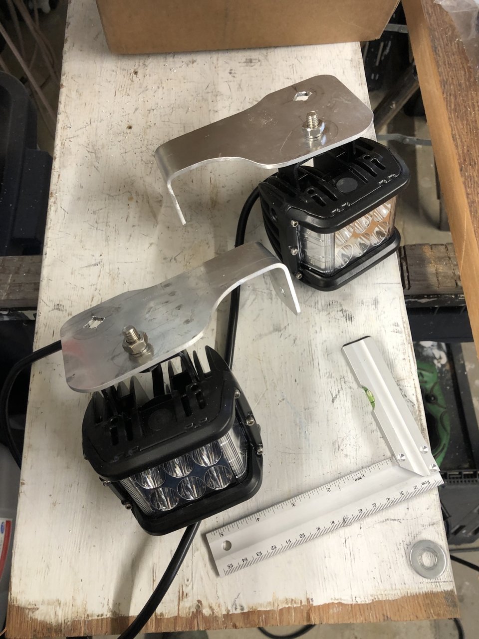

    Fabricated some aluminum brackets for the ditch lights.

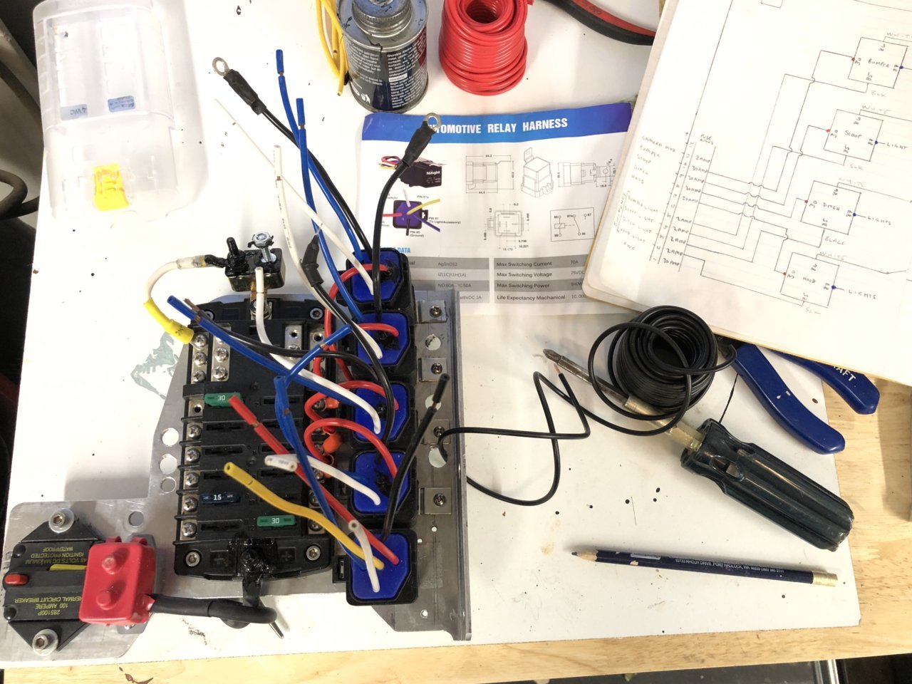

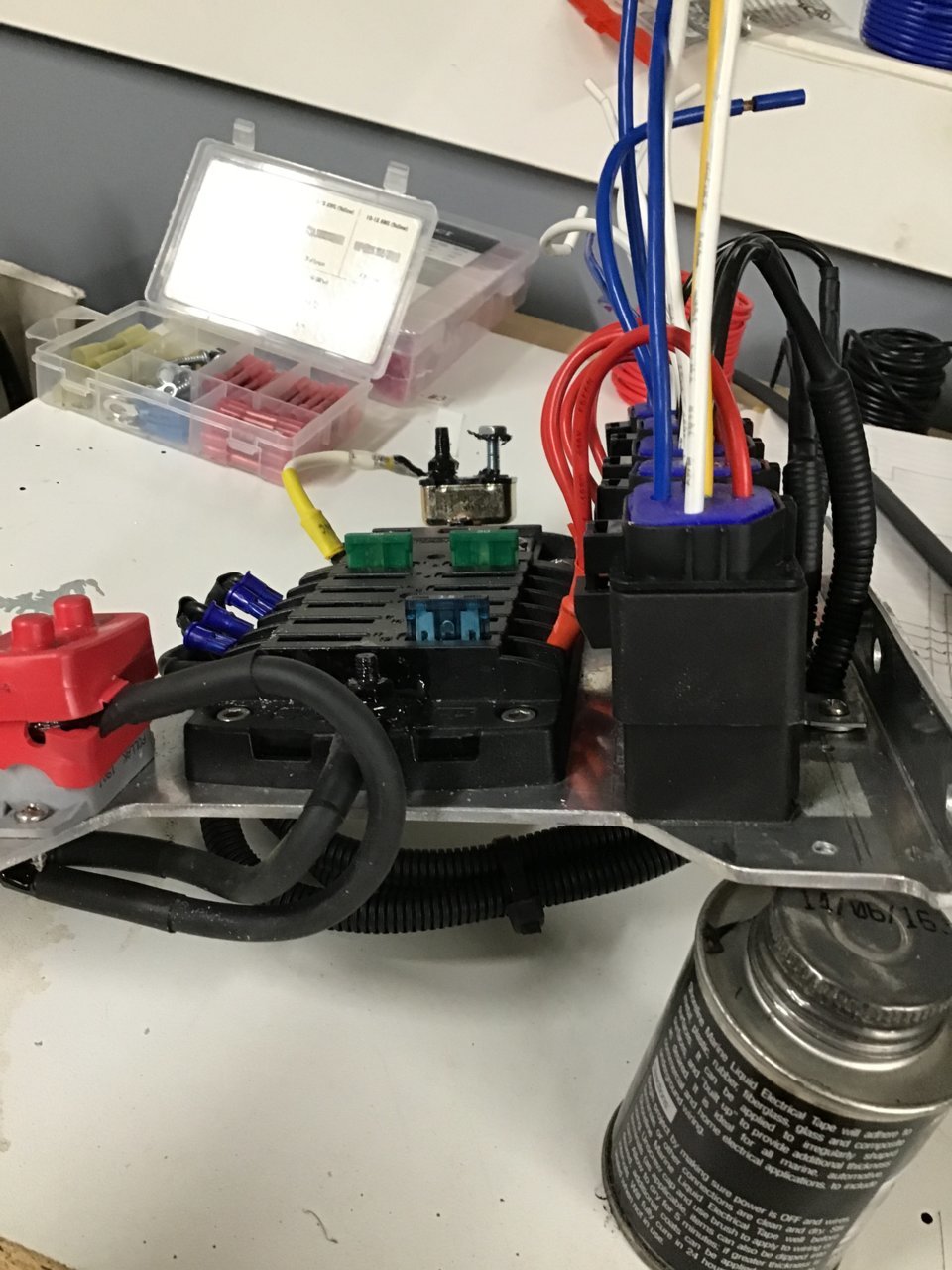

    Been jonesin to get back to the wiring project this week but house projects are getting in the way.

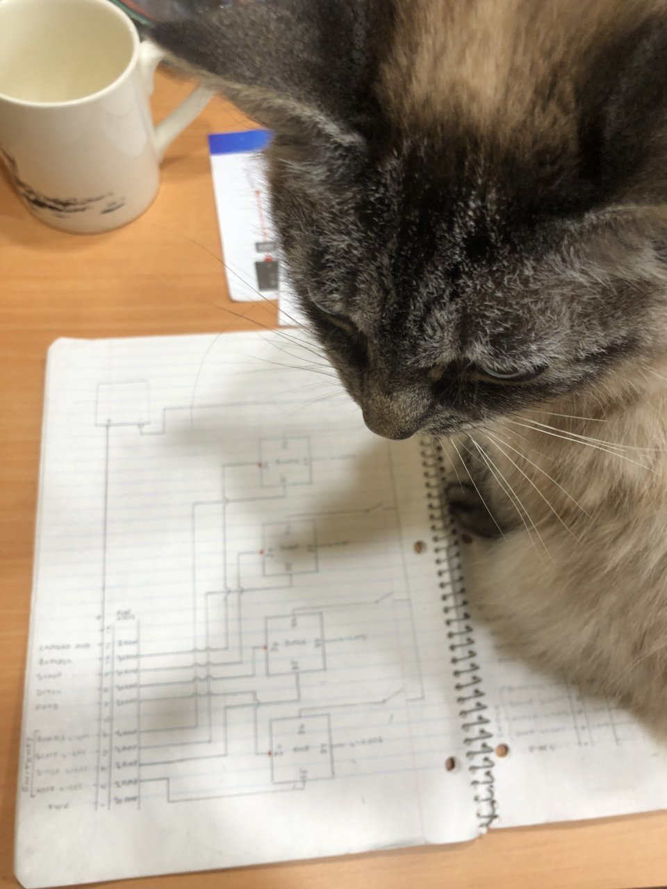

    I did get to sit down with the cat and some help from @Kens04Taco to sketch out wiring for the ditch lights, hood scoop, bumper, under hood and rock lights.
    This is how the panel stands right now. It’s getting cramped and I still what to squeeze one more relay in and a bus-bar.

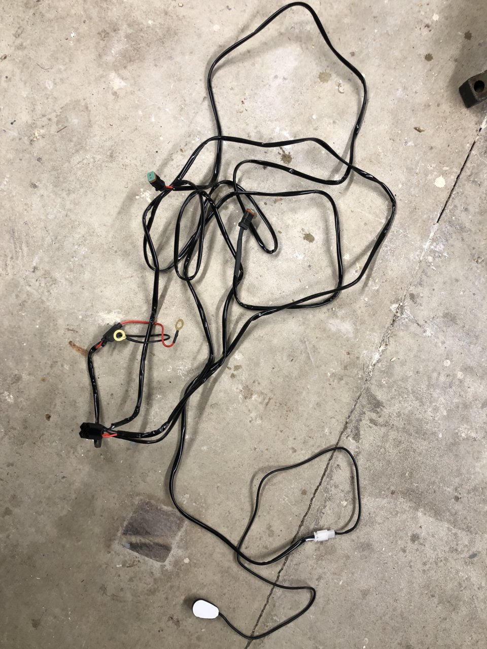

    The Cali Raised loom turned out to be too short for the 13 foot run to my ditch light, so I may butcher it for the KC bumper lights or something. Still waiting on the SSO bumper anyway.

    Turns out the wires I ran from my ditch lights were a foot short. 15 feet wasn’t enough. When I did finally open the hood to find out, I also found rat piss and shit all over electrical panel! :yay:/s

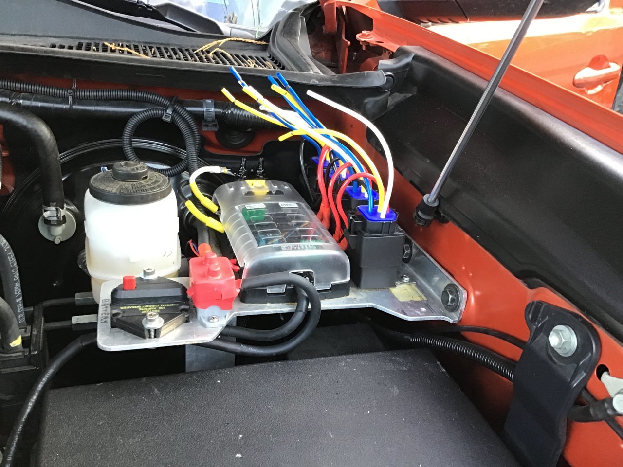

    Pulled the whole panel out and scrubbed with bleach. Piss was soaked under the blue sea and one of the relays.
    Did a fairly shoddy job of drilling some holes on the pillar drill. Hard with all the stuff on the panel. The black wires now come off the fuses on the left, down under the panel and up to the relays through the three holes on the right.
    Still a light odor of urine, and peppermint!
