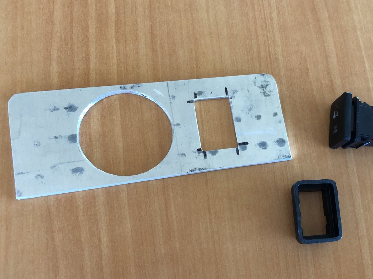

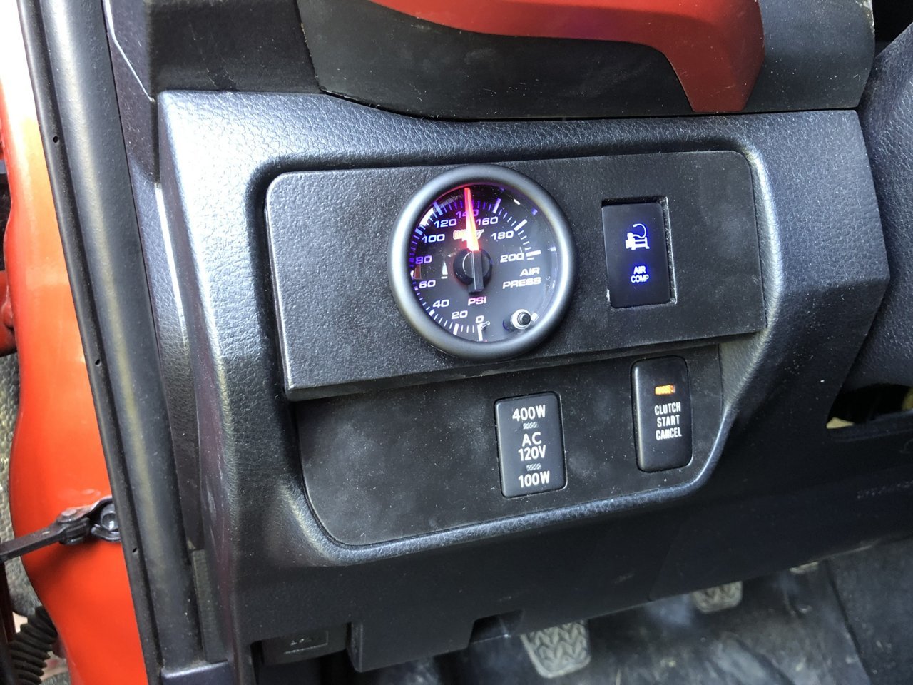

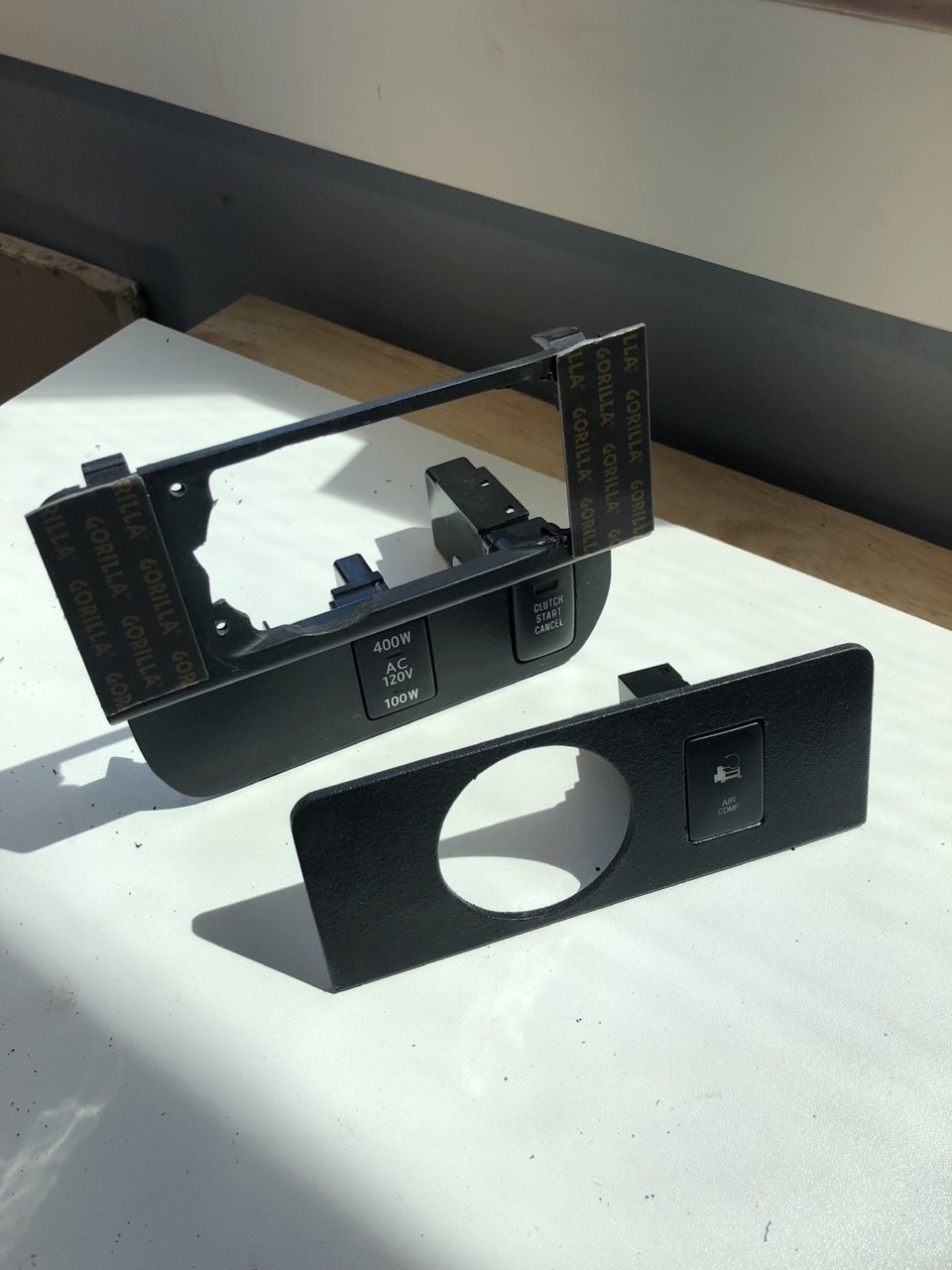

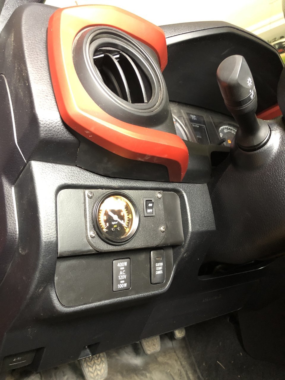

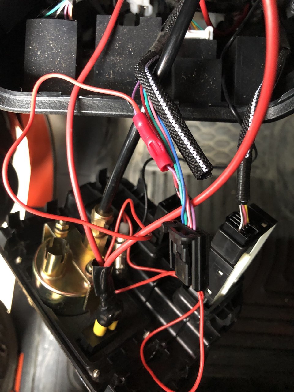

    I was thinking the pressure gauge and switch for the onboard air was kind of half arsed, so I fixed it.

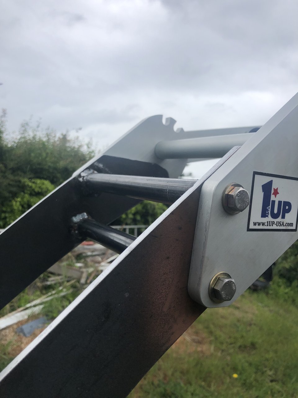

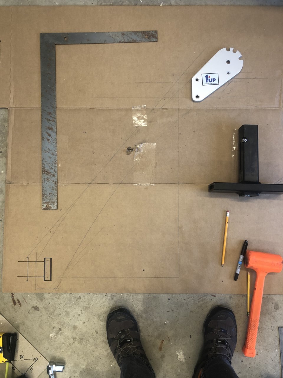

    The 1Up bike rack arrived this week and I got to it, making an extension so we can use it with the camper.
    Ready for some powder coat.

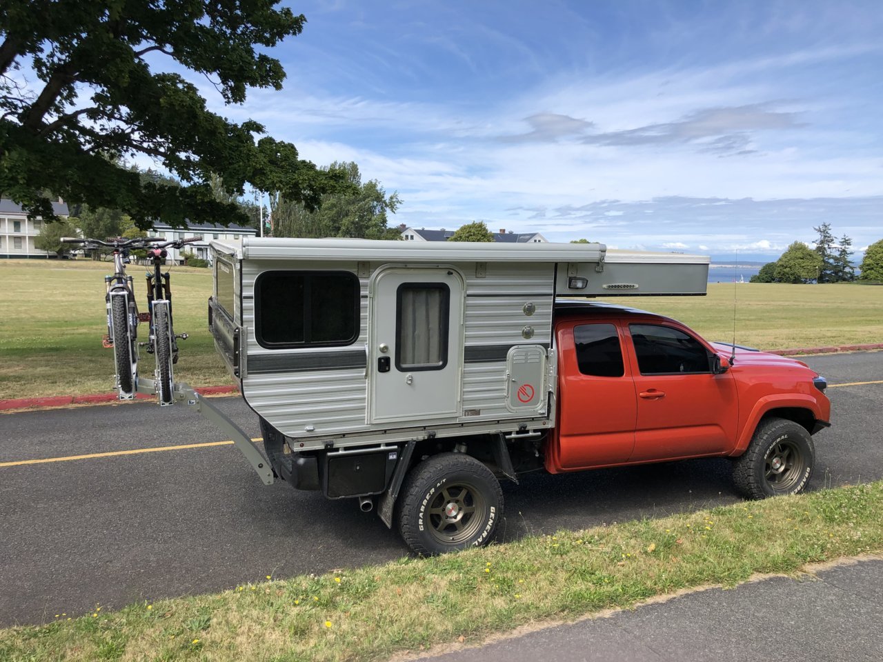

    I finally finished the apartment remodel and found some time to put the newly powder coated rack together and load up the camper.
    I think we have to go camping this weekend!

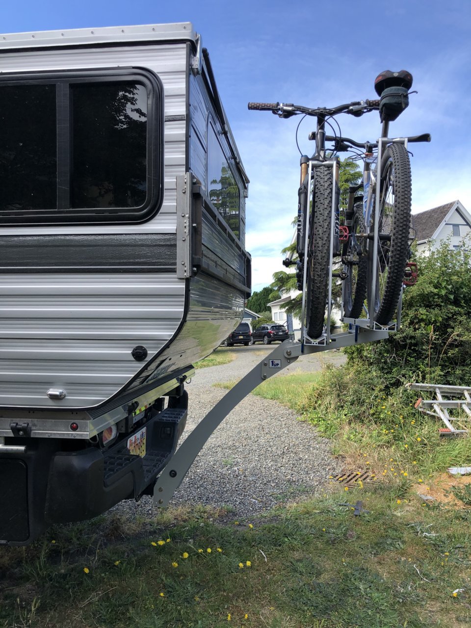

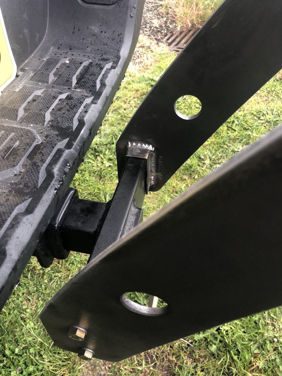

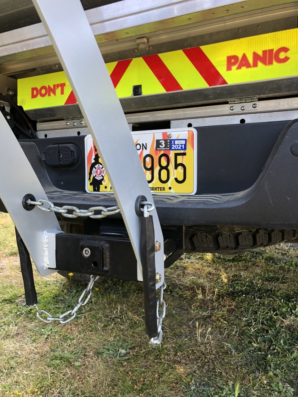

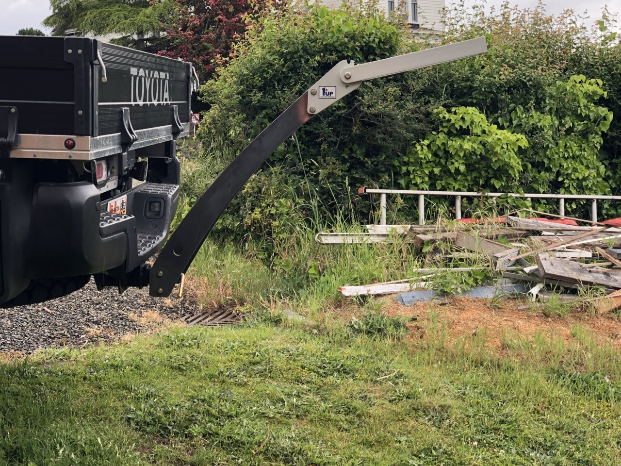

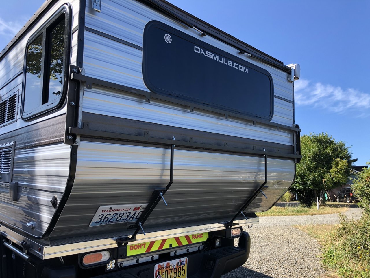

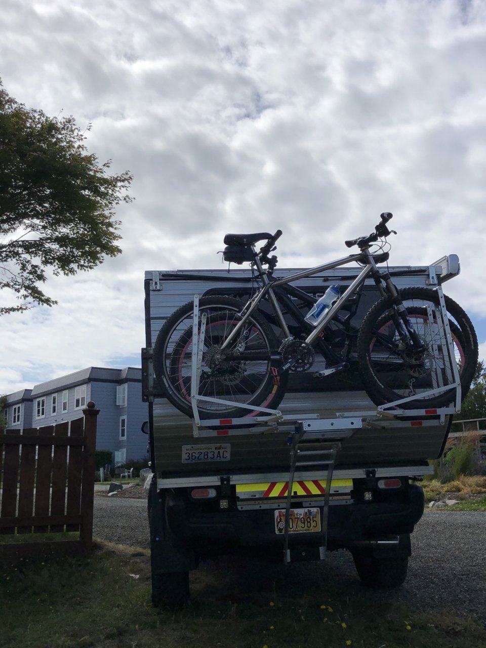

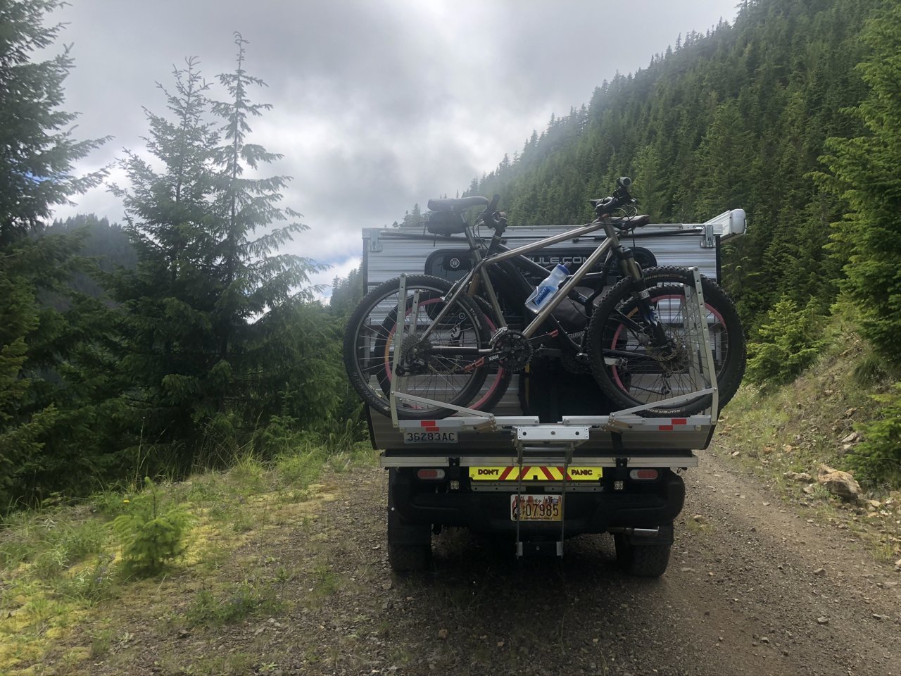

    Test run with the bikes went well. Though fairly confident of my design , I am not an engineer and my welds are not great. We talked about adding a safety leash so that if the rack fails it would be dragged behind the rig and hopefully not into the car behind!
    Also, I’m super happy with the 3M tape.
    Slashaar, RyanDCLB and Naveronski like this.

    With that long of a lever arm, I'd be more worried about the aluminum hitch snapping off at the receiver.
    Might think about triangulating the 1Up into that rack you built for the back of the camper. Wouldn't need to be super strong, just enough to keep in from shock loading the hitch. A clevis for quick release on one end and a pivot on the other?
    Stopmithering[OP] likes this.
  12. Jul 21, 2020 at 6:07 PM
    #152
    Stopmithering
    Stopmithering [OP] Well-Known Member
    Oct 5, 2016
    #199003
    398
    Stuart
    17 Tacoma TRD Sport ACLB MT
    I have thought about that. The 1up heavy duty rack is designed to take four mountain bikes and almost sticks out as far as my rack with the extra two bikes on. That is a lot of extra weight. Though aluminum, it is really solid. So I’m not too worried, but I might seek out an engineer for a second opinion. Having said that I did add a safety chain.

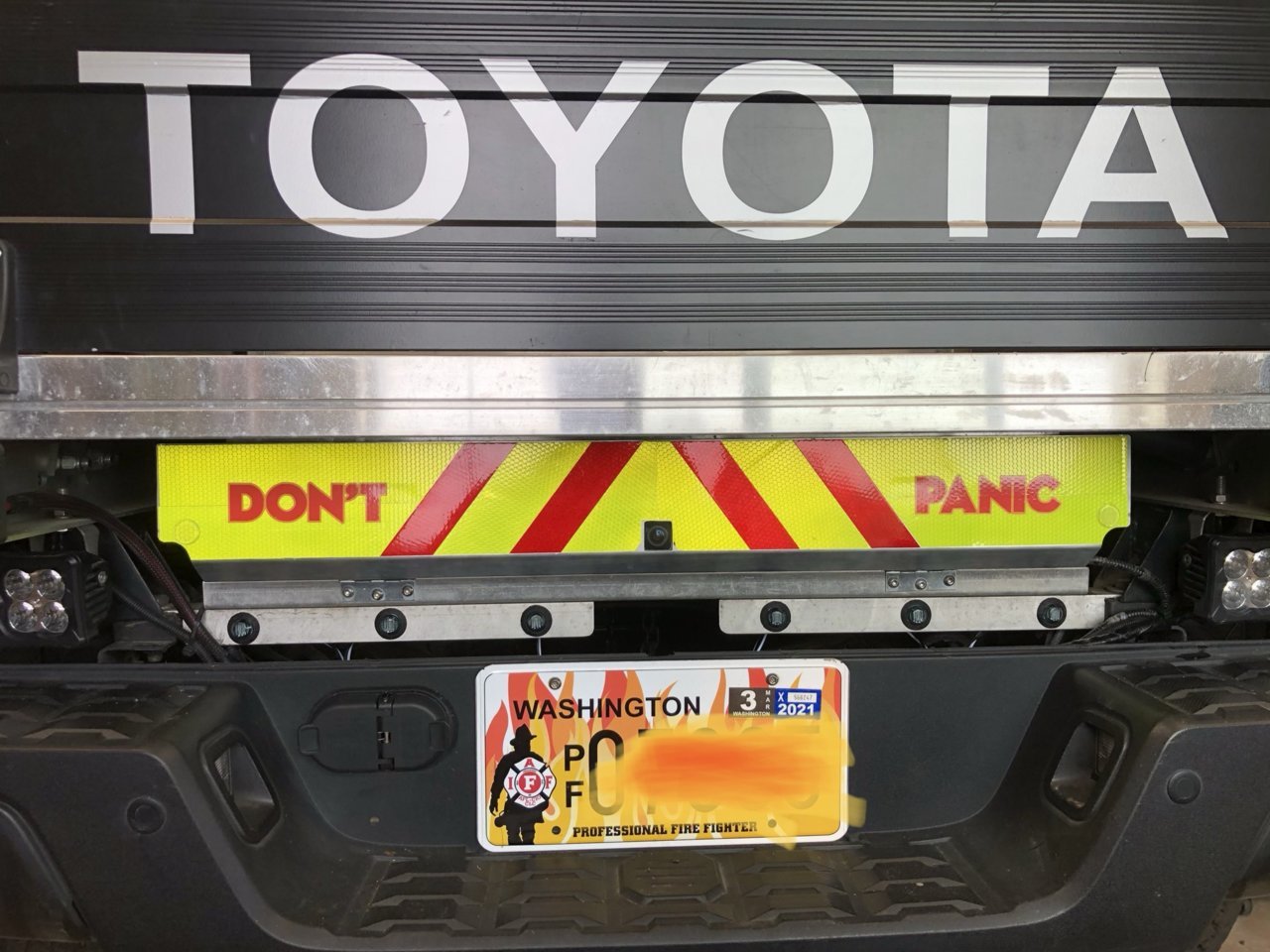

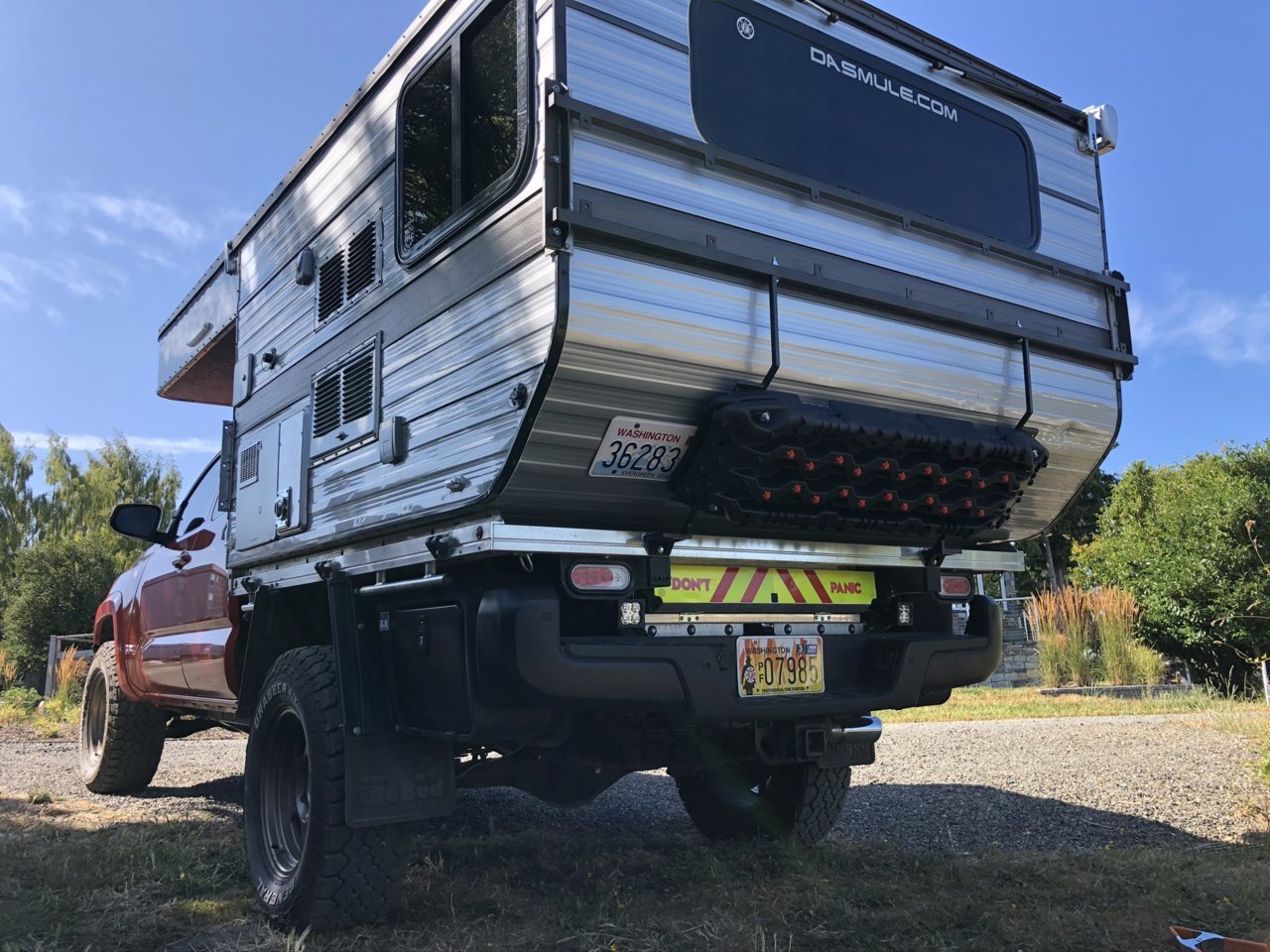

    Added some more running light. Why not? Better to be seen.

    I like it! Didn't notice the bright "don't panic" sign

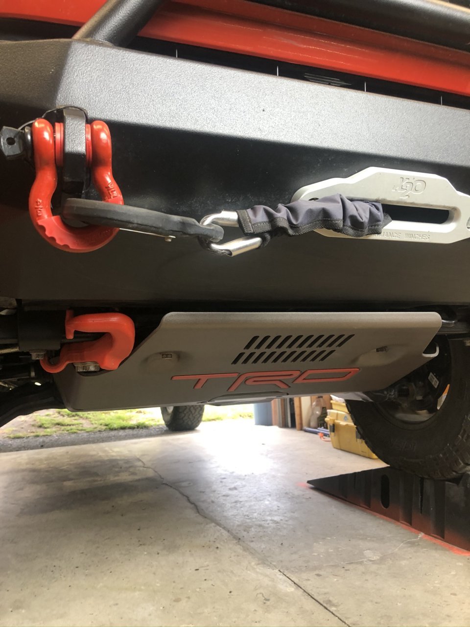

    The skid plate needs to be bronze to match the wheels and Inferno TRD

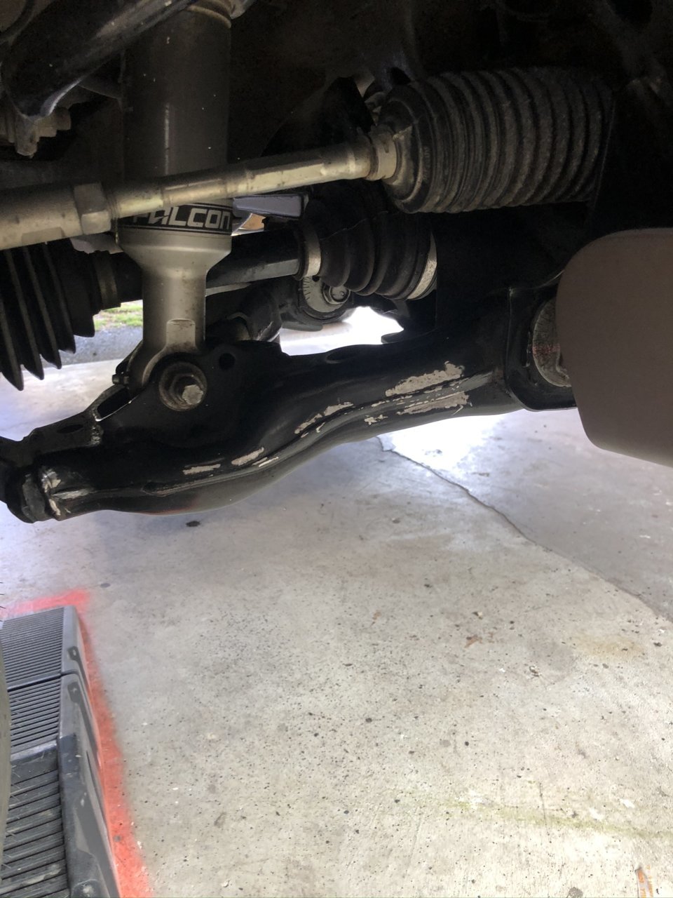

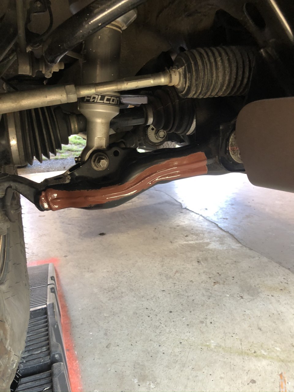

    Also took the finger sander to some small rust spots forming on the front side of the lower control arms and primed them.

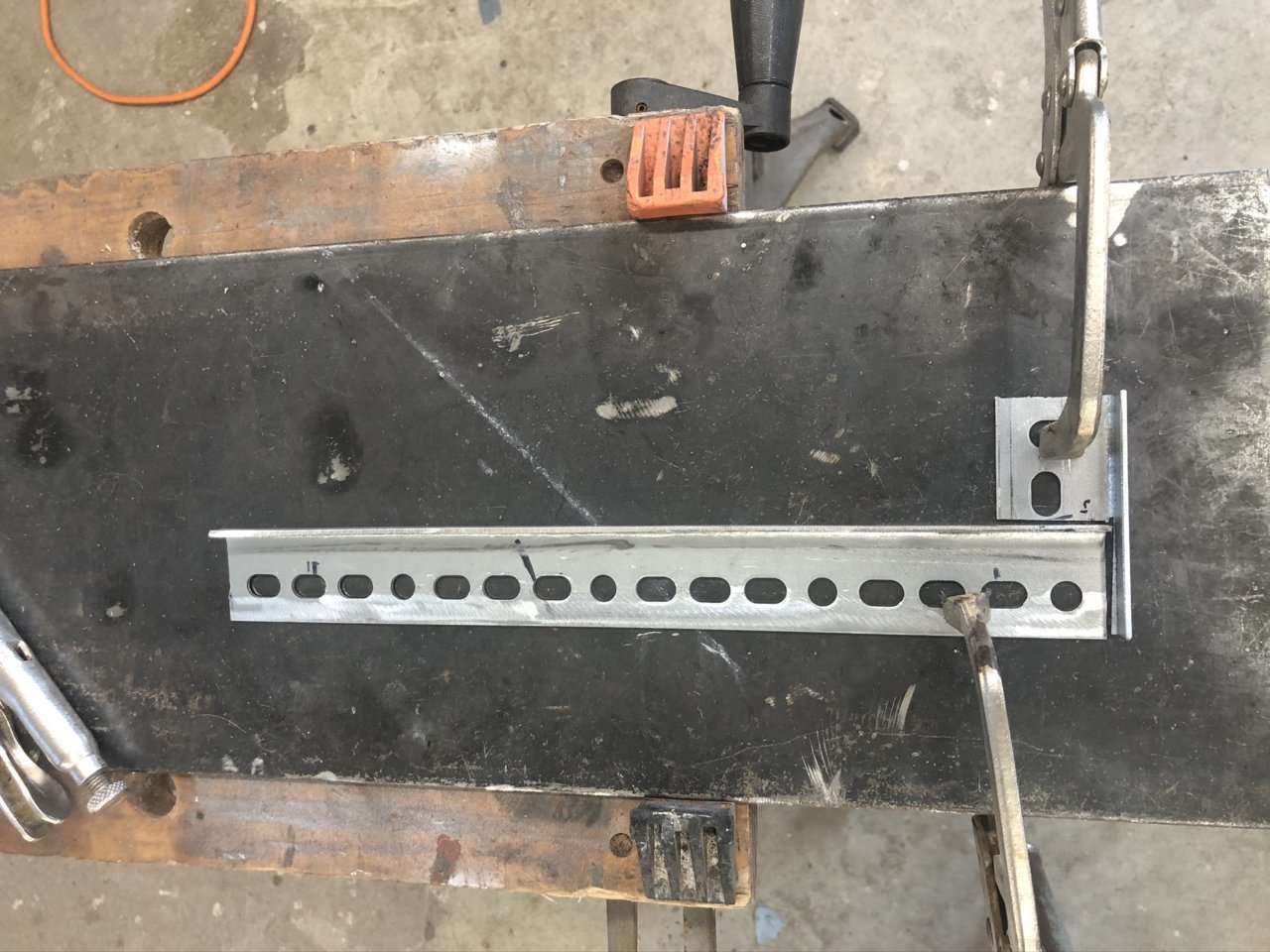

    I’ve been working on a rack to hold the traction boards, and got the preliminary test fit done.

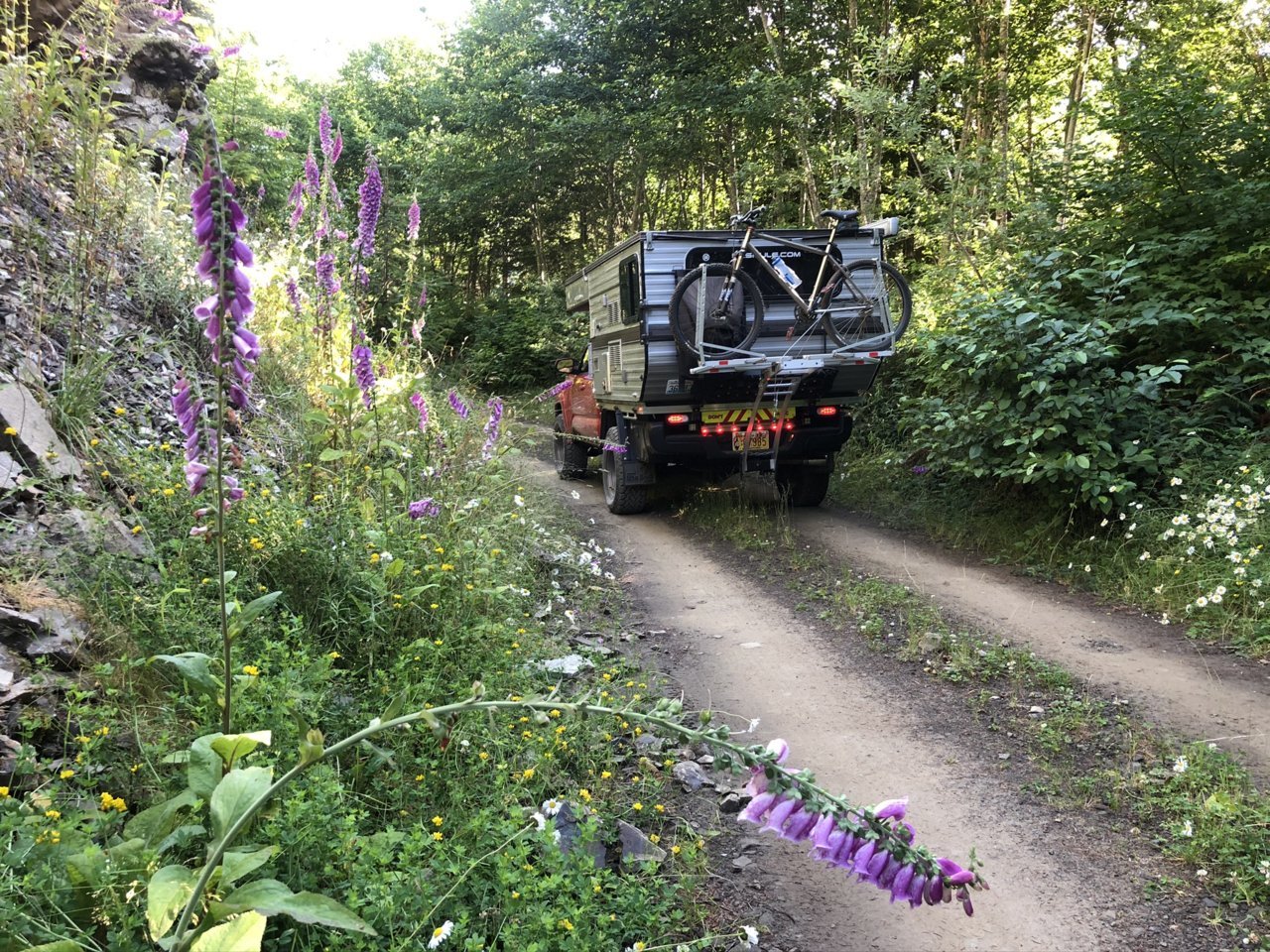

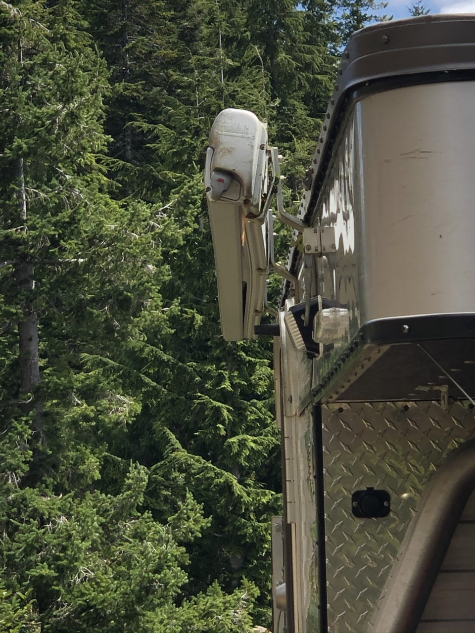

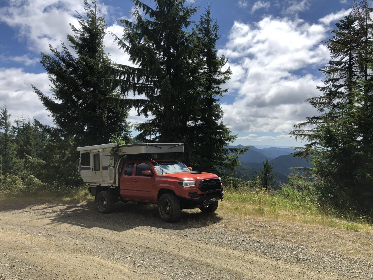

    Took three days exploring the Olympic NF in a big meandering loop. I found some great adventure up tiny overgrown trails that traverse river drainage and run ridges.
    I put the racks though there paces and am happy how they worked.
    But I did have issues with vegetation catching and bending the antenna and getting wedged between the awning and the camper.
    The awning got pretty tweaked!

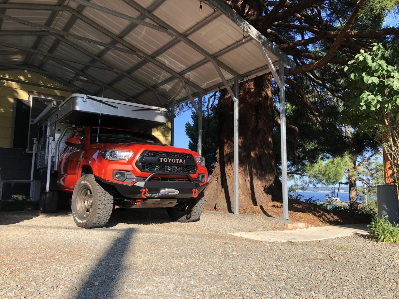

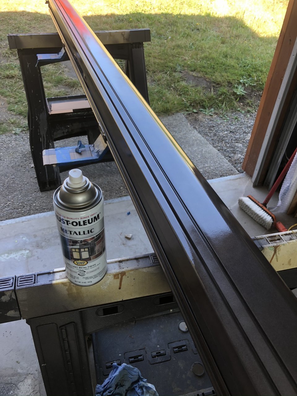

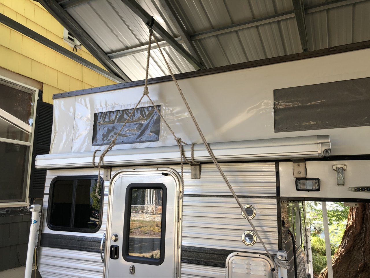

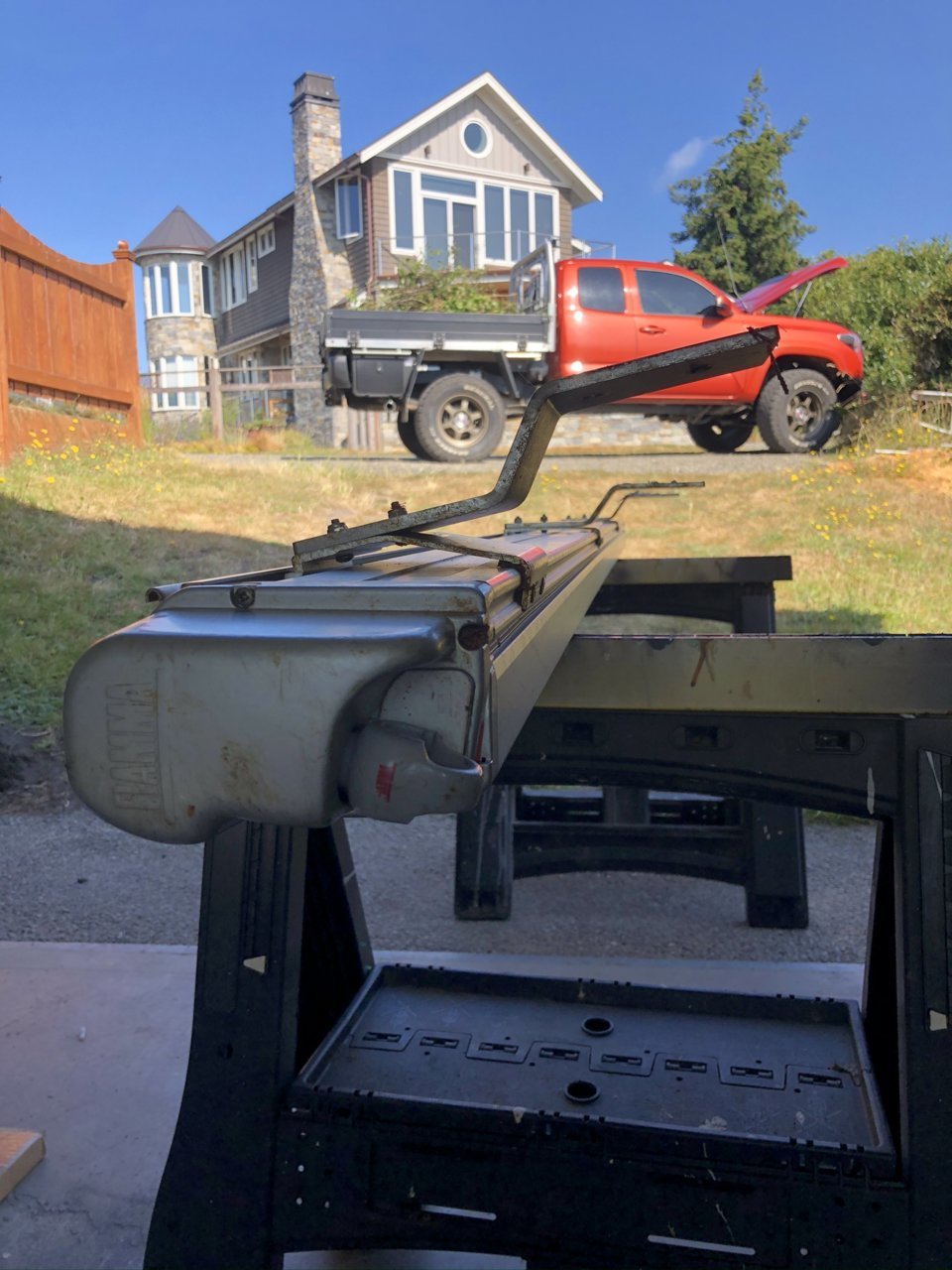

    So I have new projects. I used the car port to hoist the awning from the camper.
    Cleaned it up and found that once I fixed the bracket everything sprung back to straight.
    :thumbsup:
    A couple of coats of fresh paint and it looks great.

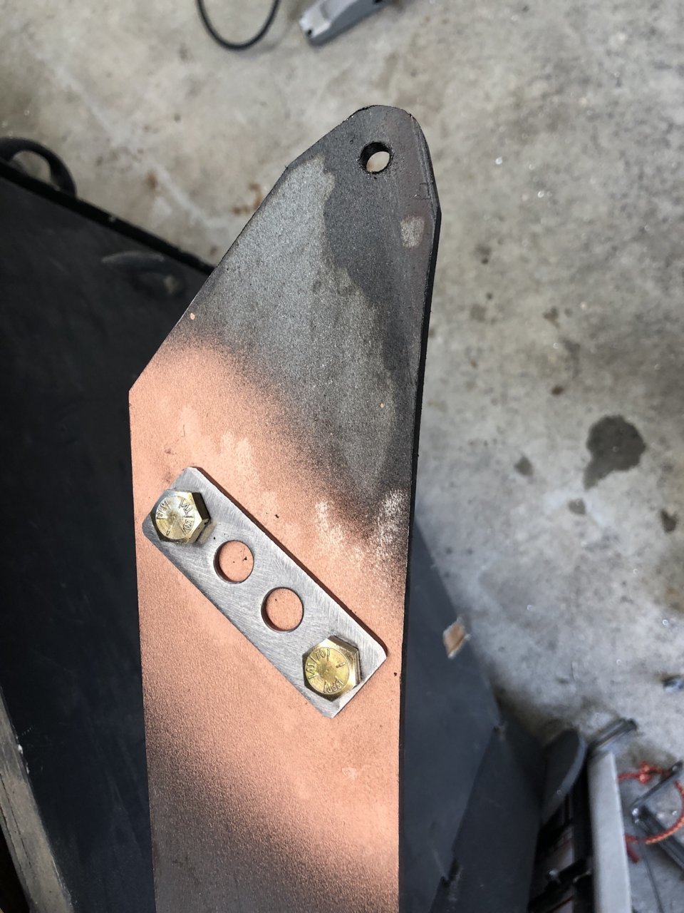

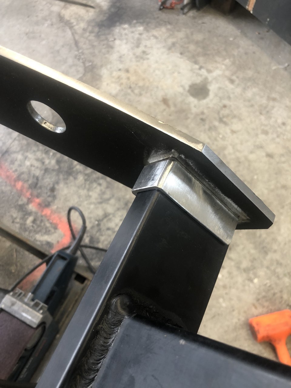

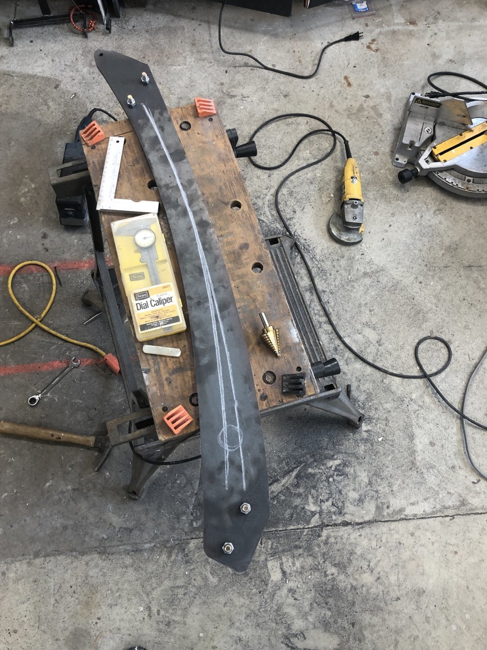

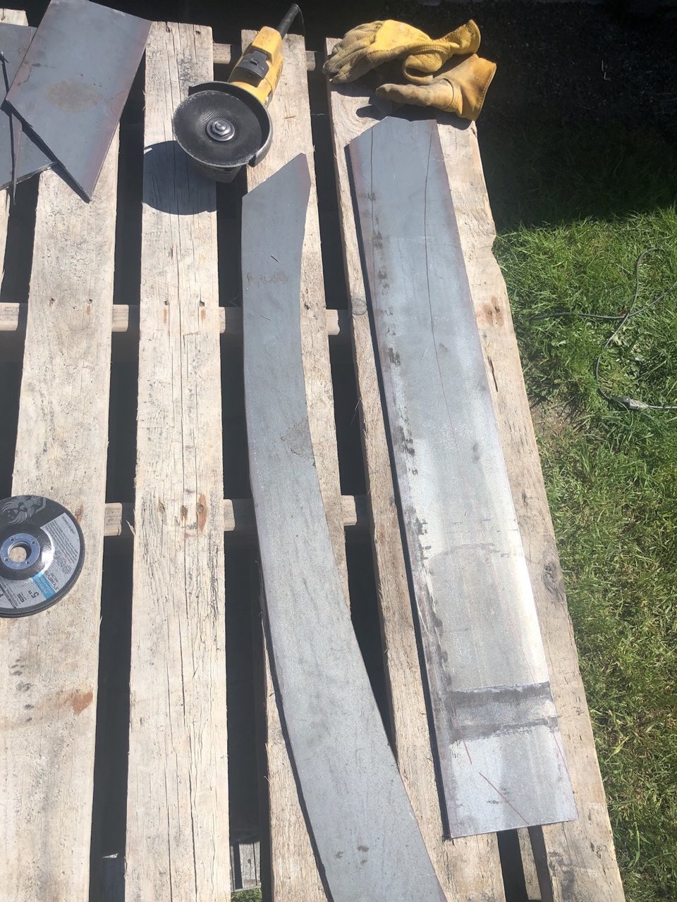

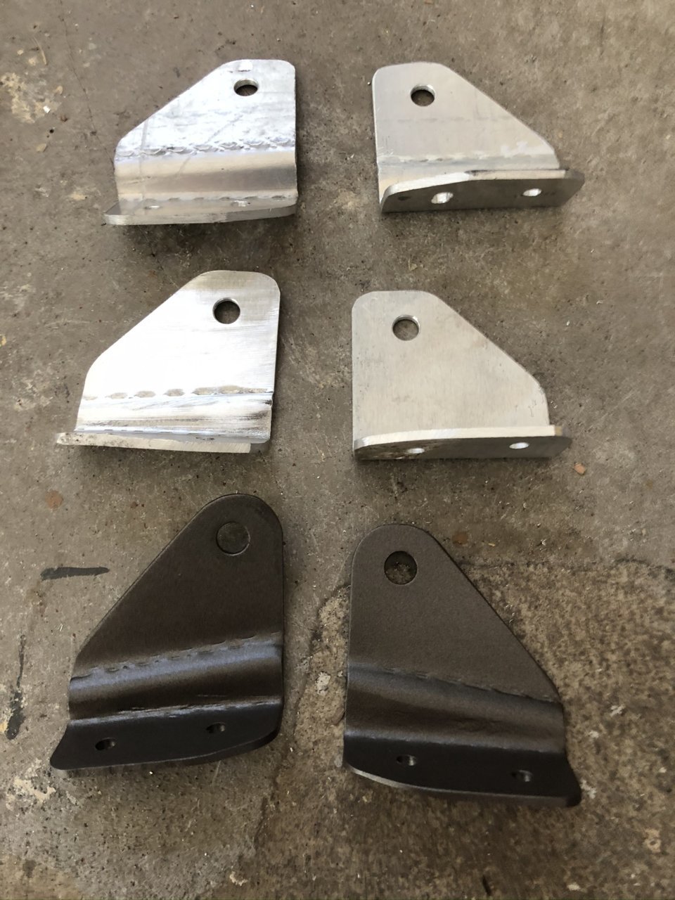

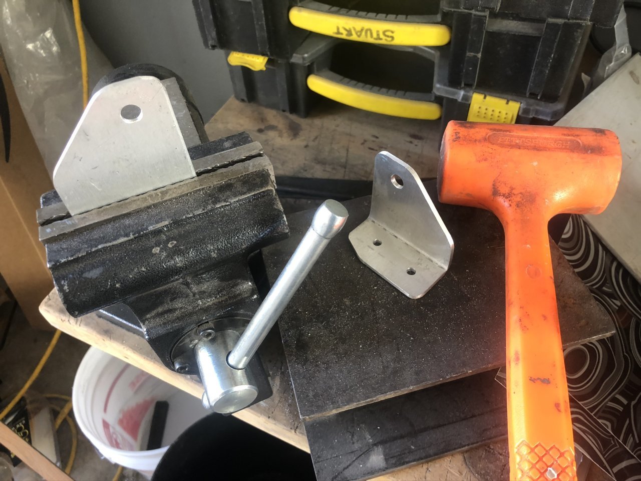

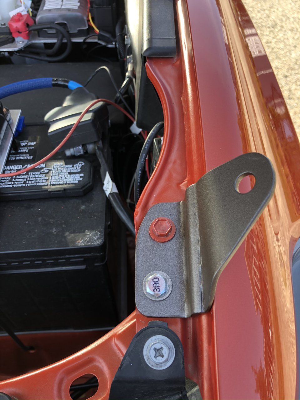

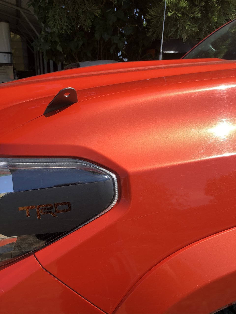

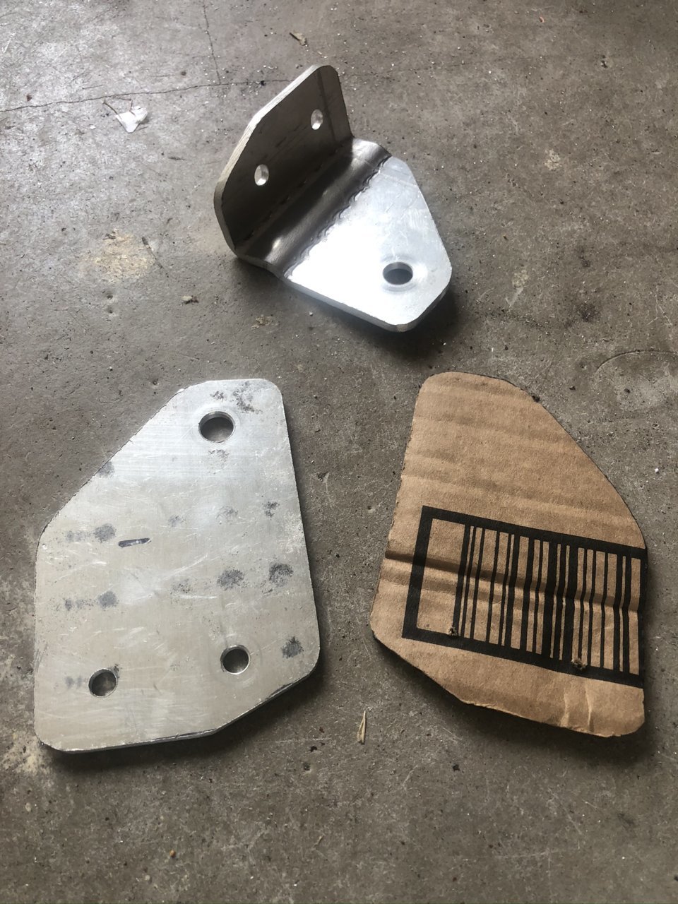

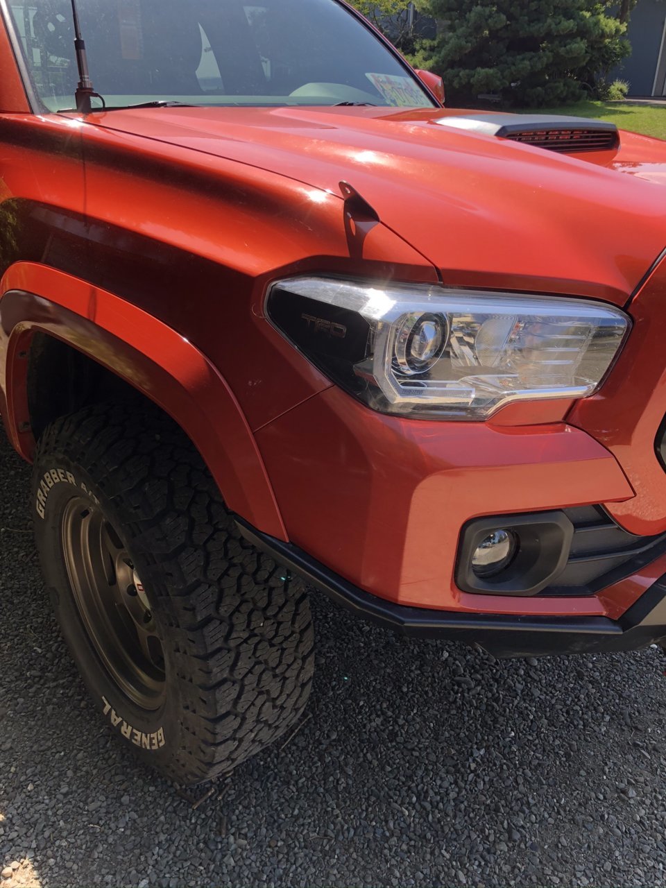

    I’m planning to make some mounting points for cables that the Jeep guys use. Limb risers is what they call them. The first step was to make some brackets that squeeze in the gap between the hood and the fenders.
    I ended up trying two times to make them from aluminum, but in the end pounded them out of steel with the help of two Mapp gas torches to get the steel hot enough to bend.
    Happy with how they came out. They could be a hair thinner.
