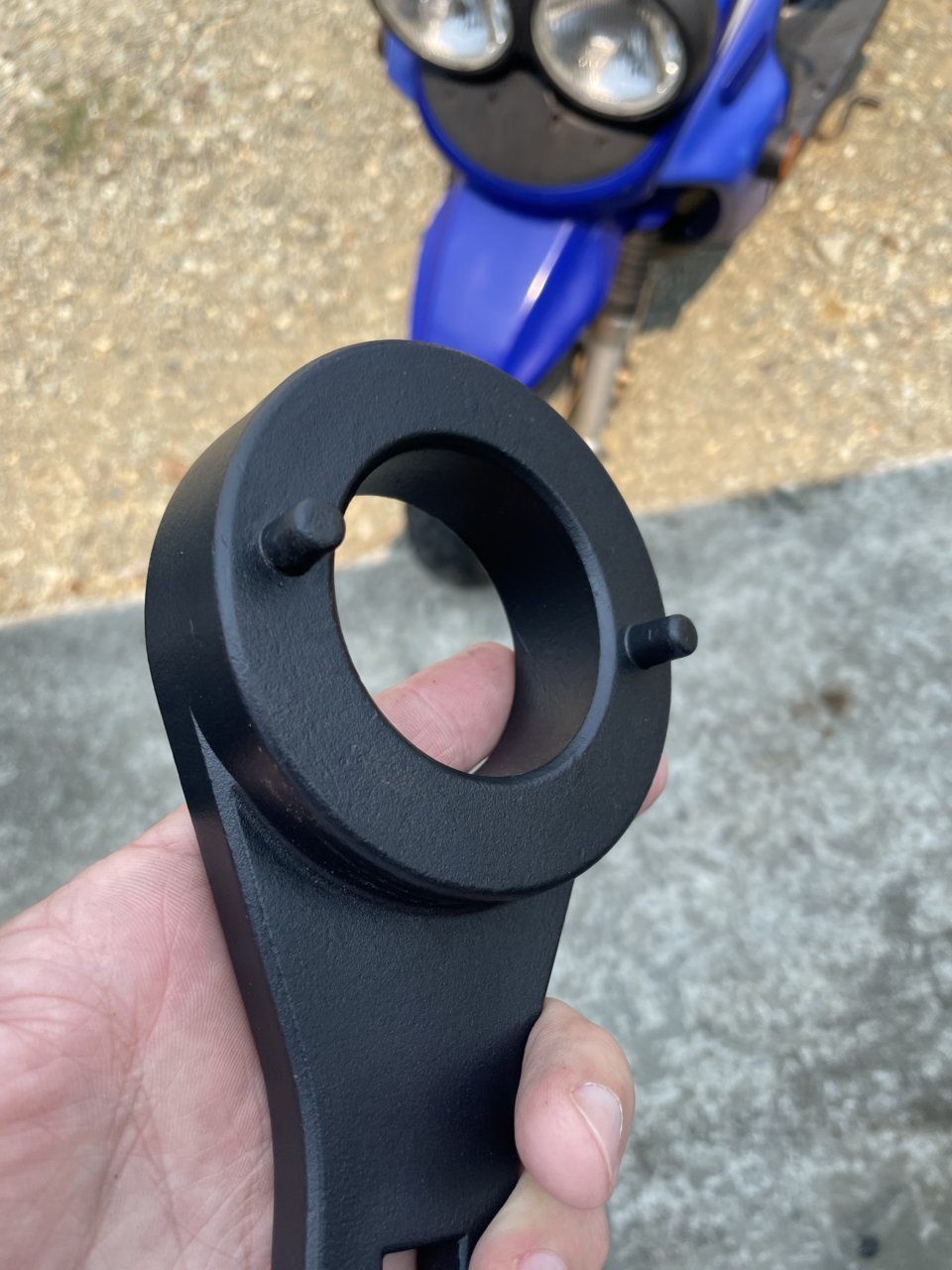

    This is the generic tool I bought. More than anything now I'm concerned about the durability of this tool. The pins are taking an awful lot of torque. I am now considering maybe I get the threaded version and use really good bolts to hold it. I don't want these pins getting broken off inside the pulley.
    I just watched a YouTube video where a guy used a huge cheater on his breaker bar and was significantly bending the bar. Getting worried now.

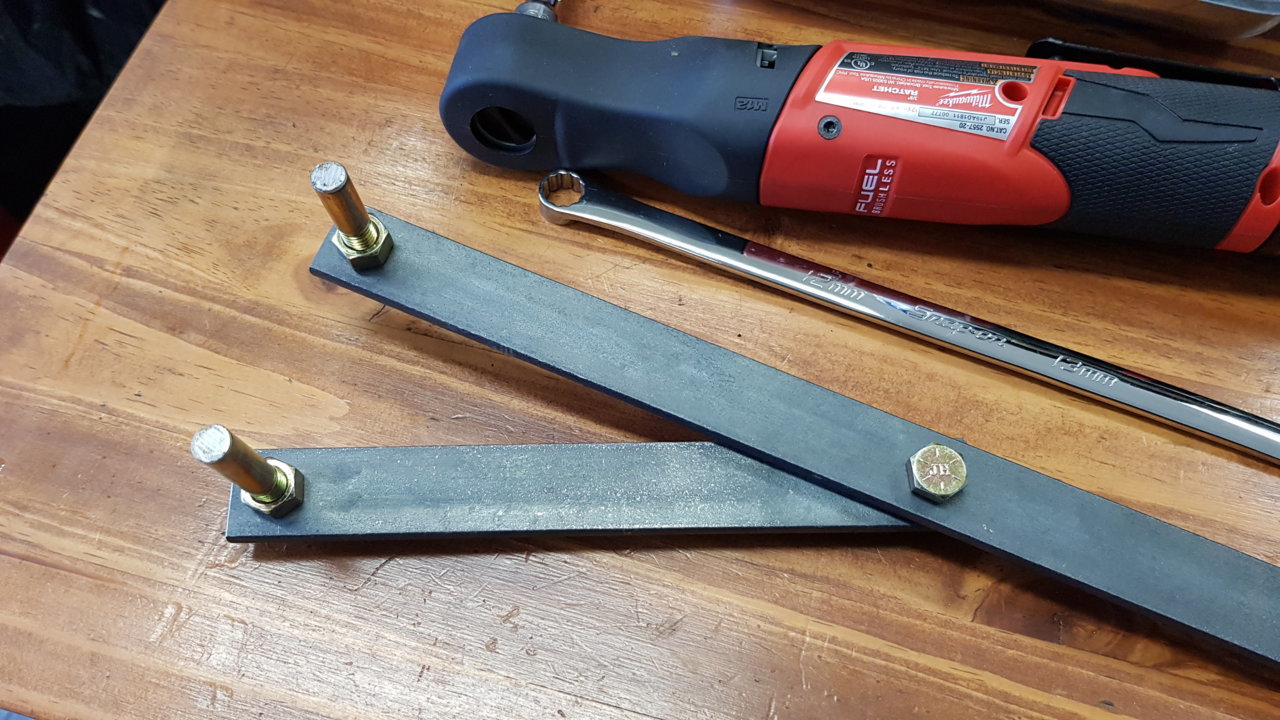

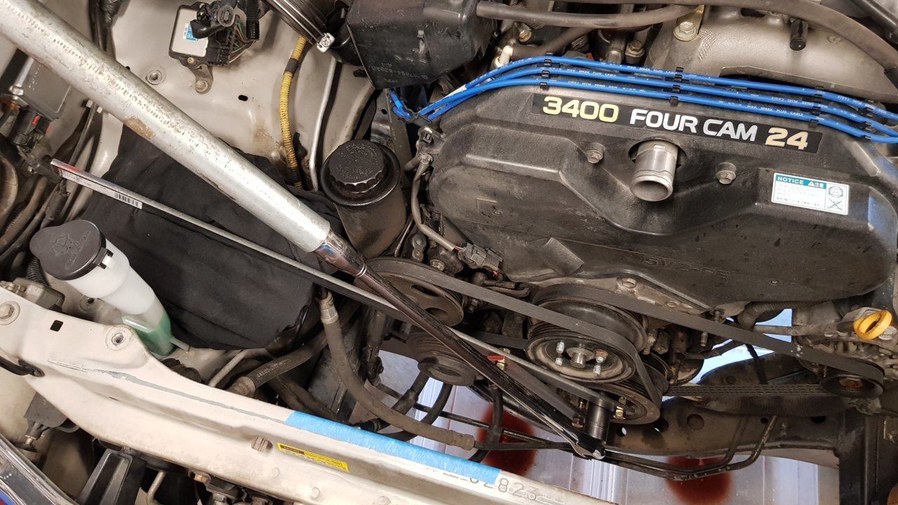

    Yeah that sucker was on tight. Neither of my cordless MW or IR air impacts would budge it. I wasn't about to put everything back together & order the $100 pulley tool. Went to the big box store, spent just under $15 & made my own tool.
    I didn't want to do the crank the starter trick, right after I made the tool I realized I would have needed it anyway if I wanted to torque the bolt back to spec. I used a cheater on my old trusty 24" Matco USA breaker bar to get it loose. That thing has never let me down yet.
    That bolt also took me a few tries to retorque. Had to do that from the bottom (broke it loose from the top) with my foot pushing against the frame.

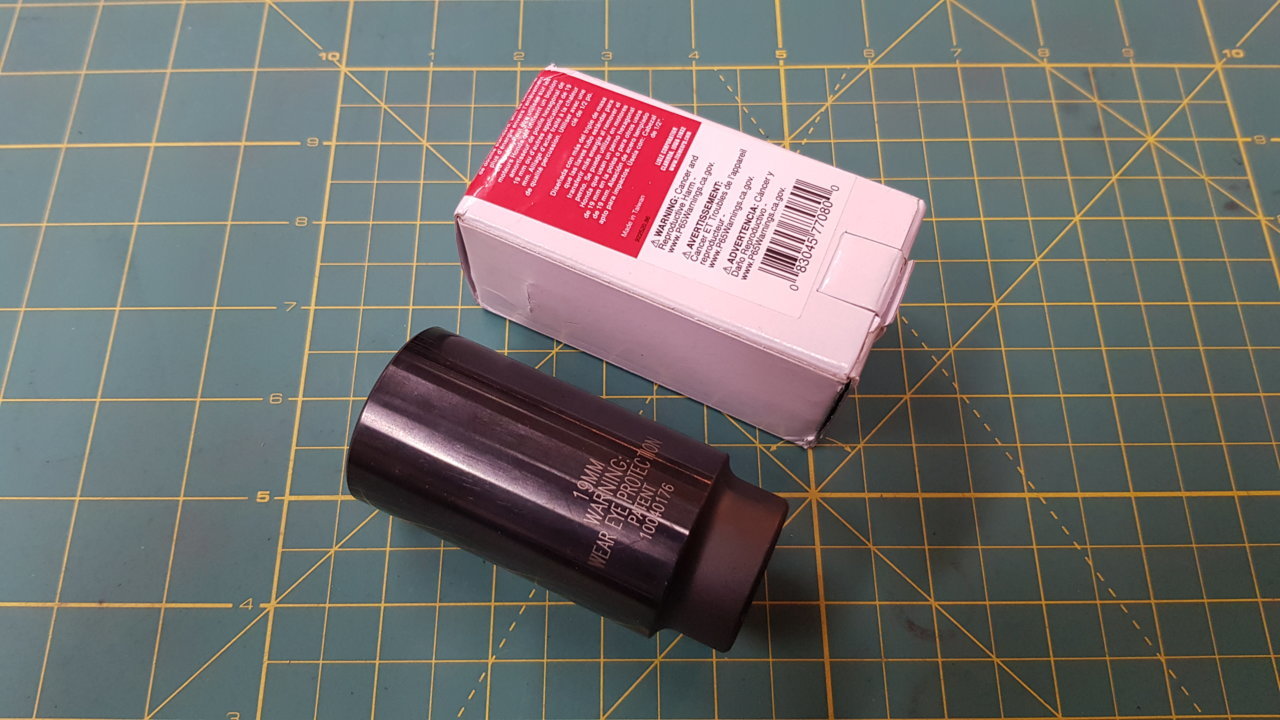

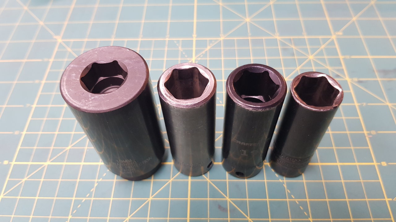

    And if that Earthquake still don't work & there's room for a deep socket, you can try one of these crank sockets.
    But you have the pulley tool. I would just put a cheater pipe on your breaker bar & pray your breaker bar doesn't snap the anvil.

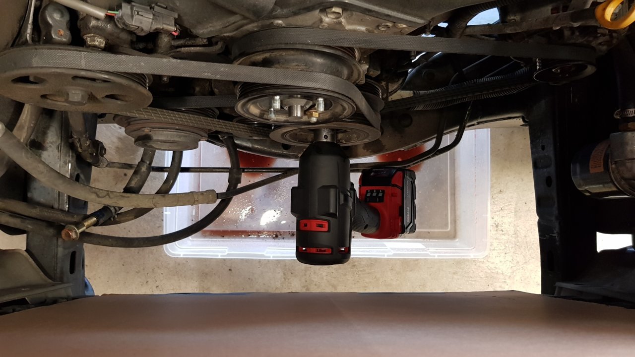

    So, I went to harbor freight and bought the $99 earthquake that advertises 700 ft lbs breakaway torque. Not quite as compact as the previous one I linked.
    It does nothing to this bolt. I was hoping, like somebody else said, that perhaps it would vibrate it a little bit looser so I could wrench it off. No luck yet.
