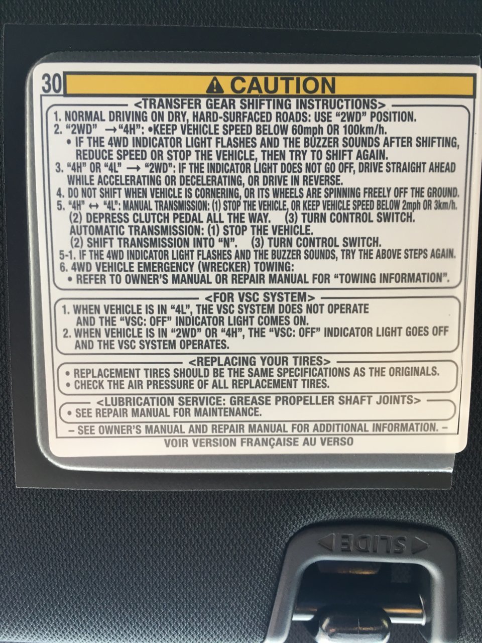

    Wow, how many times has it been said that the clutch must me fully depressed for manual and neutral for automatics. The sun visor card and owners manual says so, too. Anyway, glad the drama is over. Toyota is #1.

    Turns out, sometimes, to go from 4hi to 4lo, not only does the clutch have to be depressed, but you have to reclutch between. Or, in other words, you can't go from 2hi to 4lo (or vice versa) without releasing the clutch at least once.

    Well...if I was smart I would have read this before doing anything else. This clearly states that the clutch pedal needs to be depressed all the way (#5.2). Sorry for wasting everyone’s time. I had a Gen 1 4000 miles ago which was more crude and more basic, but definitely more straightforward...easier in many ways.

    I didn’t know you could still be moving (up to 2mph) with a MT and be able to switch between 4H to 4L. With an AT, you definitely can’t do that.

    When I've needed to get into 4Lo, being stopped has been reliable for me. Any motion just resulted in beeping. The threshold should be higher.
    You would think that something like neutral / clutch in and a 5 to 10mph would be just fine? Maybe with the added requirement of 0% throttle / right foot off of it completely?
