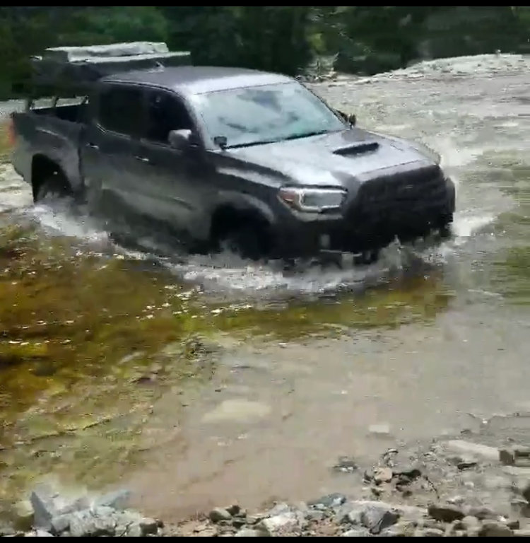

    I’m going to say no it wasn’t the rain....
    (Sorry had to grab the photo from the video of me crossing.)
