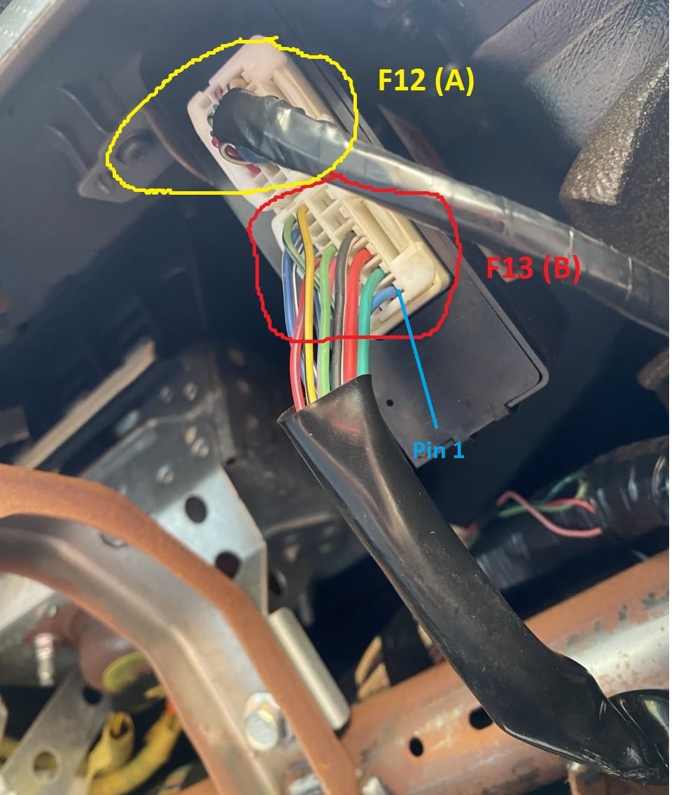

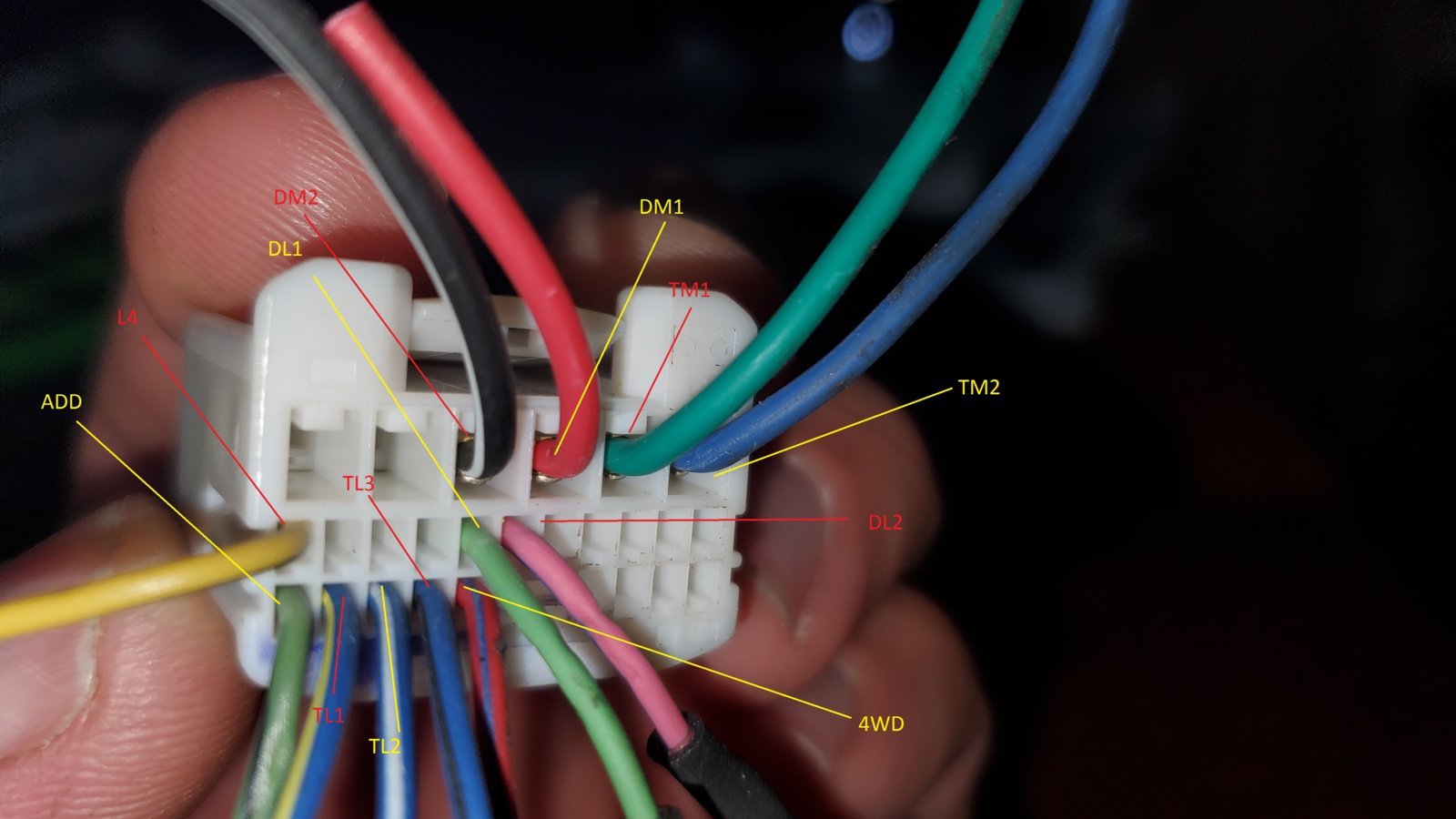

    There are two plugs that plug into the ECU is there a specific one I should test?
  13. Dec 10, 2023 at 6:27 PM
    Dm93
    Dm93 Test Don't Guess
    Mar 3, 2015
    #150066
    13,764
    Texas
    2014 DC OR 6spd 4x4
    Predator tube steps, Ranch Hand grill guard, Magnaflow CatBack exhaust, Toyota tool box & bed mat, 2LO Module by @Up2NoGood, Rearview Compass/Temp Mirror, Tune by @JustDSM.
    All of the limit switch circuits except LO and 2-4 (don't really need to test these since your 4wd selector switch appears to be working) are on F13.
