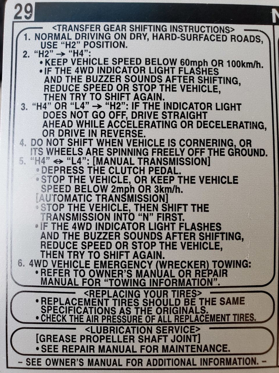

    Here's what my placard says, if you don't have one anymore. I'd look into it being the actuator or some other component giving up, and consider if the truck is worth investing repairs in.
