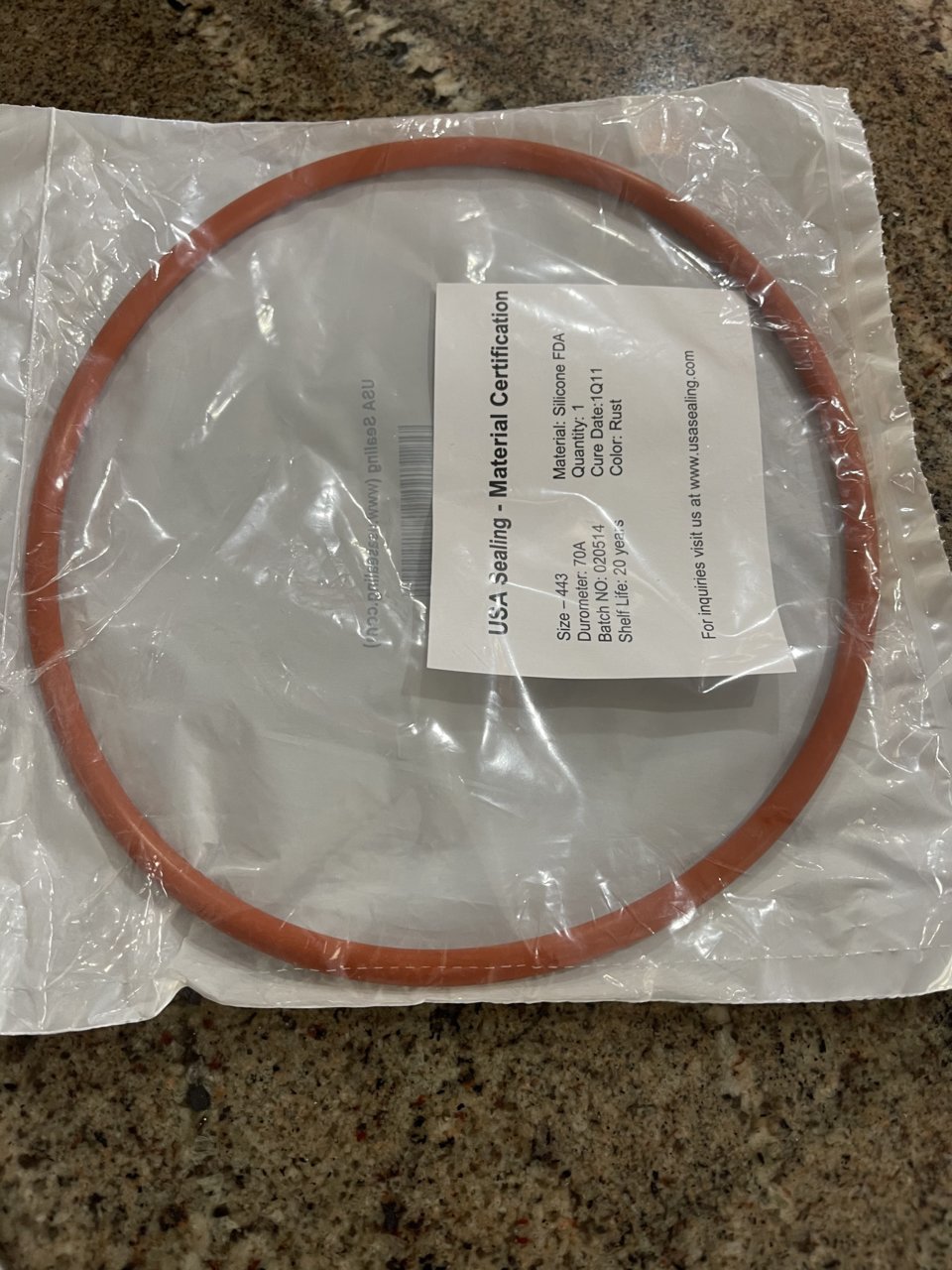

    So I ordered an Oring from McMaster. I ordered an 8" OD instead of a 8mm :D:rofl::frusty:
    Side note, red rubber grease seems to help a lot.
