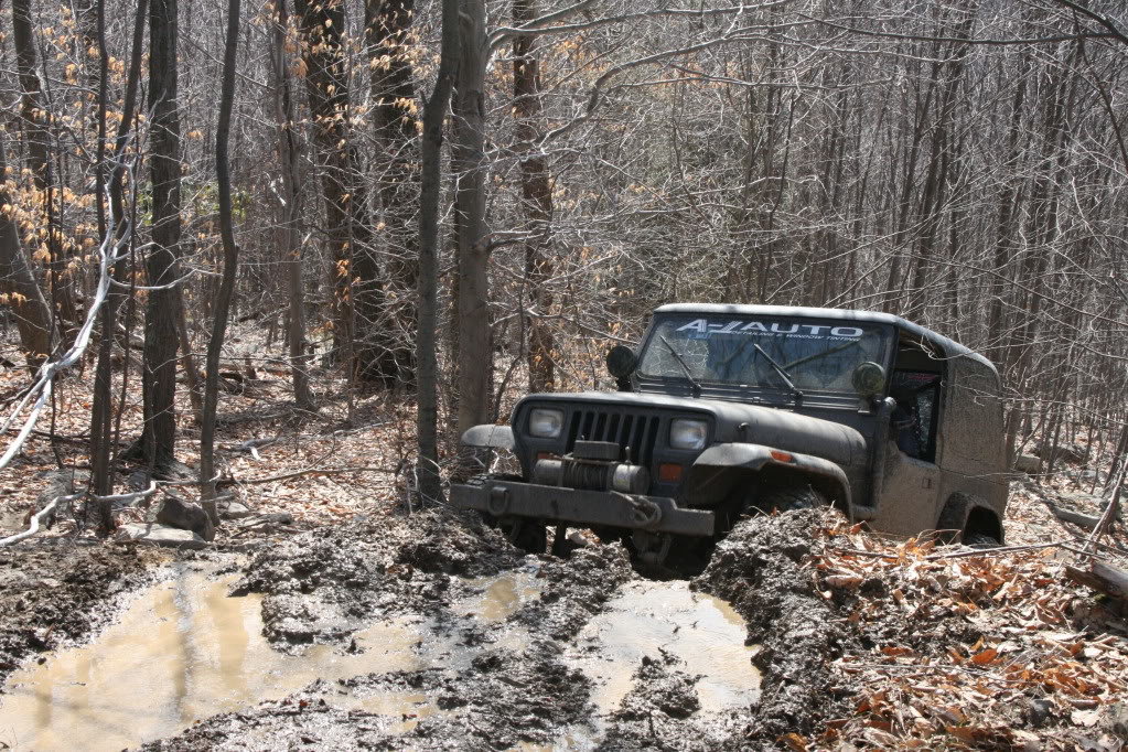

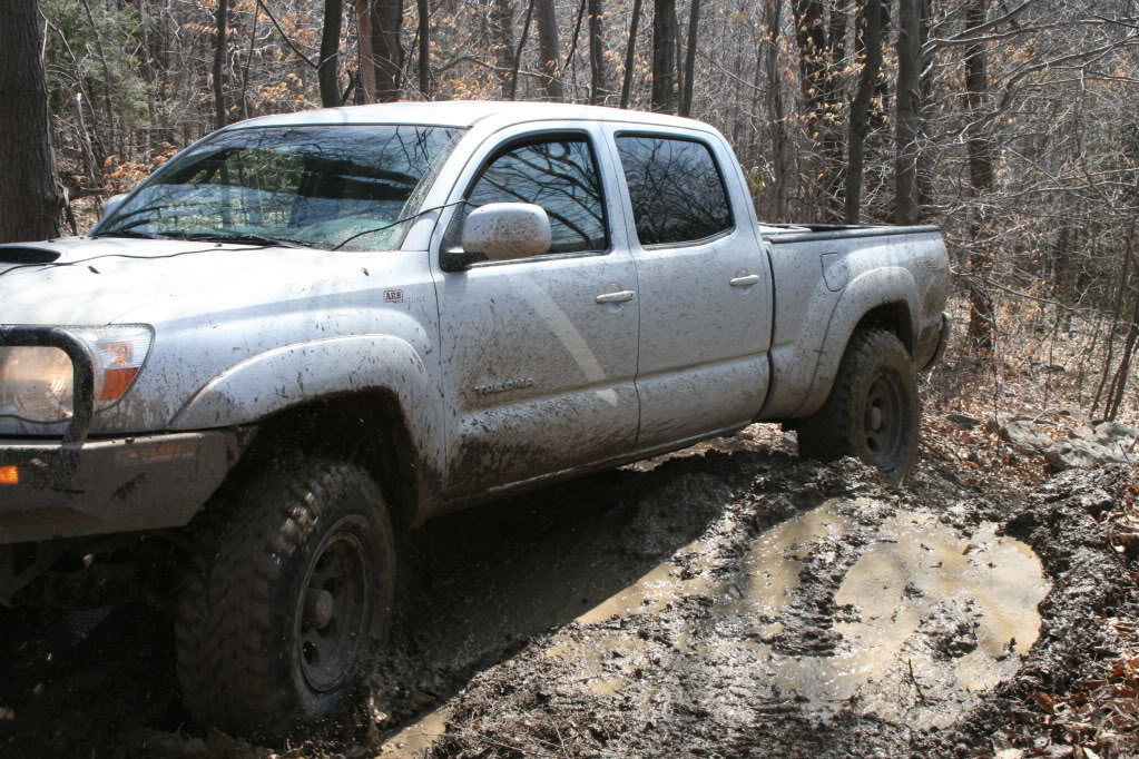

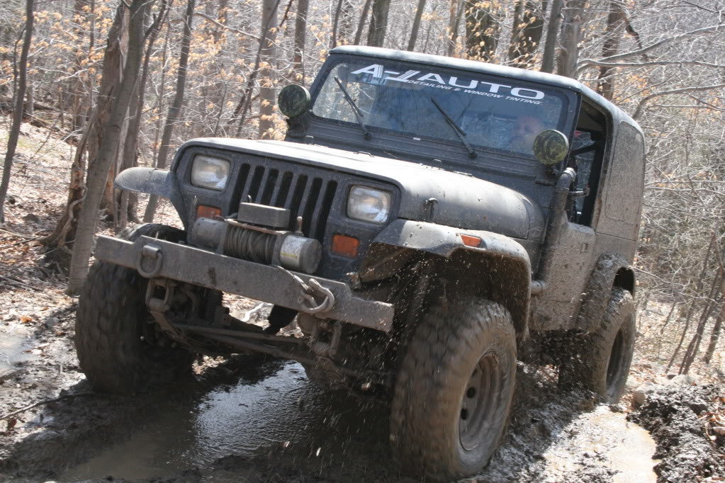

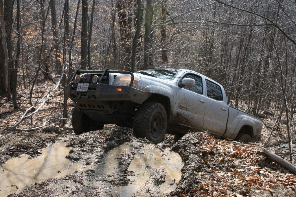

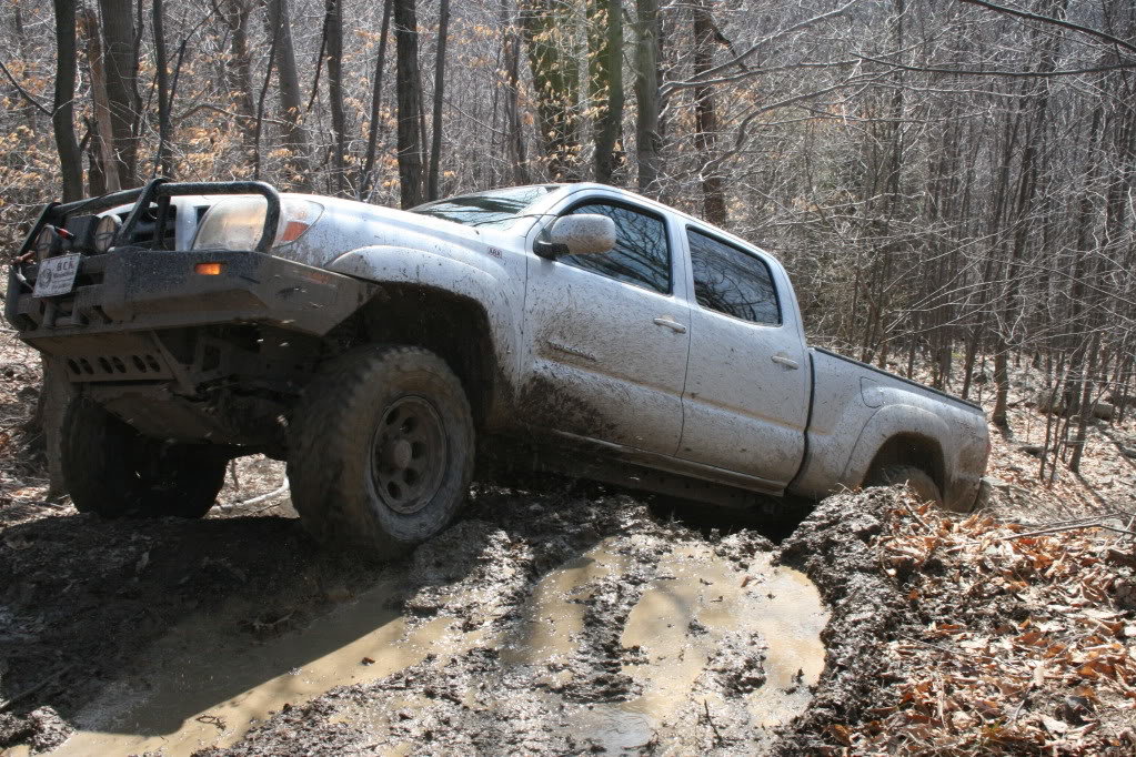

    I have 06 Db Cab 4x4 TRD Sport Long-bed automatic. I have always kept it in "D" while wheeling. I have put it in 4-LO to make it up a wet muddy hill a few times. Remember, Db Cab long-bed is only offered in automatic and the 06 only came with limited slip rear. No Locker! I must say that the limited slip has been an awesome set up. I know all these guys that have lockers and say "You'll never make it without a locker". That a bunch of BS! I have gone everywhere they have with the only exception of clearance issues because of the long wheel base. That and a few rocks that my front bumper would not clear.
    My Jeep friends were really amazed how well the Limited Slip works!
