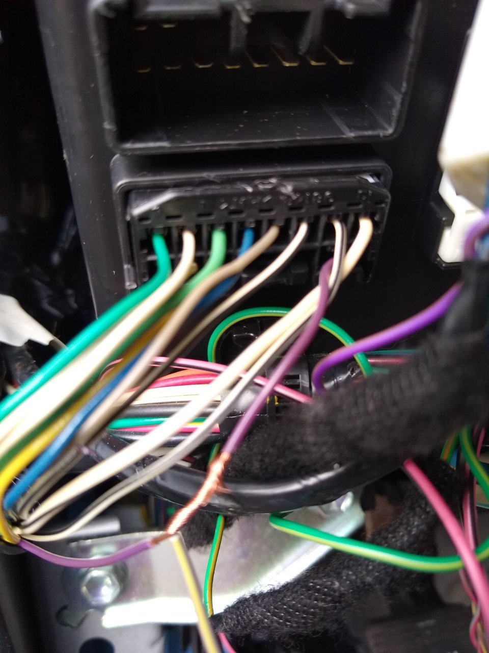

    Hi all. I have been trying to hook up this stupid vss wire in my 07 Tacoma . I am getting confused on where to install the wire. I'm aware it's at the ecm and something else beging coin tray. I have tried both locations and don't get anything on my head unit. When I connect to the black connector beging coin tray, I get p0500 error when I connect to ecm, I get weird lights on the dash. I can completely confused and frustrated. I have searched and searched, but can't really get an answer. Please help if you can. Thank you. I have an 07 base, access cab.

    Fixed it! It was the purple and white wire right behind the coin tray. I think my problem was the harness wire was connected to the vss wire of the radio, which went somewhere. I dunno. But I cut that wire and made direct connection from radio harness to plug behind coin tray. Worked perfectly. No more weird stuff going on. Thanks all for the replies

    i have a pioneer avic 8500. Originally, i had it hooked up with a regular metra kit and no vss wire. no maestro. no steering wheel controls. I then added steering wheel controls. (swapped out airbag and bought Chinese controls. To get the Steering wheel controls to work, i had to upgrade to the maestro RR and a T01 harness. hooked it all up , this time connecting the VSS wire from the radio harness to the Maestro harness. ( figured it may get speed info from OBD connector.) didn't work for me. i possibly could have had something mixed up as im not a radio guy, but i then tried piggybacking the VSS wire from the two areas mentioned, to the harness, but that created errors. i then chopped the vss wire in the harness so it would be a direct connection from plug behind coin tray to the radio harness's VSS wire. it worked instantly!
    yes the VSS wire is optional, but i definitely noticed an improvement in gps location. i think it reads my car speed with the gps speed and calculates better. i dont know if this is in fact true, but i do notice a slight improvement in the gps.

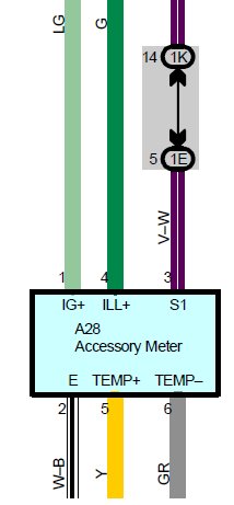

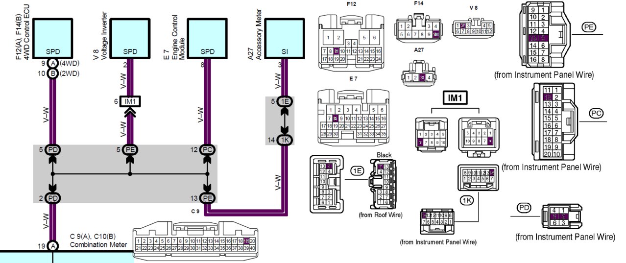

    So many locations to tap...

    ^^^^^ That is the best! thank you! im sure others will find this helpful as well. thanks for posting this diagram

    Your '07 didn't or doesn't have the overhead compass? Because you cut the feed for it.

    these diagrams are awesome. i cut the wire in the TO1 harness. id never cut wires in the trucks harness. sorry if i said that wrong
