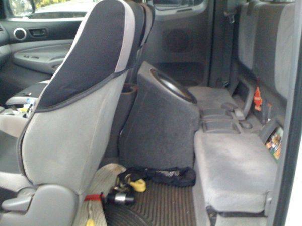

    heres the box I built for my 10" type-R Alpine. Sounds pretty decent for a 10, though I kinda wish I had a little more once in a while. I need to get a better amp though, so maybe that'll make a difference.

    Nice. That looks like a decent size box for a 10, nice job with the finish and sizing. Does that keep you from opening the back seats without removing the box?

    Thanks. It's a decent size(about .75 cu ft), but its actually a tad small for the type-R, but with a little polyfill inside I get away with it. Yeah, ive got to move it out of the way, but its easy. It just fits snugly so you can lift it up and out of the way. And I have quick disconnects for the wiring if I want it entirely out of the truck for some reason.:)
